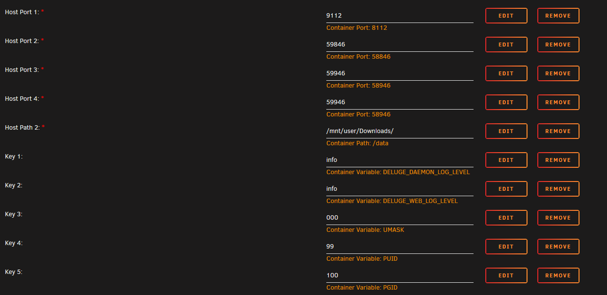

47 minutes ago, binhex said:
no you cant specify host paths inside the container, you need to specify the container path, edit the container and change the host path to /mnt/unassndisk/test/ for container path /data
then in deluge set incomplete to /data/downloads and completed to /data/completed
That worked!  Now I guess to get Sonarr working properly with it I need to change the sonarr path container path that reads
/mnt/user/Downloads/ to the same as what I have for deluge /mnt/disks/unassndisk/test/.
If I have more than one unassigned disk, will they be labeled unassigned disk1 and disk2?

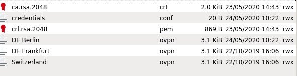

2020-05-19 21:04:43,589 DEBG 'start-script' stdout output:
[info] OpenVPN started
2020-05-19 21:04:43,595 DEBG 'start-script' stdout output:
[warn] OpenVPN process terminated, restarting OpenVPN...
2020-05-19 21:04:43,599 DEBG 'start-script' stdout output:
Tue May 19 21:04:43 2020 WARNING: file 'credentials.conf' is group or others accessible
Tue May 19 21:04:43 2020 OpenVPN 2.4.8 [git:makepkg/3976acda9bf10b5e+] x86_64-pc-linux-gnu [SSL (OpenSSL)] [LZO] [LZ4] [EPOLL] [PKCS11] [MH/PKTINFO] [AEAD] built on Jan 3 2020
Tue May 19 21:04:43 2020 library versions: OpenSSL 1.1.1f 31 Mar 2020, LZO 2.10
2020-05-19 21:04:43,600 DEBG 'start-script' stdout output:
Tue May 19 21:04:43 2020 Error reading username from Auth authfile: credentials.conf
Tue May 19 21:04:43 2020 Exiting due to fatal error
[info] OpenVPN restarted

14 hours ago, Sap1ent said:
I think it's related to the PIA VPN I'm using but can't be sure
it doesnt look like that, more likely permissions issue, do the following:-
1. stop the container
2. delete the file /config/perms.txt
3. start the container - note it may take a bit longer to start as it reset permissions.
if still no go after 5 mins of waiting then post log, follow this procedure:-
https://github.com/binhex/documentation/blob/master/docker/faq/help.md

How do I correct this?
A little more information about what's happening here:
Has anyone else experienced this? I'm not sure how to proceed.
EDIT: I was able to access the web UI on the regular version by changing my settings as follows:
I don't know if it will work properly with these settings though and changing the settings on the VPN docker to match this doesn't give me access to the web UI. If these settings are OK to use, where do I find my torrent info to copy from the VPN to the regular docker? I don't mind using the regular docker but I don't want to lose my torrents...
While looking for torrents I came across a file named deluge-web which might have some relevant info:
