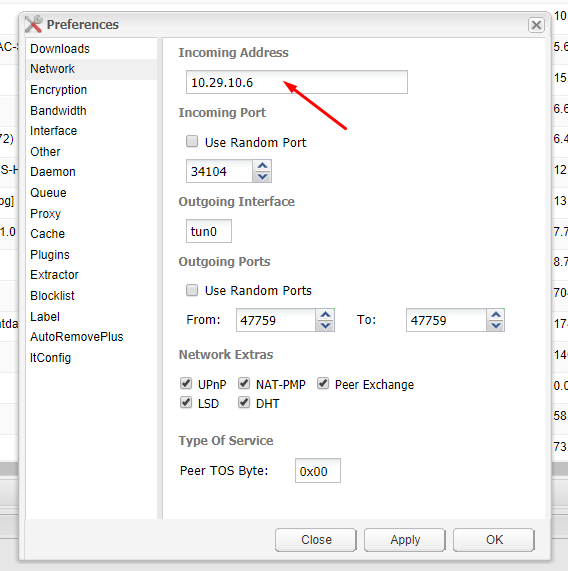

What should this be set to? It changes frequently, and only when i change it to my internal IP address do my speeds actually increase, but then it changes back after some time.
