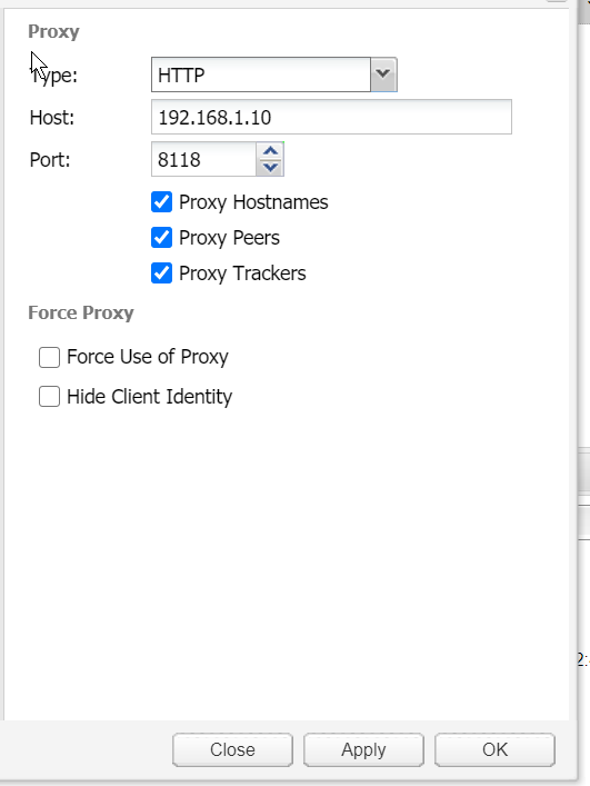

If I enter Proxy info into Deluge like here:
I can't download any trackers or anything it seems and downloads just sit there indefinitely.  Is there something else I need to do?
why are you trying to use a proxy when you already are using a vpn tunnel?, this does not make you any more secure and will cause issues.
Fair point!  And its definiately causing issues :D
I shall leave that empty; i just saw a proxy option and thought why not, I now know to.... not 👍
