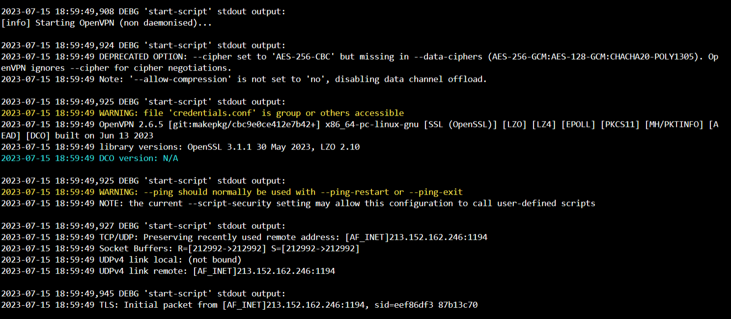

Hi All,
I've been using delugevpn for a long time now without issue and it's a great app. Suddenly though when I try and open the webUI all I get is "unable to connect". I've done a bit of searching around and tried a few things, but haven't been able to get it working again. I am a bit of a novice user, so would appreciate it if someone can point me in the right direction. I have noticed in the log a couple of errors - one relating to the credentials.conf file and one relating to ping. I have tried changing the .ovpn file which was one suggestion and has worked previously when I had issues, but this time to no avail.
47 minutes ago, The Gleamer said:
Hi All,
there is no error shown in that screenshot, please do the following:- https://github.com/binhex/documentation/blob/master/docker/faq/help.md
