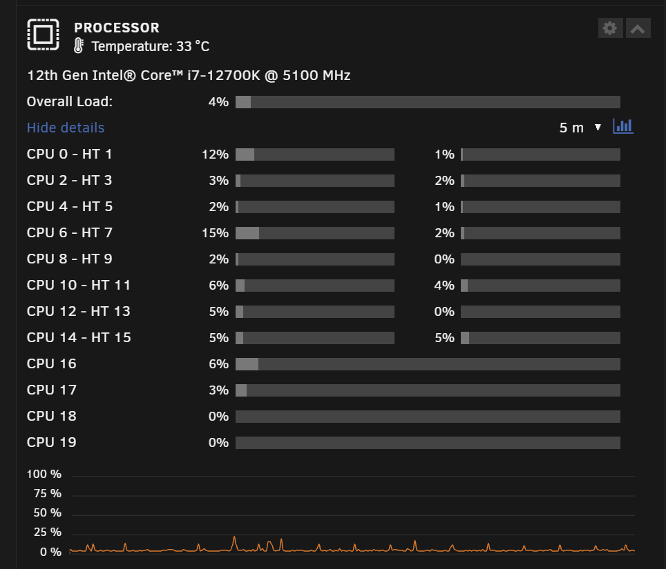

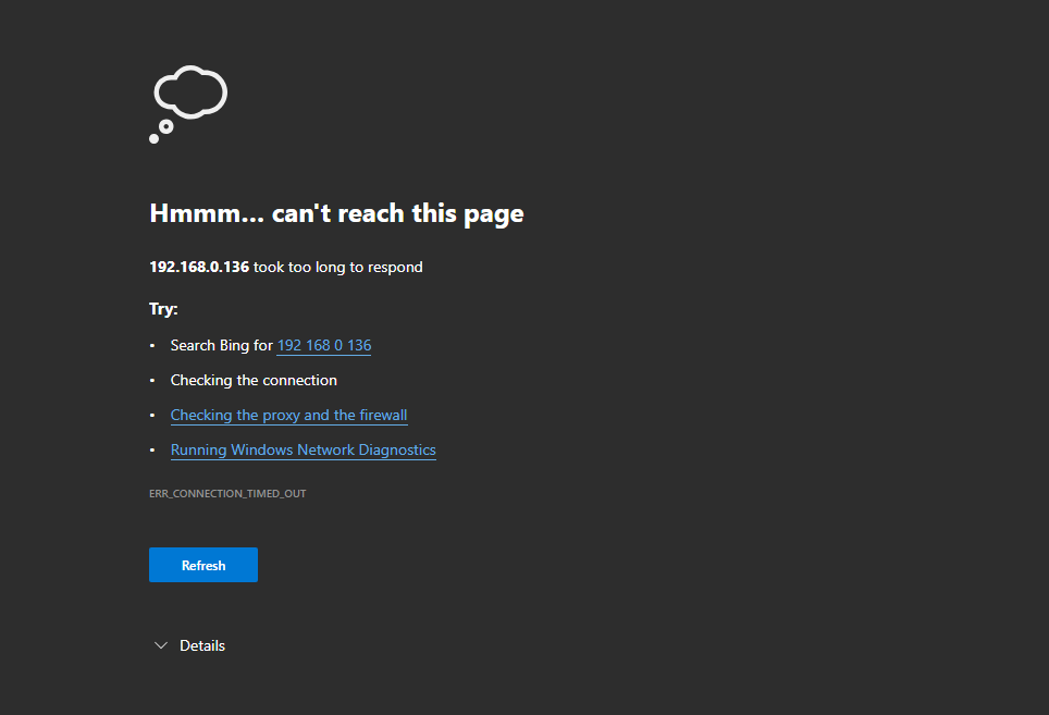

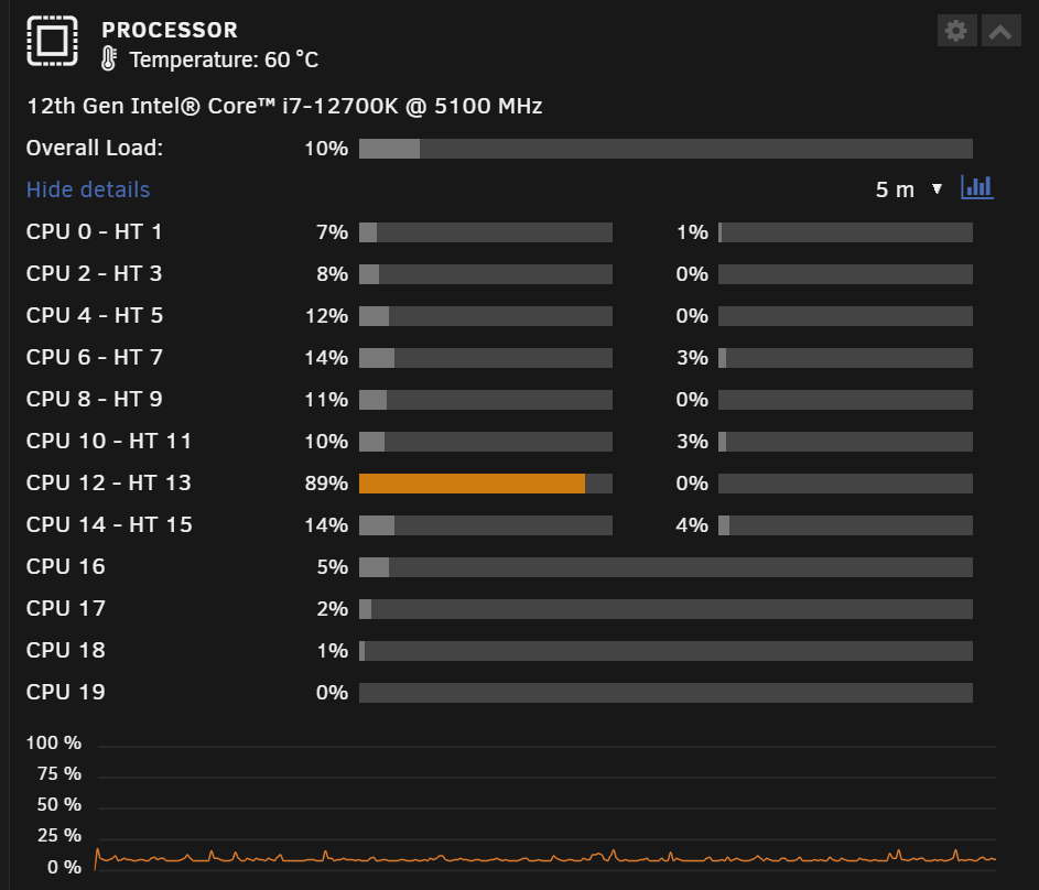

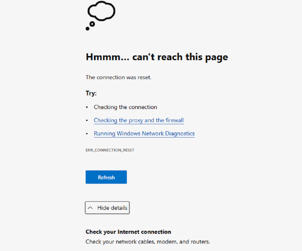

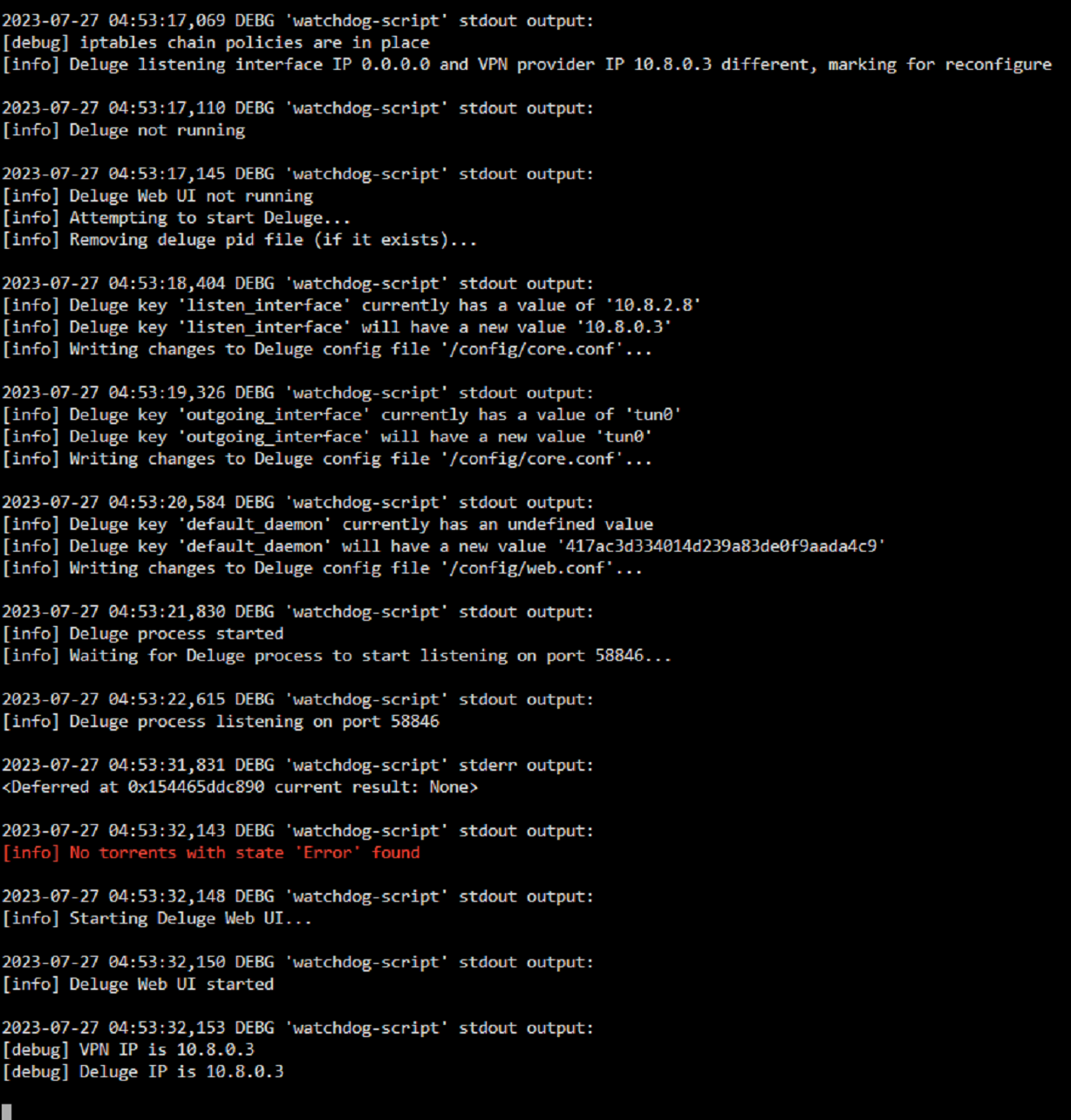

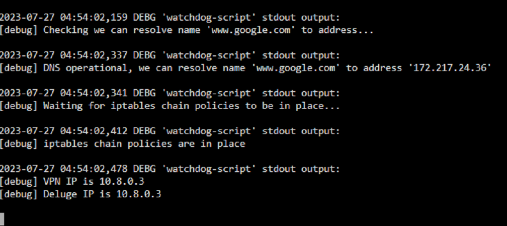

I hope someone can provide some guidance on this issue which came up recently since upgrading to 6.12.2 my deluge client has just stopped loading for some reason.
The docker loads up and shows everything as all good but unable to load the web UI at all,
What info can I supply or any suggestions on how to fix?
I can ping,
VPN connects and has IP
I have re-downloaded and removed the old appdata folder but but same results,
I can ping,
Do this: https://github.com/binhex/documentation/blob/master/docker/faq/help.md
Also what network type do you use? And are you using VLAN?

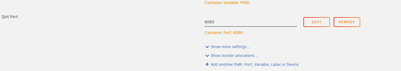

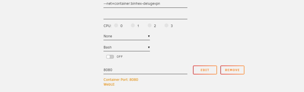

Hi, anyone here can help me? I got delugevpn installed and --net=container in qbittorrent. All is well but i cant access Qbittorrent webgui.
I am having an issue with Deluge. Upon a fresh reboot or array restart Deluge pings one core above 80% utilization, it jumps between core 0 and 12 but one of them will always be above 80%. If I stop the docker and restart it after, it corrects the issue. The first two pictures show the utilization prior to the docker being restarted, the third picture is after the docker restarts. Restarting the docker also brings down the CPU temps.
Is there a way to correct this issue so i do not have to manually reboot the docker at every restart?

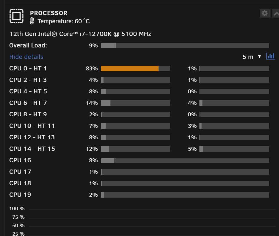

I'm having the same issue, except restarting the container doesn't fix it, it eventually comes back chewing up core8 at 100%
To add a bit more info i ran HTOP and it says its there are two processes, one sleeping, one running, both are  /user/bin python /user/bin/deluged -c /config -L info -l /config/deluged.log
I'm on a 13700k so i have plenty of other cores but still wondering what its doing.  I'm still running 6.11.5
I've tested this a few times for me, upon reboot or restarting the array I will have a single core almost maxed, but after stopping deluge and restarting all cores will have normal utilization
