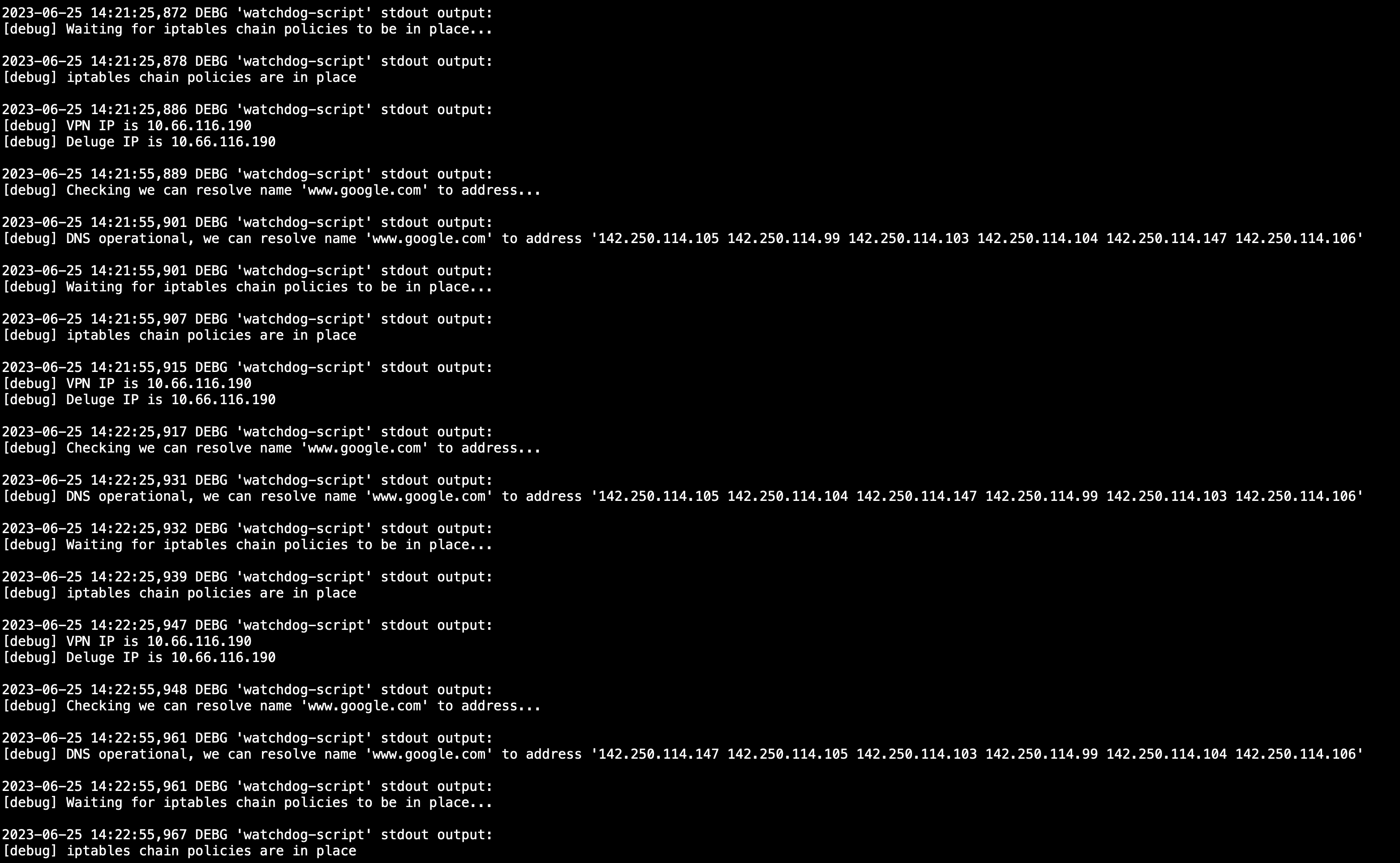

Having issues with writes to cache every 30 seconds for 10 seconds at a time, speeds range from 100KB/s to 1.1MB/s writes.
Issue mirrors what I had with Plex but that was fixed with --no-healthcheck in Extra Parameters. I've done so in the DelugeVPN container but it's maintaining those writes to chache.
If this is normal just let me know and I'll be on my merry way. If there's any other logs or plugins to install and monitor you need to reference, let me know.
Server Info: I am on 6.12.0 stable, issue has followed me from 6.11. Cache drive was in BTFRS, reformatted to ZFS. Deluge is the only container running. VPN is through Mullvad via Wireguard. I've included a screenshot of a snippet of log info.

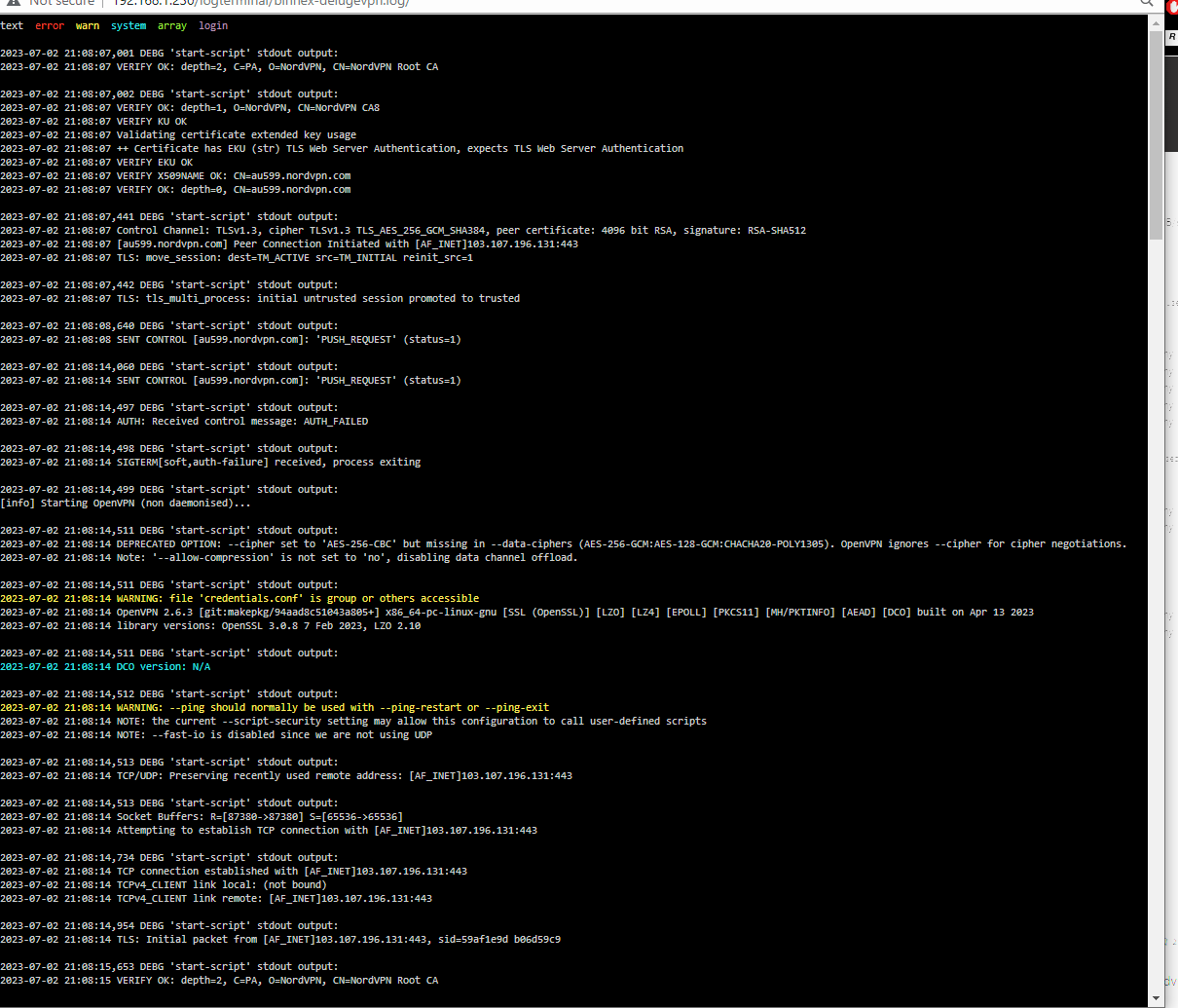

So I saw this, and thought this was the answer to my question, but its still not opening the GUI. I do have a question about the Credentials.conf file. Do I need to change that to the new NordVPN service credentials? I've changed it under edit in Unraid, and I even trying replacing my username/password with the new credentials, but something in the docker keeps overwriting the credentials.conf file with my real username and password. Is this correct behavior? Is it translating the service credentials into the real credentials? I think its running, but I'm unable to view it. I also did update to the latest update, but hadn't rebooted. I was reading back a few pages and saw the update could have caused issues. Ive since downgraded and rebooted, but no luck, I'm still unable to view the GUI. Do I need to delete the docker and re set it up?  Thoughts?
So even though I am using the Service Credentials as mentioned above, I'm still receiving the
SIGTERM[soft,auth-failure] received, process exiting
and when I look in the credentials.conf file, its using my real credentials instead of the service credentials I have listed under Edit for the docker. Where is it pulling these credentials and how do I stop it from replacing the new service credentials I entered?
I've also tried new OVPN files, both UDP and TCP. I've also been reading through the Help FAQ.
Thanks.

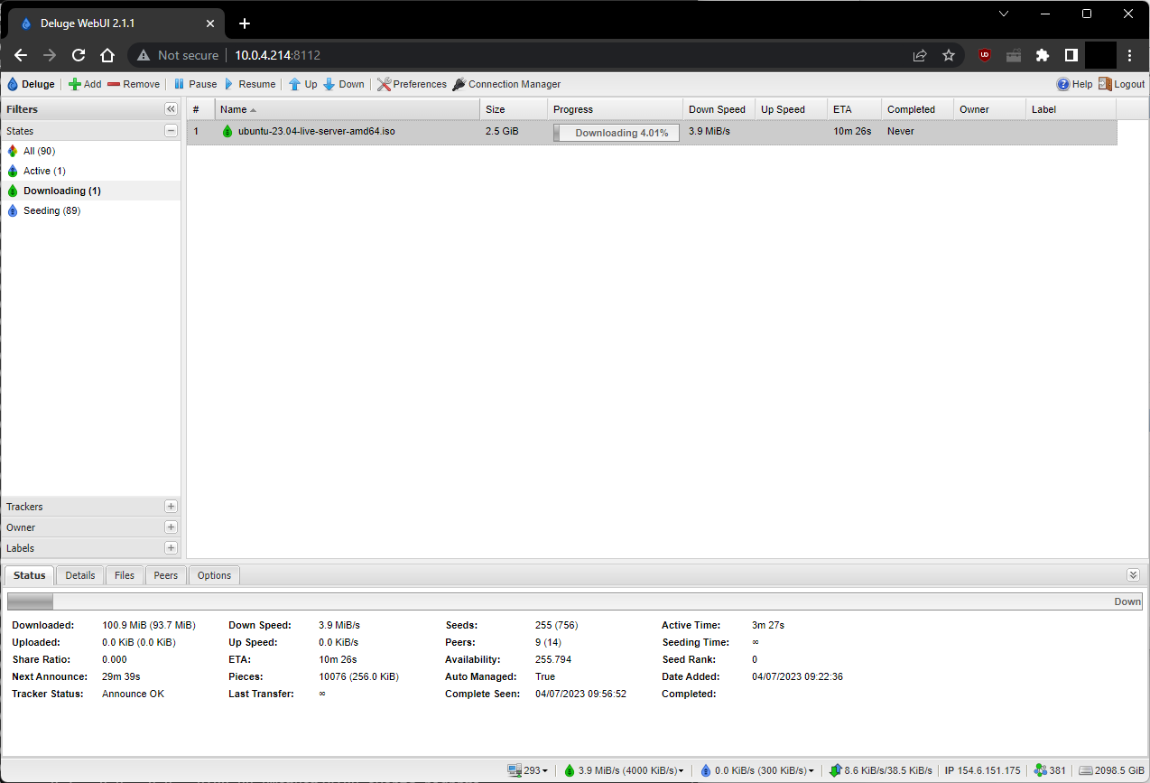

I seem to be having an issues with my deluge docker. I have had it setup and working for a while and it seems to have just stopped downloading. I have been looking through the logs and I don't see any indication or error, similar with my other dockers, they are able to send my requests to deluge and add the torrents.
When launching the delugeVPN docker, it seems to have a connection and established on over the VPN, but all the torrents just sits at 0.00%. Sometimes 2 torrents will get ~5 kb/s then back to 0. Almost like it doens't see the peers or cannot connect to them.
Has anyone see anything like this before? The closest thing I have found something related to the common ports of torrents be blocked via the provider. I have tried to switch some port around in the container and I also have some port worded on my router, to allow access. Any indications would help.

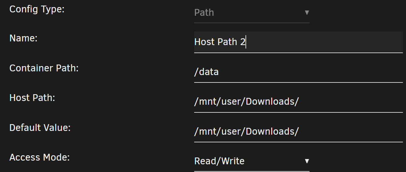

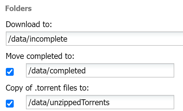

Can you post a screenshot of your container volume mappings and a screenshot of the downloads settings in deluge?

I had this exact issue recently, when I recreated my setup at a new host.
Considering I was using exactly the same configs, I eventually worked out that the only difference was the release of delugeVPN I was using.
I rolled back to release 2.1.1-1-02 and it's working for me, full speed again.
Ok course, I have actually tried to reinstall the container as I was having issues. I have been using radarr (aka Movies) as a tester, until I have it corrected then just rinse and repeat to added back sonar/lidarr anyways.
Docker path parameter:
Downloads configuration:
The 3 folders indicated in the download configuration (incomplete & complete & unzippedTorrents) are created under the directory prior to, fairly standard stuff I think at least.

That looks good. Not sure what's causing your issue. But you should close the port on your router. When using a vpn you have to open up the port on the vpn side and not your router. You have to check with your vpn provider if they allow port forwarding and if so set that up. When you have set that up you put that port as the incoming port in deluge.

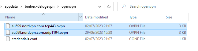

Hello can i please have some assistance my delugevpn has been working perfect with nordvpn for years, but recently getting the below within the deluge logs and delugevpn wont launch with VPN enabled, but if disabled it allows me to access the web interface.
i have tried several OVPN files, have rebooted unraid itself no change
you can see the current OVPN files i am using and the credentials.conf file within the OVPN path
recently updated to unraid 6.12.1 - originally was working
rolled back to 6.11.5 and restore appdata from a backup on same day i upgraded and still doing this
can someone please advice on how to fix this
if you need anything else let me know

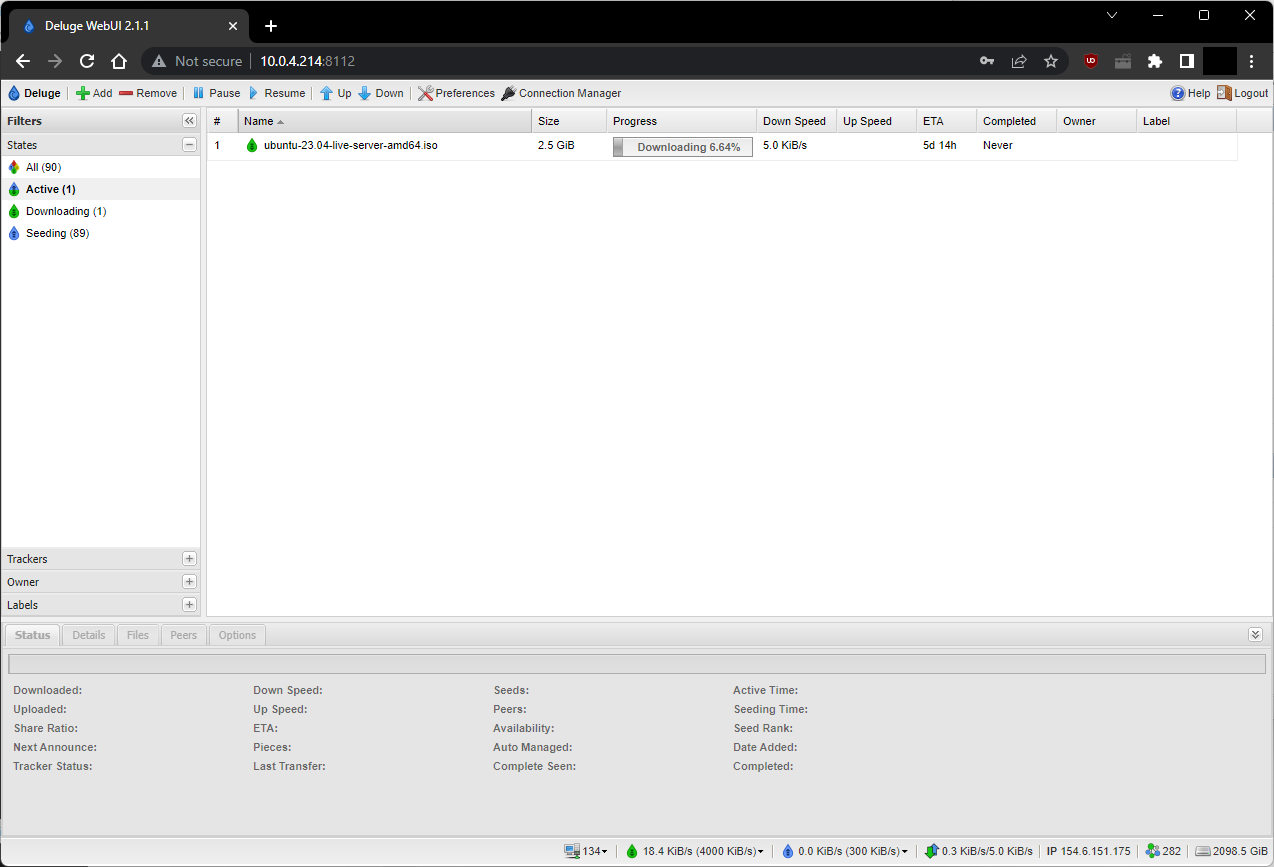

I've just started experiencing this yesterday. I thought it might be because I upgraded 6.9.1 to 6.12.2 but not entirely sure how that could happen. Essentially, peers get connected for about 3 seconds, and then disappear again. No logs at all.
EDIT: I'd remembered that after updating Unraid one of the downloads finished, and there was an error in moving it to the completed folder. On a hunch, I decided to delete all the Downloads/* folders (completed, incomplete etc etc) and stop/start deluge. Everything now working. Highly recommend doing this. Bit odd that there were no errors or anything coming through in the logs?
Edited by nitha

I copied across all the files from my old host to my new one (the data dir, the config dir, the shell script I used to start the docker instance), then ran the same shell script to start it up (see below)
It grabbed the latest docker image successfully and it all came up: the same torrents, the same configuration.
But it wouldn't download at more than 5k, and even that was sporadic.
Then i killed that docker instance, and reran the docker run command, but instead of just the bare image name, I specified the old 2.0.5 version and it worked fine.
Then I skipped forward through the release versions until it stopped working and went back one, so I have the most recent version that works for me:

I'm prepared to believe this is a ovpn config issue, but I've grabbed the latest files from PIA and compared it, there's no discernable change.
Edit to expand on this:
Version 2.1.1-1-02:
Version 2.1.1-4-01:
Edited by delugevpnuser
added images
