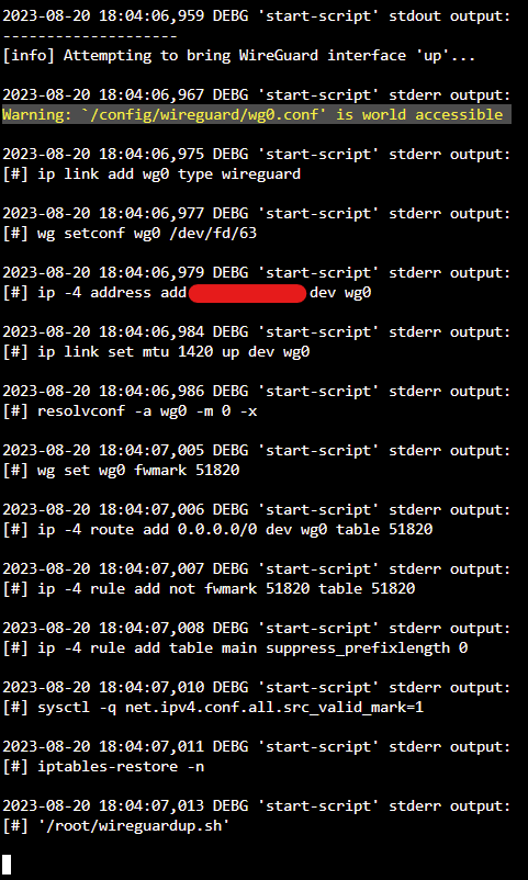

Hello together,
I'm trying to get it to work with WireGuard but don't know what to put in VPN_USER & VPN_PASS.
The WireGuard configuration of my provider I have stored as follows:
/config/wireguard/wg0.conf
I have adjusted the following setting:
Extra Parameters: --privileged=true (<- nothing else; as described in Q21: https://github.com/binhex/documentation/blob/master/docker/faq/vpn.md)
Container Path: /data/MYFOLDER
VPN_USER: ??????
VPN_PASS ??????
VPN_PROV: custom
VPN_CLIENT: wireguard
LAN_NETWORK: MY.LOCAL.NET.WORK/xx
At what point do I need the public and private key?
In the log I have the following messages (Attachment)
Would you be so kind and help me please.
Thank you!
Edited by AceBurn90

On 8/20/2023 at 6:11 PM, AceBurn90 said:
Hello together,
VPN_USER: ??????
VPN_PASS ??????
VPN_PROV: custom
Thank you!
Any idea how to solve my problem?
Could a log file help with troubleshooting? If so, which one do you need.
Have you tried leaving them blank? If you have the configuration file with keys in it it should work without having to put a username/password.
Sadly it dosn't work. Just tested it.
