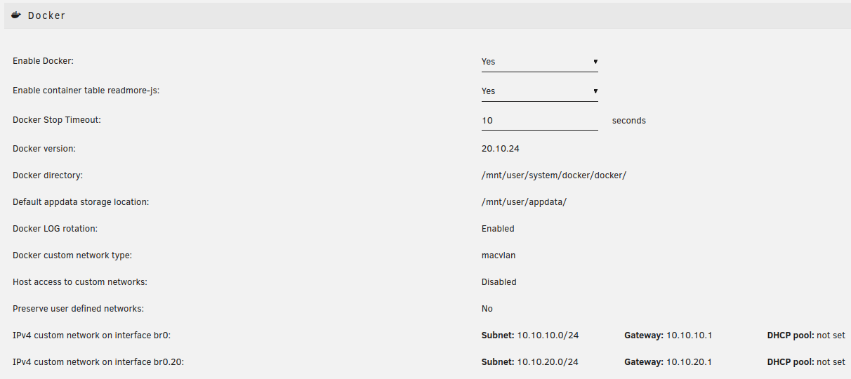

i am not quite clear on this, do you mean access the web ui of the other docker container from your lan or do you mean cross communication between docker containers in the same network? e.g. sonarr talking to deluge whilst both using delugevpn network?.

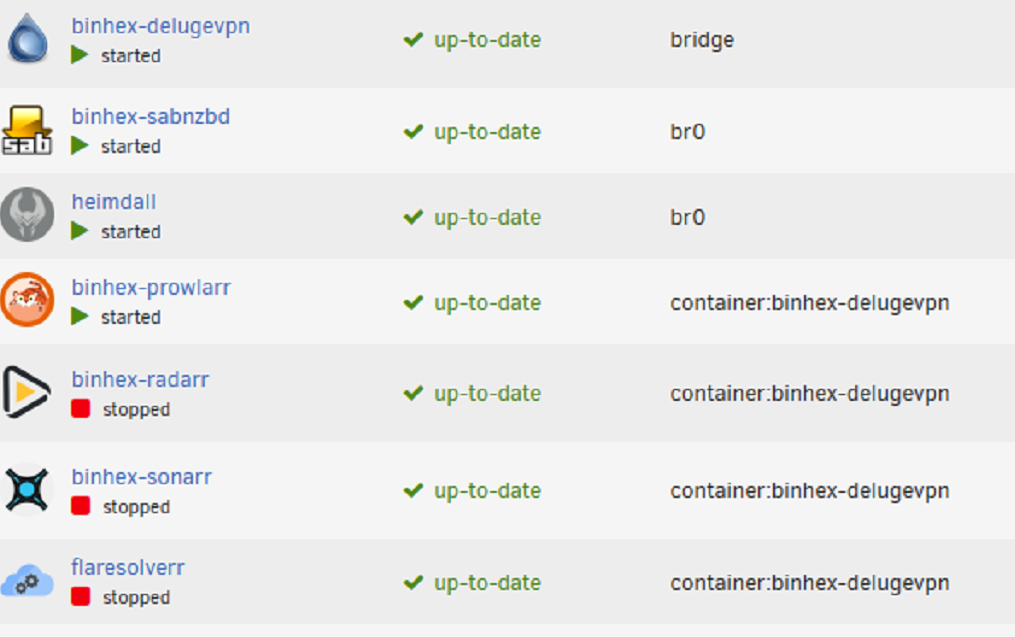

I have all my dockers routed via the VPN container using '--net=container:binhex-delugevpn' in the Extra Parameters of each of the other containers as below

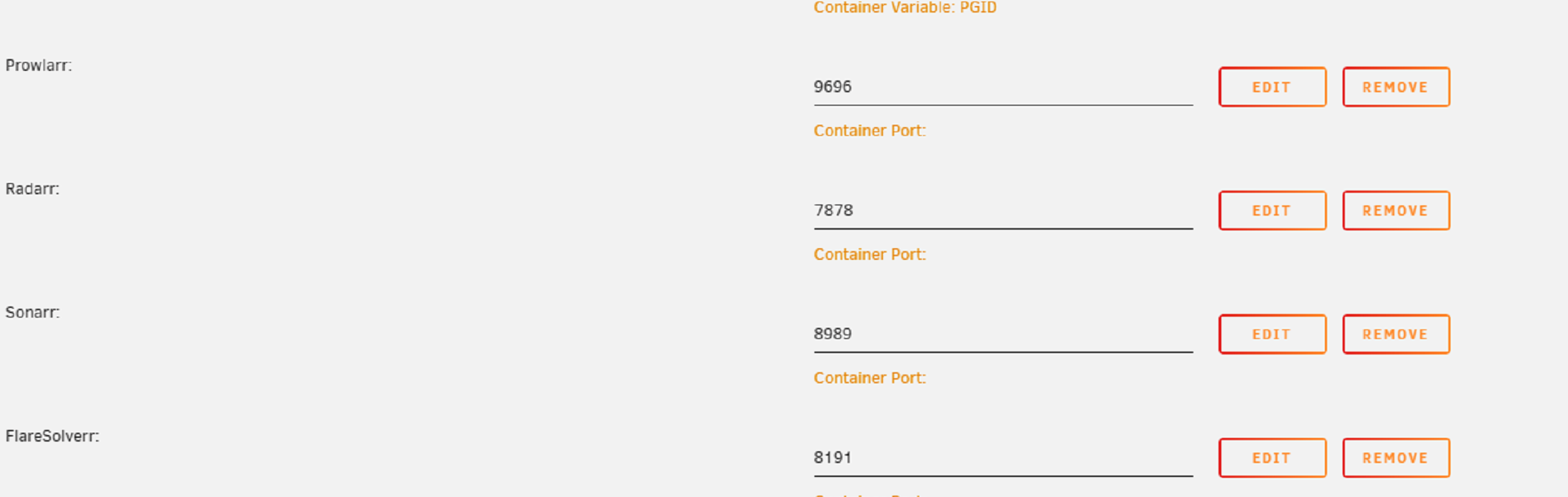

I have then added the container ports to the vpn docker as below
When running in bridged mode, deluge wont load but all the other containers work a treat. When bridge mode is enabled none of the docker ports seem to load and only deluge works at this point.

52 minutes ago, binhex said:
ok so you mean by 'load' you cannot access the web ui of the other containers running in the delugevpn network right?, if so see Q25:- https://github.com/binhex/documentation/blob/master/docker/faq/vpn.md
Ok it seems the delete port and the vpn port is new (odd how its still working on my older system with no issues hahah)
But it seems they are coming online and can be accessed.
Willl continue to test and advise if other issues arise, thanks @binhex

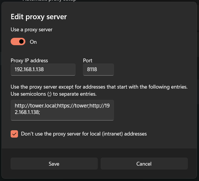

Port forwarding using DelugeVPN as a proxy server on Windows.
The proxy is working fine, and I can see that PIA is popping me out nicely in my preferred location.
What I'm struggling with is port forwarding from Windows, through this container and out to PIA.
I have the following set in the container config:
VPN_INPUT_PORTS: 8989,7878,9696,8191,52488,52489,2416
VPN_OUTPUT_PORTS: 52488,52489,2416
The ones in bold are the ones I am expecting to be passed through from the local machine and out to the VPN.
The others are what are there by default.
Here's my proxy settings:
However, the app I am using is reporting remotely that the ports are still closed.
Not sure what I've missed or am doing wrong.
Any help would be appreciated.
youre using the wrong container. Privoxy is a http proxy not a socks proxy.

Hey! I want to set up Deluge with ProtonVPN and have issues connecting to the WebUI.
I have already read the FAQ but couldn't find a suiting answer there, since there is no error logged anywhere.
Here are the only entries I changed from default when creating the container:
  • Host Path 2: Set to a path within another share
  • Key 4 (VPN_PROV): protonvpn
  • Key 5 (VPN_CLIENT): wireguard
  • Key 9 (LAN_NETWORK): 10.10.10.0/24
  • Key 16 (DEBUG): true
The WireGuard configuration obtained from ProtonVPN was placed in /mnt/user/appdata/binhex-delugevpn/wireguard/wg0.conf
I was able to confirm that the VPN-connection works by using 'curl ifconfig.io' from within the container, which shows the VPN-IP-Address.
However, when connecting to the WebUI, Firefox just displays: “Unable to connect”.
I suspect that the issue has to do with the interaction between the iptables ruleset and my network setup, since I am able to connect to the WebUI when VPN_ENABLED is set to false (which disables a lot of the iptables rules if I understand the log correctly).
Additionally, I am unable to access any other container I route through deluge (of course with the correct ports added to VPN_INPUT_PORTS).
Here is the log: supervisord.log

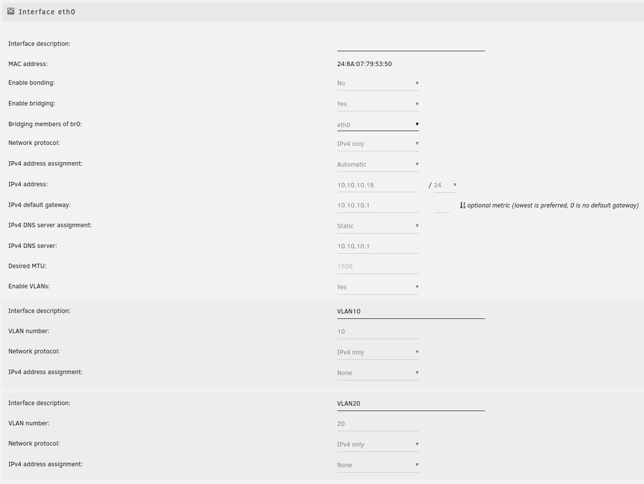

My network setup:
I have two VLANs (VLAN 10: 10.10.10.0/24 and VLAN 20: 10.10.20.0/24), although all machines relevant to my problem are inside VLAN 10. The computer I am trying to access the WebUI from has the IP 10.10.10.10 and Unraid has the IP 10.10.10.18. Here is the Unraid network and docker configuration:

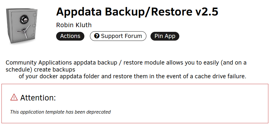

54 minutes ago, Corneloues said:
I think I've tinkered with one too many docker settings. Is there an easy way to restore without deleting and starting over?
You can restore if you have a backup, you have a backup right?, if not then for next time install the plugin from CA called 'Appdata Backup/Restore v2.5'. So if you don't have a backup (i kinda suspect this is the case) then your best bet is manually record what your current container settings are and then delete the container and re-create from a blank template.
Still learning - big lesson here! Installing the Appdata Backup app now. Luckily it's a CA Spotlight app for this month...
My issue was trying to use this DelugeVPN to route other apps through and needed to setup additional ports and that's where its all gone Pete Tong!
I've been prepared to kill and restore. As long as connect to existing folders, I can minimise the re-work.
FYI...
It's now called Appdata Backup - turns out I did have this one installed. Investigating...
