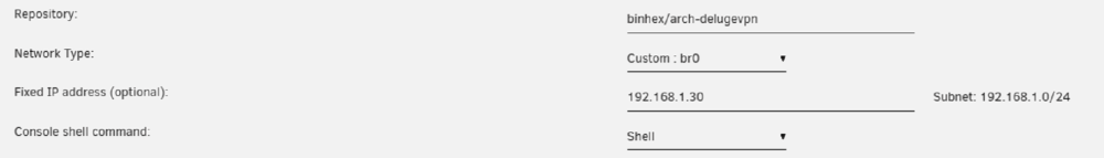

8 hours ago, brent3000 said:
192.168.1.63 and docker is 192.168.1.30 both on /24
that is most probably your issue, set the container back to 'bridge' network type and it will work.
Am I not able to have a different IP for the docker container? I have it on another IP on another system?
Edited by brent3000

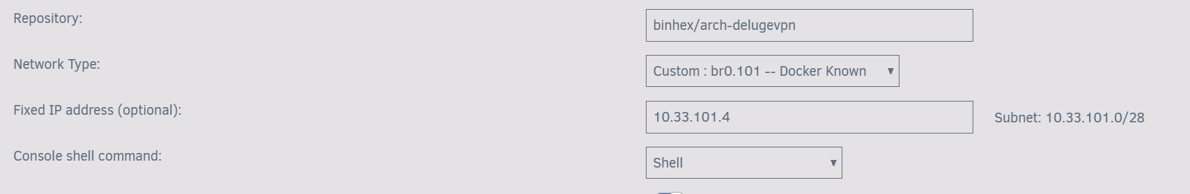

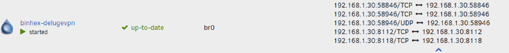

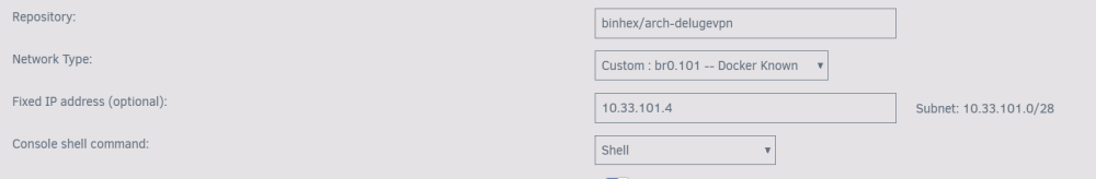

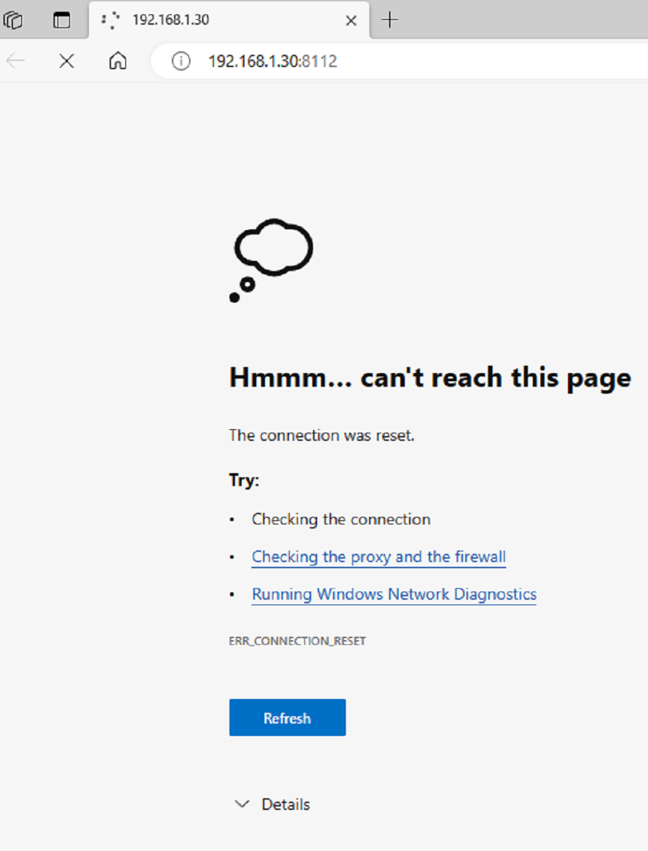

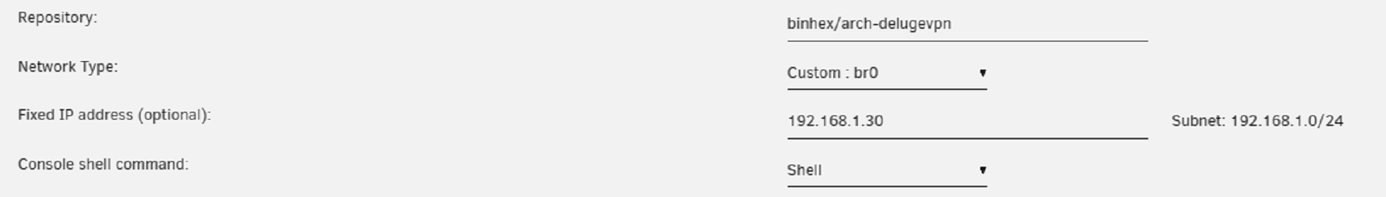

Ok so when i set it to 'Bridge' mode it works but when i try and set it to custom IP address it seems the error comes back, However i have the exact sane setup on another system (just that one has VLAN's this one dosnt) and it works a treat.
Screen from one which isnt working
This is from another box i have and its working fine
you can assign a fixed ip to the container BUT the custom bridge must be assigned a different network to your LAN, for example:

Switching to the default 'bridge' works, as this resets the docker network to 172.17.0.0/16 thus preventing the LAN_NETWORK clash and allowing iptables rules to work as designed.

Just now, brent3000 said:
Well that explains it well on why one works and one dosnt, is that a recent change? I swear this was working before at one stage.
nope, its been that way since day1, it was indeed designed that way as macvlan, ipvlan and custom bridges and all that guff wasn't even an option (in unraid) when this image was created.
