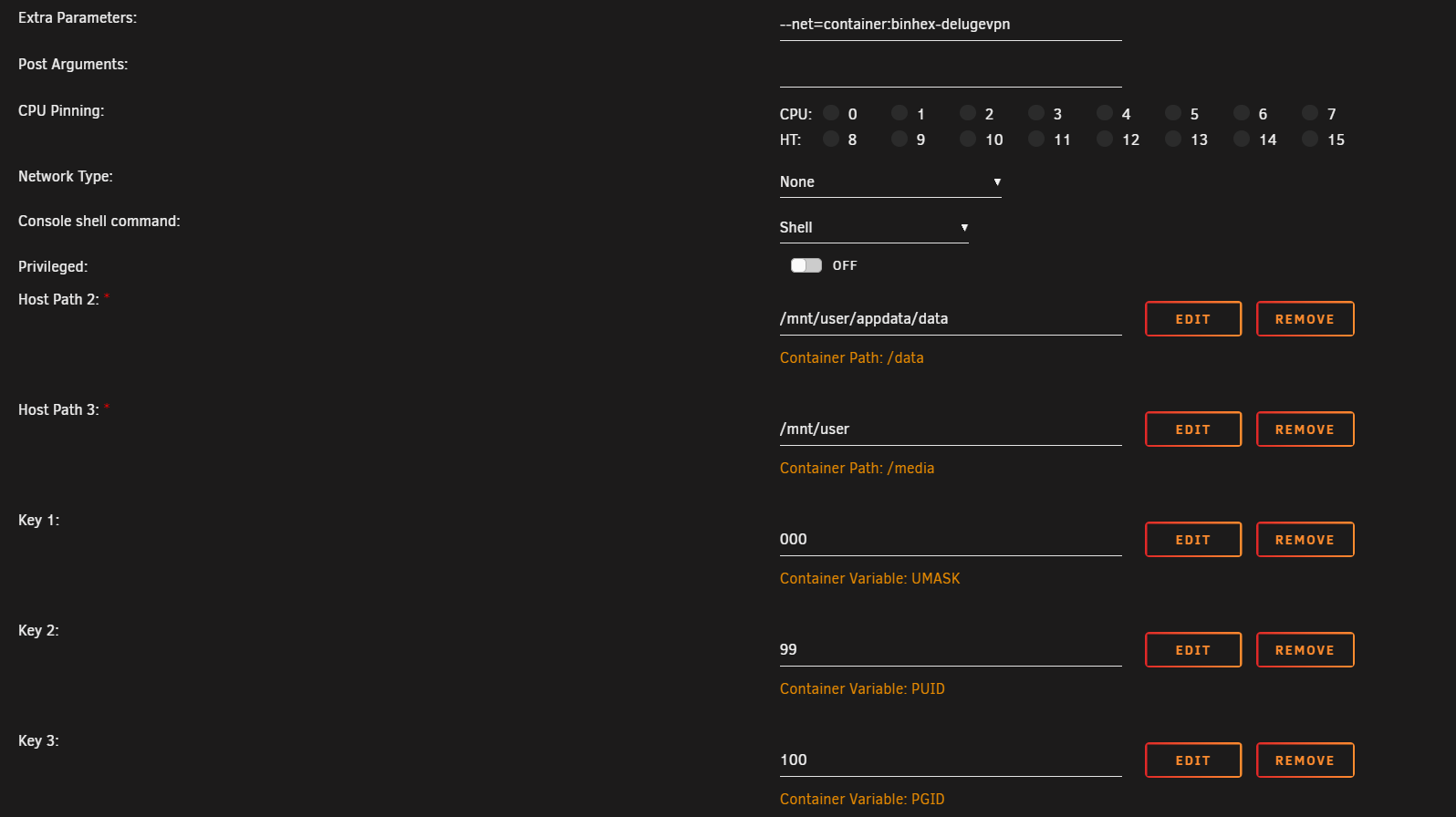

for some reason and for the life in me i cannot get Sonarr running on port 8989 via the VPN container
do you mean the web ui for sonarr is not accessible, or something else?
  • Replies 10.9k

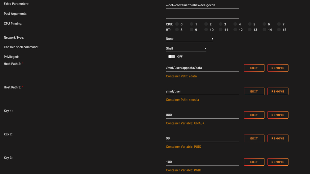

Correct, sorry. The webui isn't responding, whereas Radarr is. Docker img settings:
Post the screenshot of delugevpn config
