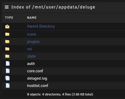

cat: /config/hostlist.conf: Permission denied
stop the container and delete /config/perms.txt then start the container, it will take longer to start but should then start correctly.
thanks! apparently I don't already have that file on the folder
your screenshot says otherwise!, post a new supervisord.log file.
I got it to work!
it turns out that /config/ was pointing to somewhere else and after deleting perms.txt it worked well
thanks for the patience!
