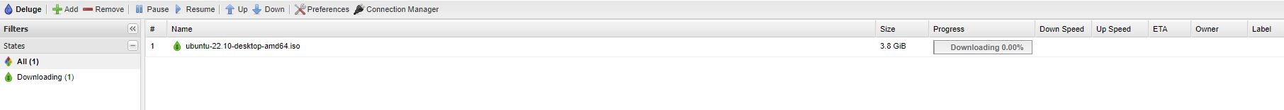

I installed and configured DelugeVPN as per the Space Invader one video.  I can access the WebUI of Deluge but I can't download anything.  I tried to download Ubuntu with the torrent file from the Unbuntu website to test my configuration.  The iso file appears in Deluge but it never start downloading.
I don't know what to do to get it working.  Please help!
Download location mapping in docker run compared to download location set in deluge would probably tell the tale.

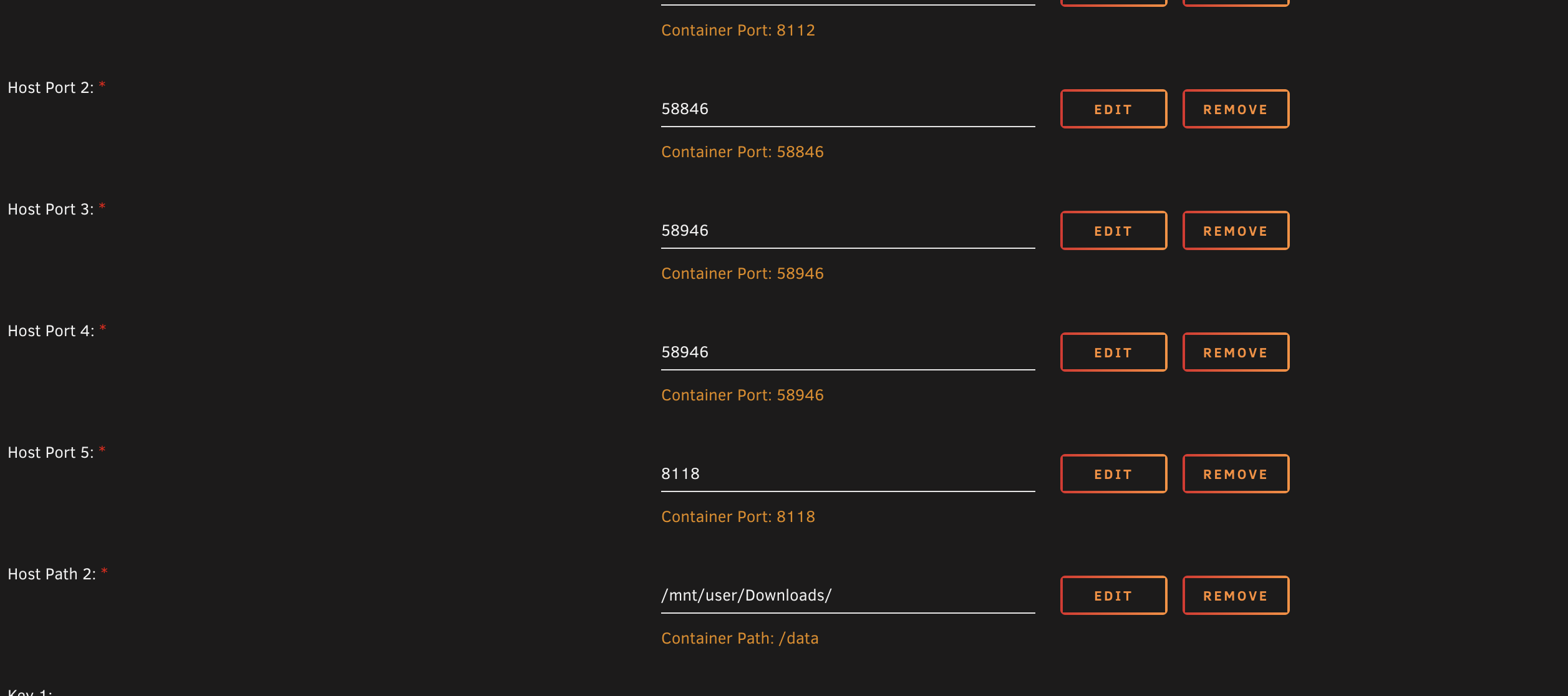

I've setup Deluge VPN on my unraid server. The VPN is working perfectly. I created a downloads folder that has the following. Completed, Incomplete, Unzipped. I have the docker setup to point to that folder as well. When I add something from sonarr, everything starts downloading... or at least shows that it is. But NOTHING is showing up in any of my download folders. I'm beyond lost as to what's happening.... So nothing ultimately downloads or it's going somewhere and I can't find it/explain it lol.
Any help would be greatly appreciated.
