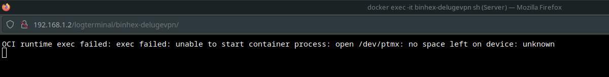

On all of this container I get following error if I want to open the console:

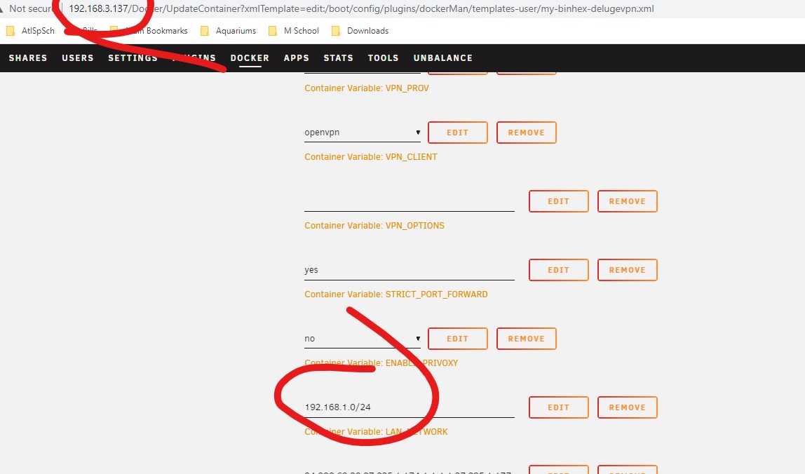

I think this is a simple fix, but before I go messing things up... I am using a new router and it gave Unraid a new IP. I can connect to the Unraid web UI but I can not connect to the binhex-delugevpn web UI. Is there something I should change? Thank you
You're right, change LAN_NETWORK to 192.168.3.0/24

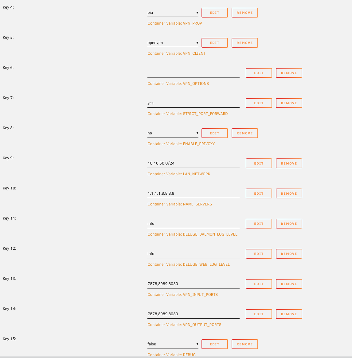

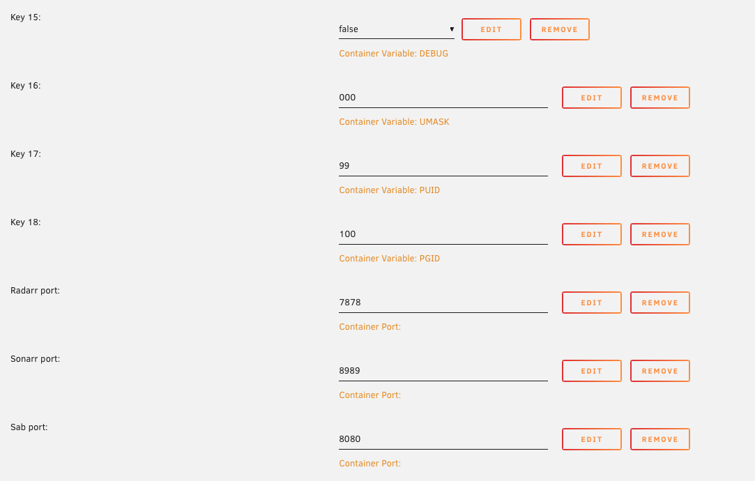

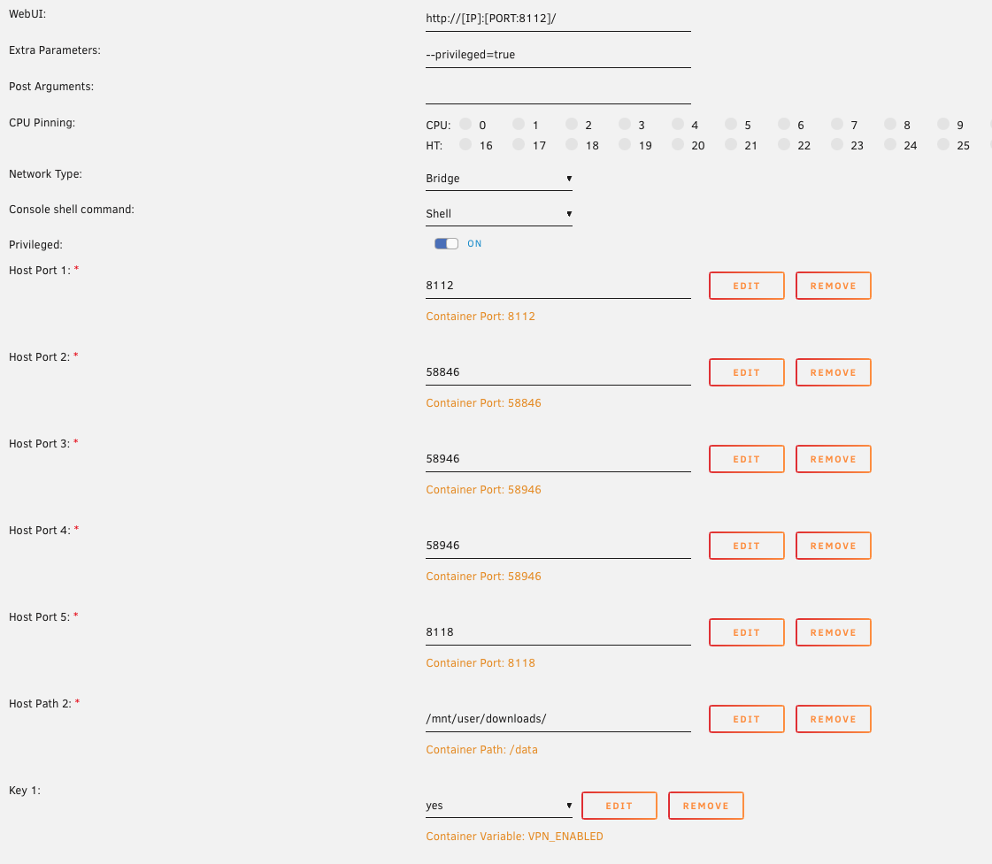

I can't access radarr/sonarr at "server-ip":7878 after I changed Docker network type from macvlan to ipvlan. Radarr/Sonarr is connected thru binhex-delugevpn, PIA OpenVPN.
  • binhex-delugevpn is working fine, no errors in log file.
  • no errors in log files on radarr/sonarr
Can it be an issue in the binhex-delugevpn settings? I checked, but can't find any. Added the settings and diagnostics. And hoping for some feedbacks.
maxx-diagnostics-20230326-1410.zip

I find weird stuff with Networking requires to actually restart the Unraid PC to Networking glitches to clear up.

Deleting and installing the dockers with the same settings, now it is working.
Thank you, that fixed it.
On 3/28/2023 at 7:28 AM, nraygun said:
This keeps happening.
Is there something that needs to be done to the container after a shutdown to make it come back up with a start up?
For now, I'll disable the auto backup plugin and see if it stays up for the rest of the week.
With the AppData backup app disabled, my DelugeVPN still fails overnight.
I'll try rebuilding the container unless anyone else has recommendations.
(deleted DelugeVPN from Docker tab, then Apps, Previous Apps, reinstall)

I'm also having an issue after updating this docker:
I can't connect to the WebGUI and I had noticed a few times before that the web gui was getting disconnected.
I removed the docker and, reinstalled it.
Here is what's in the logs.
Thanks in advance.
deluge.txt
Thanks in advance.
out of date ovpn/wireguard config would be the first thing to look at, go download the latest from your vpn provider.
