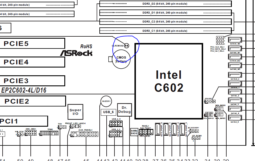

Need a little help from someone with the asrock ep2c602-4l/d16.
What are the options when it starts booting up? Like F11 to enter bios.
Is there a restore default setting?
I ended up disabling the on board graphics and of course the gpu I installed isn't working. So I have no way to get into the bios to change it.

I don't have that mobo but I just looked up the specs and it has ipmi. Have you tried using that to get back into the bios?

If you can get into the ipmi screen, under the maintenance tab is a restore factory defaults option ... That may reset your bios... I think the Java applet is just for the remote viewing function...
On second thought, maybe just want to go old school and remove the cmos battery for 30 seconds or so and short the "Clear CMOS Pad"

Finally got it.
I was able to finally get it through IMPI.
