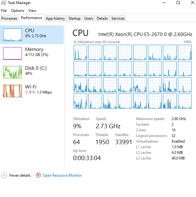

Base topology config yields...
23,231 on passmark after configuring the topology as 2 sockets, 8 cores, 2 threads..
Huh, passmark seems to like it more if you designate just one socket
This is from 1 socket 16 cores and 2 threads
Okay....weird, my best run comes from 1 socket 32 cores and 2 threads....
