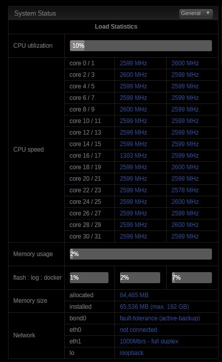

i have my dual beastie built and testing hard. Will post photos very soon after work. Changed from a server hot swap to a workstation instead.
My question:  using these xeons on the asrock board  .
Using  Internet Friendly Media Coder, in only seeing 30-50% cpu usuage on the win7 VM ive created.
handbrake on the same VM is performing the same.  Im i bottlenecking it somewhere?
Any theories?
Have 64gb ram install on the blue dimm slots only. Thought it might be a dual channel issue.
