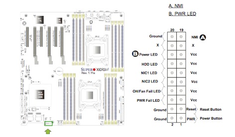

So glad to hear someone else w/ same board. I cannot make heads of tails on how to connect the HDD Light and Power Light, etc. The JF1 does not show + and - symbols like the connectors for my case. Any chance you could take a close photo of this? I have Googled and no luck w/ this. The only ones labeled are Power and Reset.
Thank you!
H.
The manual had it labeled.
Thank you BigWorm.... but are you sure that is for the Supermicro motherboard? I could not find that page/diagram in the manual.

Oh man sorry.  For some reason I thought you where asking about the Asrock board.
@hernandito
Here is a screenshot of the page from the manual for our board.
Thank you Kamhighway... I had seen it. It's just not knowing where to plug the negative and positive of the Power LED and HDD Activity LED... I will do some trial and error and hopefully not fry something.

You won't fry the LEDs by reversing their polarity; they're diodes...

+ on the right side (vcc), - on the left (ground)

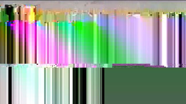

Hey Saarg, any idea why I get these randomly throughout a Blu Ray rip? I am using MakeMKV using Default settings.
You don't need handbrake to make lossless rips. You can use makemkv for that if you want mkv files.
I have no idea. Do you have any errors when ripping?
It might also be your player that is the problem. What do you use to play it and can you reproduce it with another player?
Definitely looks like a player issue, lack of CPU power.
