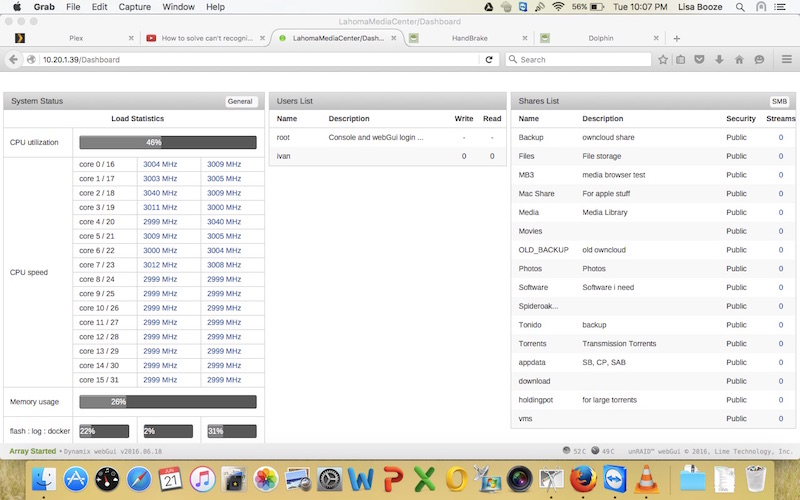

Did some encoding and go the little beast upto 3ghz clock speeds but only using 70% of potential.
day to day i'm using the unraid server for media storage and playback and rarely see it go past 5%  thats with a couple small htpc VM's running.

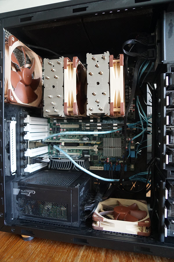

i went with Noctua NH-U12DX i4 and im not regretting it one bit as my server is in my living room and i appreciate it being low noise, but from what i read coolermaster hyper 212 EVO's would be the cheaper choice or Noctua NH-U9DXi4 if you lack clearance in hight
Thanks gert.
Picture made my mind up as I also have a Define case.
