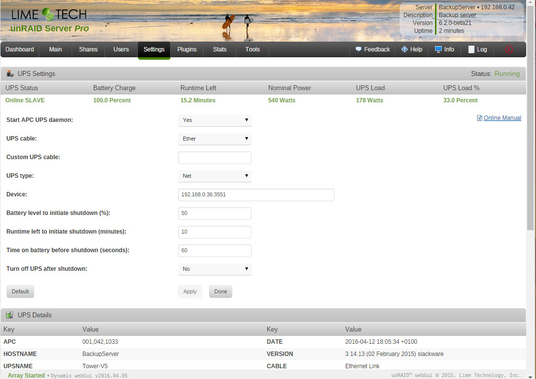

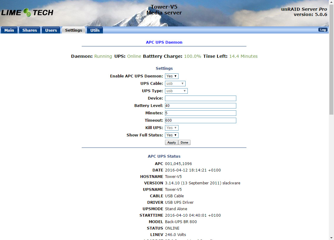

This is what I do.
I have my main unRAID server connected to the UPS since that it powered up all of the time.  That runs APCUPSD as master.  Other devices can also share the power outlets from the UPS, and they also run APCUPSD (or the version built into unRAID 6).  I have at different times done this with my backup server and also with a Windows machine which also runs APCUPSD.  They are connected to the network switch / router and the software in each systems is told that it is connected via Ethernet as a slave, and it is directed to the master by IP address and port number.  THe attached image shows typical settings for the slave device.  An important point the ensure is that the system acting as master is the one that shuts down the UPS but it must remain powered for longer than any of the slaves.  The switch or router must also be powered by the UPS for this to work correctly.
Master settings here... (due to attachment size limit)
