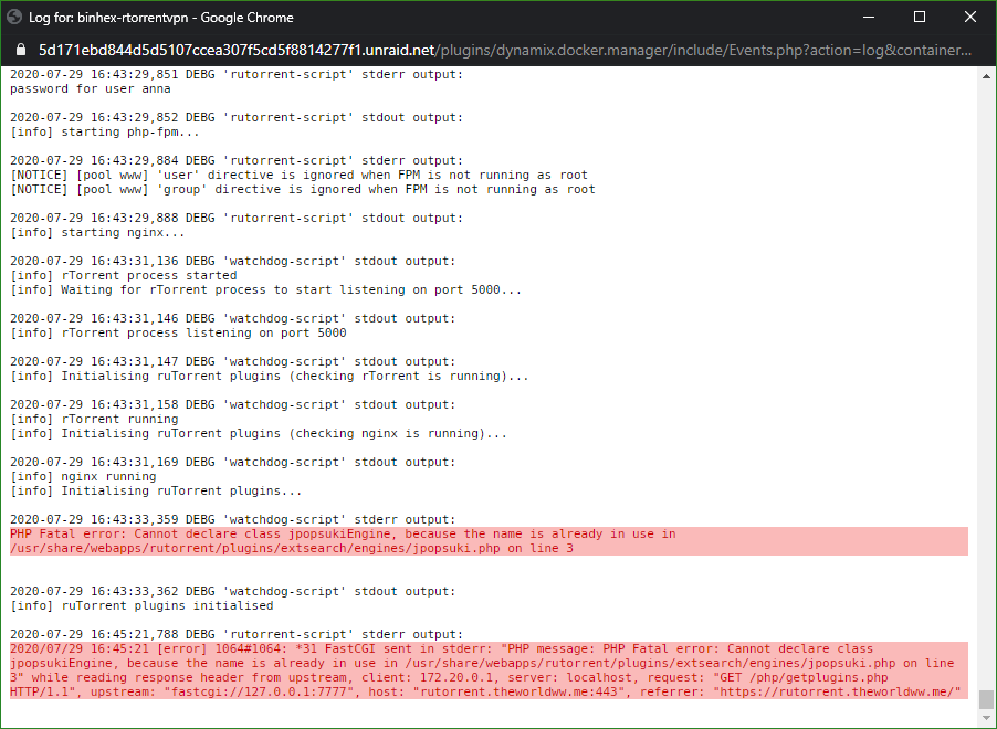

So a LOT of debugging later I figured out what's giving the error;
If I go in to the docker via the shell and go to /usr/share/webapps/rutorrent/plugins/extsearch/engines/ I see that for some reason I have JPopsuki.php and jpopsuki.php. If I manually remove the lowercase one (rm jpopsuki.php) and go to the site for my rtorrent and hit F5 the interface loads up normally.
If I restart the docker it will auto re-create the file and I will be in the same situation again.
I manually created the Uppercase version from https://github.com/Novik/ruTorrent/blob/master/plugins/extsearch/engines/JPopsuki.php
Is there a way to keep it from auto creating that upon startup?
i would suspect you have downloaded and installed a user plugin and this is now clashing with the built in plugins, check the location:-
/config/rutorrent/user-plugins/
are there any plugins in that directory?, if so remove the conflicting plugin and restart the container.

The plugin isn't there, if i go through the appdata share and look in the same folder I can literally take everything out of it and it will still put that file back at /usr/share/webapps/rutorrent/plugins/extsearch/engines/.
I even tried removing the Docker, it's Image, going stock, it will launch the first time just fine completely stock (yes, I removed the ~/appdata/binhex-rtorrentvpn directory) and it will do it on the second start.
very odd!, firstly the lower case file you mentioned does not exist in the latest image, and i run this image myself and dont have any issues with conflicting plugins so im sure the image is fine, are you definitely running tagged 'latest' image right?, as in the 'Repository' is set to 'binhex/arch-rtorrentvpn'
