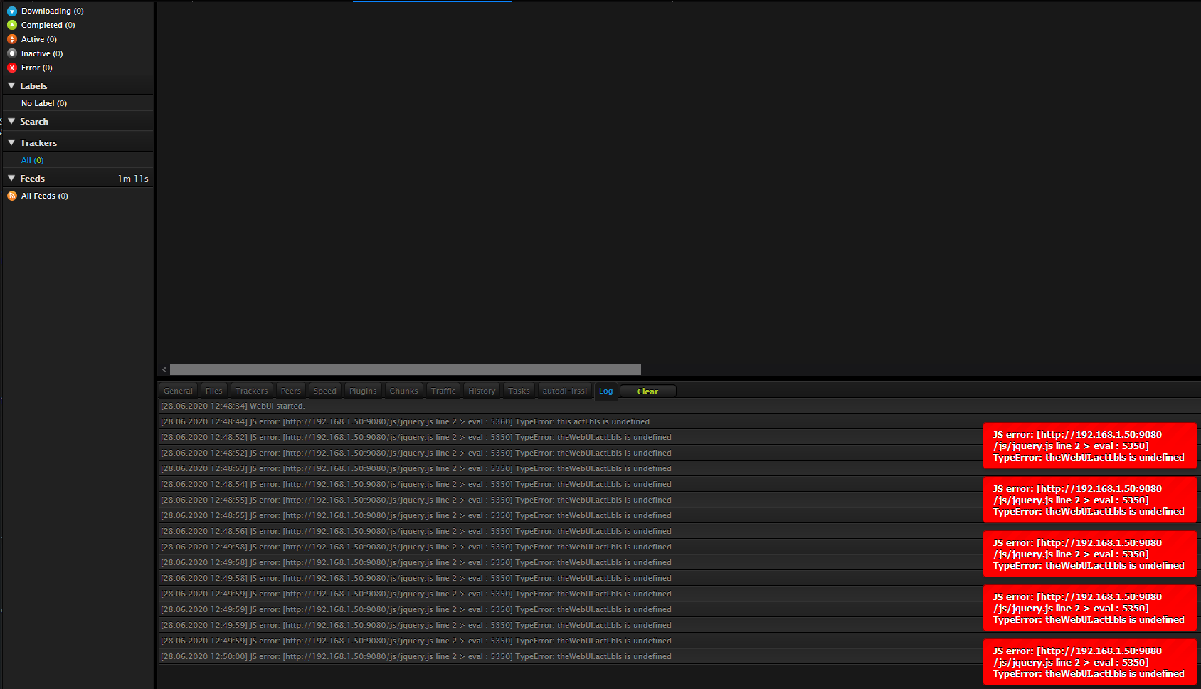

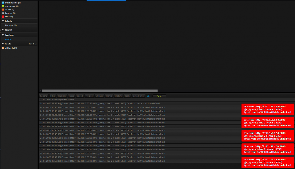

Just updated and now getting this...
[28.06.2020 12:46:56] JS error: [http://192.168.1.50:9080/js/jquery.js line 2 > eval : 5360] TypeError: this.actLbls is undefined
Literally all 600-something of my torrents have disappeared too and I can't click on anything on the UI without getting this error.
EDIT: Going to settings still works. > General > Change theme to standard. Now I can see my torrents again.
EDIT2: Back to Oblivion Theme, now it works.
EDIT3: Rebooted docker container, same error, and same above fix worked. So it's an error thrown at runtime.
Edited by plantsandbinary
possibly related?:-
https://github.com/Novik/ruTorrent/issues/1920
also do a complete wipe of your browser cache, try another browser too, i suspect it is going to be a script blocker or caching issue with your browser, i am not seeing this error at all and im running latest.

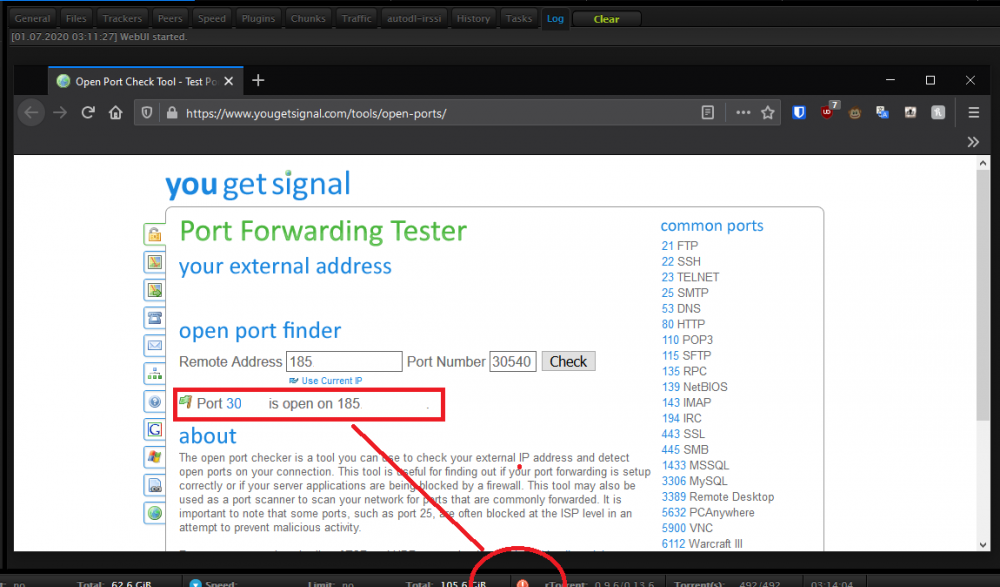

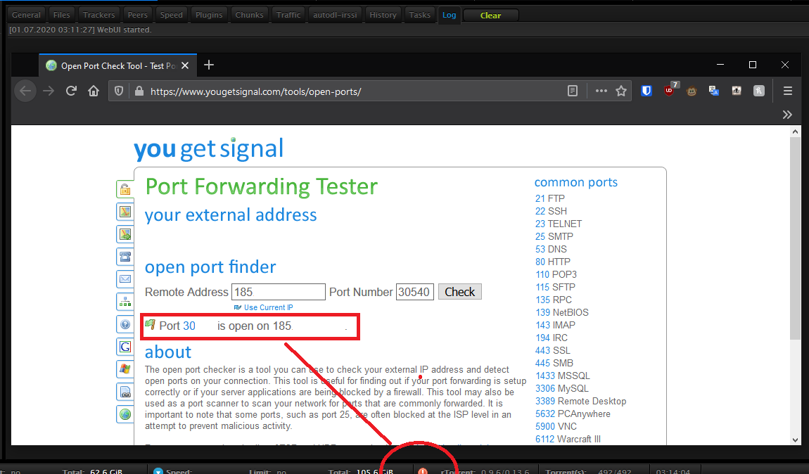

17 hours ago, koth said:
Forgot to add, I did also set the port_range in rtorrent.rc to 57717-57717. It's forwarded through my provider and works with the same .ovpn with qbittorrent.
is the incoming port indicator in rutorrent shown as green (bottom of the rutorrent web ui)?, it should look like this if the incoming port is visible externally:-
if its not green then the port assignment from your vpn provider is not working or you have misconfigured rutorrent/rtorrent.
14 minutes ago, koth said:
Yes, I rechecked the port as well and it was still good, correct ip/port is reported to trackers
ok in that case i would suspect your vpn provider is blocking torrent traffic, you could try another vpn endpoint, perhaps they permit torrent traffic on certain endpoints only, who is your vpn provider?.

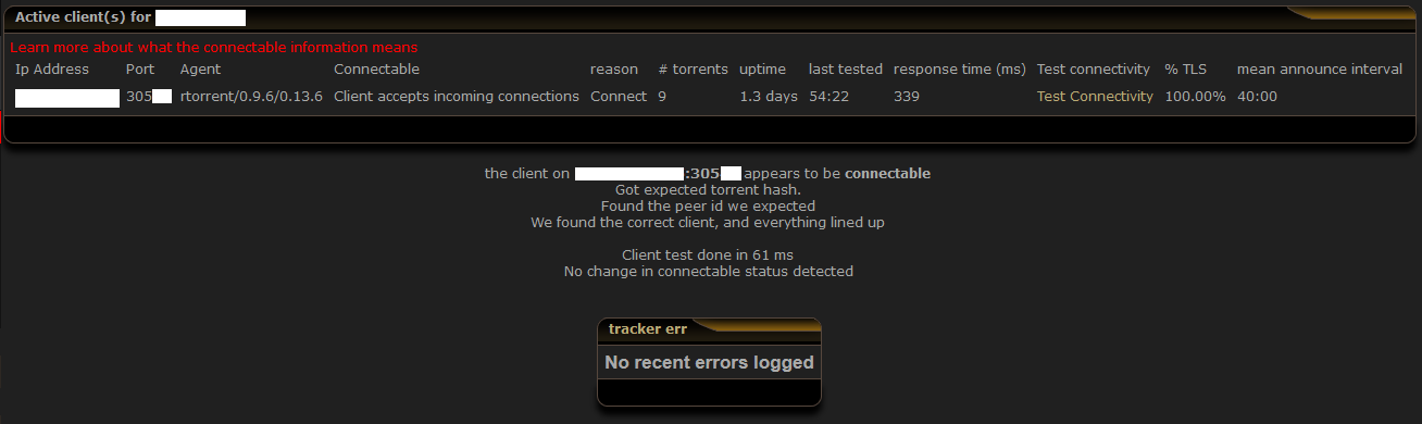

but you just said to me earlier this plugin/indicator has been broken for years. The best way to check if you are connectable is to use a tracker that can test for you or some kind of torrent-vpn checker that can test if your port is open or not, at least that's what I use to confirm it.
EDIT: Here's what I mean. ruTorrent shows closed, but the tracker says I am connectable and my port is open.
I haven't trusted that ruTorrent plugin for years.
nope, you said that and i corrected you:-
https://forums.unraid.net/topic/46127-support-binhex-rtorrentvpn/?do=findComment&comment=865127
if the indicator at the bottom of the screen is red then you do not have a working incoming port, that plugin IS reliable, at least it is now that it got fixed (was broken for around 2 months).
grab your external ip address from settings/bittorrent/ip-host to report to tracker, grab your incoming port from settings/connection/port used for incoming connections and head over to this website:- https://www.yougetsignal.com/tools/open-ports/
paste in the ip and port and click on 'check', i think you will find your port is not open.
I'm tellin' ya. That thing does not work. 3 sites all tell me it's open. I have never, ever seen a green tick on that thing. Plus I am able to download and upload at line speed. Might want to check it again, but I don't think it's worth the hassle.
and i'm tellin' ya its always worked for me :-), i have a green icon right now, when it goes red then i check and sure enough the port is closed, my scripts then kick in and reconfigure the port and it goes back to green, dunno what to say dude but for the vast majority of people this just works *shrug*.
