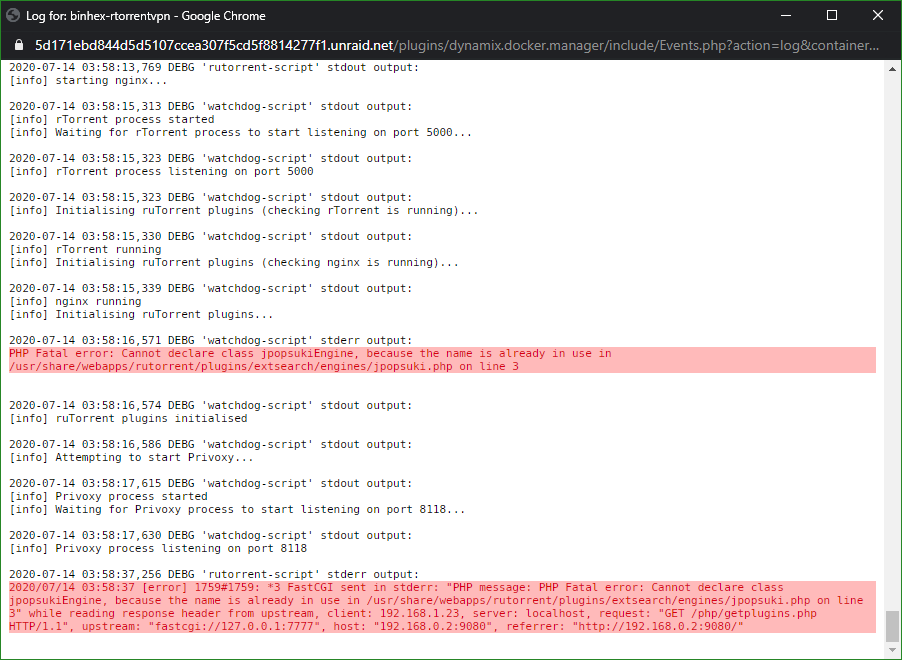

rtorrent was working fine, but suddenly getting the following errors (attached screenshot)
What could be the issue.
hmm not sure why your plugins are not starting, but there are two easy steps to fix this:-
1. restart the container - if this doesnt fix the plugins issue then....
2. left click the icon, select 'edit' change a value of something and then change it back to what it was (so in effect no change) then click on 'apply' at the bottom, this will delete the old (broken) container and re-create it.

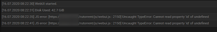

Now I'm getting this error:
[16.07.2020 23:55:56] JS error: [http://192.168.1.201:9080/js/webui.js : 765] Uncaught TypeError: Cannot read property 'rTorrent' of undefined
