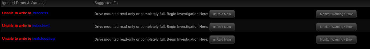

Is there anyway to get the full file path of an error?
I had an error show up:
"Unable to write to nextcloud.log"
But have no idea how to solve it. All drives are working correctly. And I uninstalled nextcloud. Is there anyway to see the full file path of this file so I can delete it?

That's strange.  Been quite a while since I've looked at that part of the code, but IIRC I attempt to write a randomly named file to the root of each disk.  Those three errors *imply* that somehow you've created files / folders within /mnt inadvertently.  Since next cloud isn't running (or nginx / apache), a reboot should solve the problem.  But, nothing should ever get created by a docker in /mnt unless you've got the template misconfigured.
But I'll look at the code tonight and confirm.
Thanks Squid. There in /mnt.
Not sure how I managed to do that.
All fixed now.
Thanks for the help!

It works well enough as it is, and it's obviously not a big issue, but I suspect some of us would be happier if we had a way to suppress the ignored messages going to the syslog.  Perhaps when you have time for a minor enhancement, you could add an option to suppress them even from the syslog, then add a view option to see the last set of ignored messages.  So when you run a scan, send the messages either to the syslog or to an internal buffer, which can be viewed on button push ("Display ignored messages").
All it does is log that ignored errors were found.  This was so that if in the event diagnostics were getting uploaded whomever was looking at it would see that the user has ignored something.
On the GUI, any errors which are ignored (but found again) do appear on the ignored list
