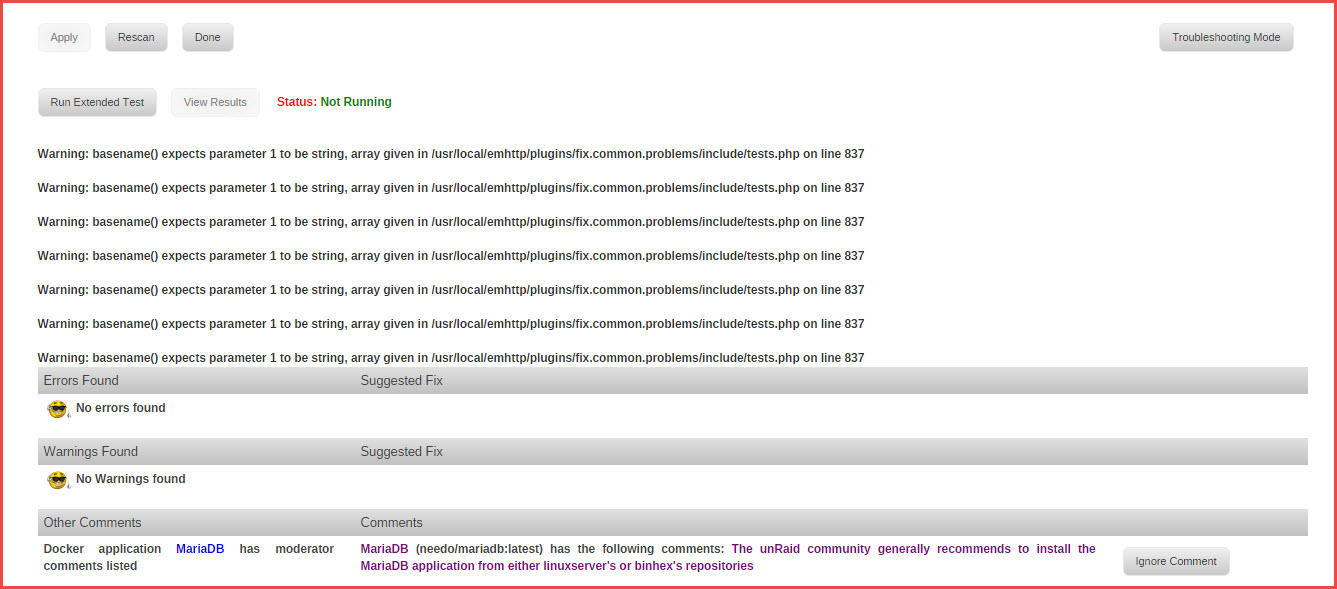

I updated to 6.3.1 today and am getting this warning when scanning for errors, but does not detect any errors and otherwise seems to be working OK.  Any ideas?

And it's fixed.  Caused by a specific error in an application template that an author made...  Hard to anticipate every template error...
Still having this error message. Restarted chrome, closed all chrome windows on all relevant PCs, and still have this error.
Hopefully a stupid question, but did you update FCP?  Show a screenshot of the error as if its still present it should have changed slightly.  Its not showing on my systems after the update
The update fixed it for me.  Many thanks!
Good question  :) but yes, I updated FCP. It says version 2017.02.03b now. Screenshot attached.
