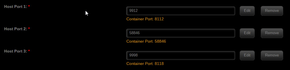

I'm not sure if this is specific to 6.3.5, or if this has been there for some time, but I'm seeing an error related to the delugevpn docker container port...
" Docker Application delugevpn, Container Port 58946 not found or changed on installed application"
I'm actually seeing this error listed twice, with exactly the same message.  I checked the delugevpn settings, and I don't see any issues...
Port 58946 isn't listed in your template, but it is in the template supplied by binhex
Right, but I never changed it (at least I don't remember doing so), so how do I stop it complaining?  I don't care which port it uses, I just want to eliminate any "errors" going forward?  I don't see any easy way to change 58846 to 58946, nor do I know any reason to do so, other than to get the errors to stop?
ideas?
If everything is fine as is, hit Ignore.  Ideally, ask in Binhex's thread about the ramifications of not having that port defined in your template.  (BTW, IIRC @binhex's template references both 58846 and 58946, so simply changing your container port is just going to change the wording (ie the port number) that FCP is complaining about)
AFAIK, the issue is the dual nature of the container. If VPN is enabled, no need for the 58xxx ports. If VPN is off, those ports are needed to enable incoming torrent connections. Most people using the container enable the VPN, so the extra mapping is not used.
