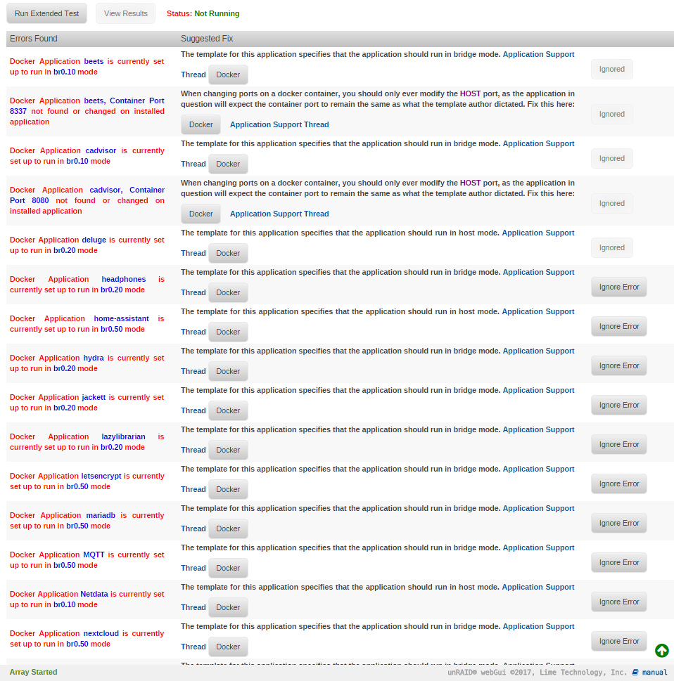

I've created VLANs recently and assigned IPs to most of my dockers and sometimes a VLAN.  I don't think CA should throw these up as errors e.g. beets running in bro.10 mode rather than bridge isn't an error:
5a0fe80b6d69b_FireShotCapture14-Highlander_FixProblems-http___172_30_12.2_Settings_FixProblems.thumb.png.c0300035ee56610ce0bb3253de0c8ab3.png
Switched FCP to ignore the test if you're not running in host or bridge mode.  Too many complexities if running in other network modes (that I can't test)
