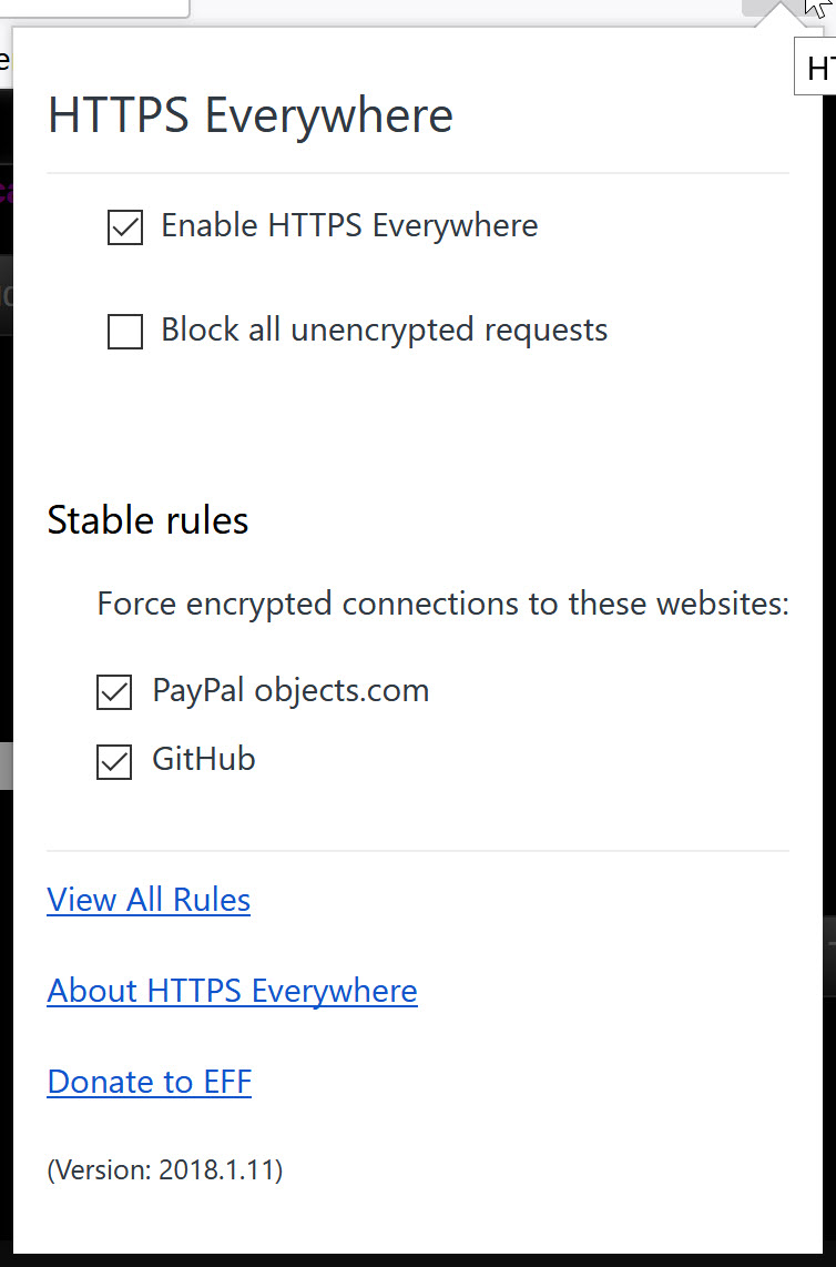

that page gives me a warning about my adblocker, but ghostery shows nothing for that page, uBlock Origin only shows the server IP and paypalobjects (which really concerns me now that I've seen it), but both are green/allowed.
I'm not sure what it's detecting as an ad blocker, nor how/where to whitelist.
I opened another tab, went to the server, and can navigate fine, and stopped the array.  Went back to the fix common problems and it pops up telling me its scanning and blocks navigation on/from that page.
i guess I'll have to reboot the server??
No, the scanning window went away, so I restarted the array, and checked again, and it's showing an error 'array not started'.  it's as if it's not refreshing.  I re-scanned again, and it finished quick enough, and now I have no errors :)
I am concerned about the redirects though, paypal objects and github (screenshot below).  github is fine, but why is paypay objects.com being linked from this page?
The ad blocker test ( @bonienl supplied it to me way back when ) means that your browser is removing an element on the FCP page that's designed to trigger ad-blockers (but is in no way an ad - pretty standard test AFAIK).  The test is there because some ad blockers do interfere with the operation of unRaid's UI.  Obviously your's isn't, but is still triggering the error.  I wouldn't worry about it.
paypal objects
Click "HELP" or Credits, and all will be made clear.
GitHub is my avatar.  And it is https to begin with.
Edited by Squid
I was just concerned the ad block issue is/was related to the scanning taking forever.  I just went back to the page and the scanning window came back up; even though it had finished the last time i was on the page.
I checked credits and see where it comes from.  I didn't realize it would scan that part of the page if credits window wasn't opened.  Guess I was wrong.  Link works :)
Thanks again for everything,

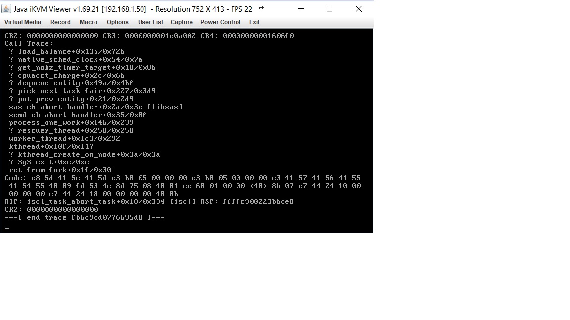

Is anyone having trouble with the plugin being stuck on the Scanning screen. I recently noticed this after updating to 6.4.0 and ran into this issue after running the plugin it never finished scanning and made my server unresponsive. If i tried to stop it or reboot or shutdown it would just hang. I had to hard reset it. I installed a new clean version of Unraid on a new flash drive and ran into the same issue after over a hour still stuck on the scanning screen. And once again after attempting to stop uraid or reboot it just hangs. Doesn't stop it and becomes unresponsive. This is a screenshot of my motherboard ipmi that i don't quite understand when i run the plugin. Any help would be appreciated.
You would need to post what's showing before that. Ideally the diagnostics or at least the syslog
Sent from my SM-T560NU using Tapatalk
Ok i'm trying to do that right now but as soon as i install the plugin or start it nothing works. It wont allow me to do a diagnostic download i did capture another screenshot gonna try some more in maintenance mode. sdadasdds.jpg.4b238953841d684bf4a80183e4f1c803.jpg
Something else is wrong.
From the local console (or SSH), can you do this then
tail -f /var/log/syslog > /boot/syslog.txt
and then install FCP and when it crashes the syslog will be saved on the flash drive
Got your PM (yes they're safe to post publicly).  Your problem is identical to this one:
If you want, tomorrow I can bang together a special version of FCP for you to manually install to see exactly where the issue is.
Thanks squid that sounds great.
Try this.  From a command prompt,
cd /tmp
wget https://github.com/Squidly271/fix.common.problems/raw/master/archive/fix.common.problems-2018.01.20-x86_64-1.txz
installpkg fix.common.problems-2018.01.20-x86_64-1.txz
Then, open up the log window on unRaid's UI and go to Settings - Fix Common Problems
If the log Window doesn't show Fix Common Problems and start scrolling, then hit ReScan
Post the output when it crashes

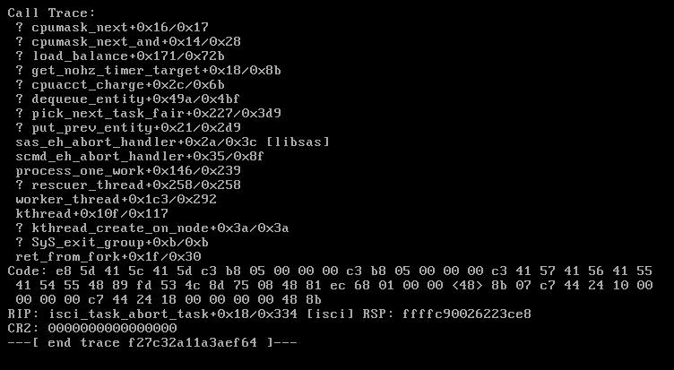

ok.  Can you do these commands.  It may crash your system though, but its just doing the same test as where its crashing in the plugin.
/sbin/hdparm -N /dev/sdc
/sbin/hdparm -N /dev/sdb
After doing the commands i get this.
root@Tower:~# /sbin/hdparm -N /dev/sdc
/dev/sdc:
 max sectors   = 1953525168/1953525168, HPA is disabled
root@Tower:~# /sbin/hdparm -N /dev/sdb
/dev/sdb:
huh.
Save the attached file to the flash drive and then do
/boot/test.php
  Also grab another syslog after running
test.php
After running the command the system crashes so i can't do a diagnostic so i had the log window open and copied it here it is.

Jan 21 11:05:42 Tower kernel: BUG: unable to handle kernel NULL pointer dereference at (null)
Jan 21 11:05:42 Tower kernel: IP: isci_task_abort_task+0x18/0x334 [isci]
Jan 21 11:05:42 Tower kernel: PGD 0 P4D 0
Jan 21 11:05:42 Tower kernel: Oops: 0000 [#1] PREEMPT SMP PTI
Jan 21 11:05:42 Tower kernel: Modules linked in: xt_CHECKSUM iptable_mangle ipt_REJECT nf_reject_ipv4 ebtable_filter ebtables ip6table_filter ip6_tables vhost_net tun vhost tap veth xt_nat ipt_MASQUERADE nf_nat_masquerade_ipv4 iptable_nat nf_conntrack_ipv4 nf_defrag_ipv4 nf_nat_ipv4 iptable_filter ip_tables nf_nat xfs md_mod bonding igb ptp pps_core i2c_algo_bit ipmi_ssif sb_edac x86_pkg_temp_thermal intel_powerclamp coretemp kvm_intel kvm crct10dif_pclmul crc32_pclmul crc32c_intel ghash_clmulni_intel pcbc aesni_intel aes_x86_64 crypto_simd glue_helper cryptd isci libsas intel_cstate intel_uncore ahci intel_rapl_perf libahci scsi_transport_sas i2c_i801 mxm_wmi i2c_core wmi ipmi_si button [last unloaded: pps_core]
Jan 21 11:05:42 Tower kernel: CPU: 0 PID: 1559 Comm: kworker/u80:1 Not tainted 4.14.13-unRAID #1
Jan 21 11:05:42 Tower kernel: Hardware name: Supermicro X9DR3-F/X9DR3-F, BIOS 3.2a 07/09/2015
Jan 21 11:05:42 Tower kernel: Workqueue: scsi_tmf_7 scmd_eh_abort_handler
Jan 21 11:05:42 Tower kernel: task: ffff88103b087000 task.stack: ffffc90007ad0000
Jan 21 11:05:42 Tower kernel: RIP: 0010:isci_task_abort_task+0x18/0x334 [isci]
Jan 21 11:05:42 Tower kernel: RSP: 0018:ffffc90007ad3ce8 EFLAGS: 00010296
Jan 21 11:05:42 Tower kernel: RAX: ffffffffa0067cbb RBX: ffff8810383afda8 RCX: 0000000000000000
Jan 21 11:05:42 Tower kernel: RDX: ffff88103f418420 RSI: 0000000000000a00 RDI: 0000000000000000
Jan 21 11:05:42 Tower kernel: RBP: 0000000000000000 R08: 000000000000011a R09: 0000000000000000
Jan 21 11:05:42 Tower kernel: R10: 0000000000000003 R11: ffff88103b0870c0 R12: ffff88102a1f3800
Jan 21 11:05:42 Tower kernel: R13: 0000000000000000 R14: 0000000000000008 R15: 0000000000000000
Jan 21 11:05:42 Tower kernel: FS: 0000000000000000(0000) GS:ffff88103f800000(0000) knlGS:0000000000000000
Jan 21 11:05:42 Tower kernel: CS: 0010 DS: 0000 ES: 0000 CR0: 0000000080050033
Jan 21 11:05:42 Tower kernel: CR2: 0000000000000000 CR3: 0000000001c0a005 CR4: 00000000001606f0
Jan 21 11:05:42 Tower kernel: Call Trace:
Jan 21 11:05:42 Tower kernel: ? native_sched_clock+0x54/0x7a
Jan 21 11:05:42 Tower kernel: ? sched_clock+0x5/0x8
Jan 21 11:05:42 Tower kernel: ? sched_clock_cpu+0x10/0xb7
Jan 21 11:05:42 Tower kernel: ? update_rq_clock+0x19/0x86
Jan 21 11:05:42 Tower kernel: ? get_nohz_timer_target+0x18/0x8b
Jan 21 11:05:42 Tower kernel: ? cpuacct_charge+0x2c/0x6b
Jan 21 11:05:42 Tower kernel: ? dequeue_entity+0x49a/0x4bf
Jan 21 11:05:42 Tower kernel: ? pick_next_task_fair+0x227/0x3d9
Jan 21 11:05:42 Tower kernel: ? put_prev_entity+0x21/0x2d9
Jan 21 11:05:42 Tower kernel: sas_eh_abort_handler+0x2a/0x3c [libsas]
Jan 21 11:05:42 Tower kernel: scmd_eh_abort_handler+0x35/0x8f
Jan 21 11:05:42 Tower kernel: process_one_work+0x146/0x239
Jan 21 11:05:42 Tower kernel: ? rescuer_thread+0x258/0x258
Jan 21 11:05:42 Tower kernel: worker_thread+0x1c3/0x292
Jan 21 11:05:42 Tower kernel: kthread+0x10f/0x117
Jan 21 11:05:42 Tower kernel: ? kthread_create_on_node+0x3a/0x3a
Jan 21 11:05:42 Tower kernel: ret_from_fork+0x1f/0x30
Jan 21 11:05:42 Tower kernel: Code: e8 5d 41 5c 41 5d c3 b8 05 00 00 00 c3 b8 05 00 00 00 c3 41 57 41 56 41 55 41 54 55 48 89 fd 53 4c 8d 75 08 48 81 ec 68 01 00 00 <48> 8b 07 c7 44 24 10 00 00 00 00 c7 44 24 18 00 00 00 00 48 8b
Jan 21 11:05:42 Tower kernel: RIP: isci_task_abort_task+0x18/0x334 [isci] RSP: ffffc90007ad3ce8
Jan 21 11:05:42 Tower kernel: ---[ end trace a66947bacdc42531 ]---
But what was the last thing it showed before it crashed?  Or did it show nothing?
Jan 21 11:08:32 Tower nginx: 2018/01/21 11:08:32 [error] 4096#4096: *885 upstream timed out (110: Connection timed out) while reading response header from upstream, client: 192.168.1.24, server: , request: "POST /webGui/include/Download.php HTTP/1.1", upstream: "fastcgi://unix:/var/run/php5-fpm.sock", host: "192.168.1.2", referrer: "http://192.168.1.2/Tools/Diagnostics"
Jan 21 11:12:40 Tower shfs: error: shfs_rmdir, 1517: Directory not empty (39): rmdir: /mnt/cache/appdata/plexpass/Plex Media Server/Cache/Transcode/Sessions/plex-transcode-362c5db2e09418a244b673d47c178dec-925acc3c-ae37-4f38-a96a-4a0aa9e68a62
Jan 21 11:13:11 Tower shfs: error: shfs_rmdir, 1517: Directory not empty (39): rmdir: /mnt/cache/appdata/plexpass/Plex Media Server/Cache/Transcode/Sessions/plex-transcode-362c5db2e09418a244b673d47c178dec-c4a47f8d-a421-414c-a030-1737810ae094
Jan 21 11:13:11 Tower shfs: error: shfs_rmdir, 1517: Directory not empty (39): rmdir: /mnt/cache/appdata/plexpass/Plex Media Server/Cache/Transcode/Sessions/plex-transcode-362c5db2e09418a244b673d47c178dec-925acc3c-ae37-4f38-a96a-4a0aa9e68a62
Done
this is the only thing i saw it do.

Here's the thing.  That drive particular drive (disk 3) for whatever reason crashes the hdparm command.  But disk 2 which is an identical drive works.  No real idea here.
What I've done though is water down the test to only look at the Parity disks.  They're the only ones that really matter on the test anyways.  The test was at least getting through your 1st parity.  If it still crashes (when it hits parity 2), my advice is going to be to remove FCP.
So for now just dont use the plugin? And is there anything else i can do or try to make it work? When you had me manually download the plugin it didn't save it to unraid after i rebooted the system the plugin wasn't there like it never installed.
try the update.  The other was a special build just to see which test was giving the problem.
