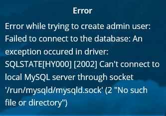

I have now deleted nextcloud.
Made a folder in mnt/user/appdata for files and called it NCDATA
Reinstalled Nextcloud
Pointed the data folder to the folder i made (NCDATA)
Started the webgui in order to make a admin user and get the following error :
Edited by mrvilla
