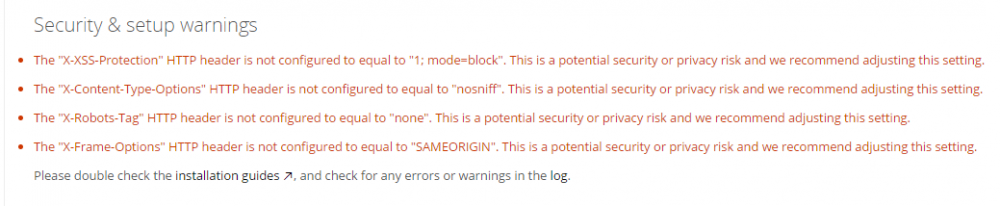

Check the headers on some of the requests when visiting your nextcloud in a browser. If you see double, then chances are there is a config with LetsEncrypt that is also setting headers which you do not want.
You were correct.
It seems the headers are added in LetaEncrypt's nginx.conf and in Nextcloud's default.
What's the correct location to remove it?
And how come I'm thr only one with this problem?
Just installed both containers from the Community Applications... Haven't done any customization except the reverse proxying in LetsEncrypt default.
BTW - is there a way to combine both dockers into one, using the nginx built into Nextcloud for reverse proxying with LetsEncrypt?
Sent from my LG-K430 using Tapatalk
I have the same setup as you. I let the Nextcloud nginx default config do the work for the headers and leave LetsEncrypt to do only very basic reverse proxying. Seems to keep things simpler.
If you access Nextcloud from outside, and go to the Admin page, doesn't it alert of some security warnings?
Those errors will be there when you have duplicate header values, even if the values are good. Fix the dupe header issue and see if it goes away.
I know, already checked it, but don't know why I'm the only one with this problem and where should I fix it...

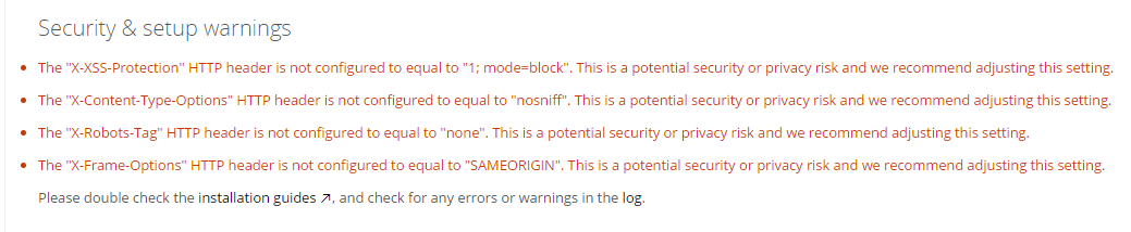

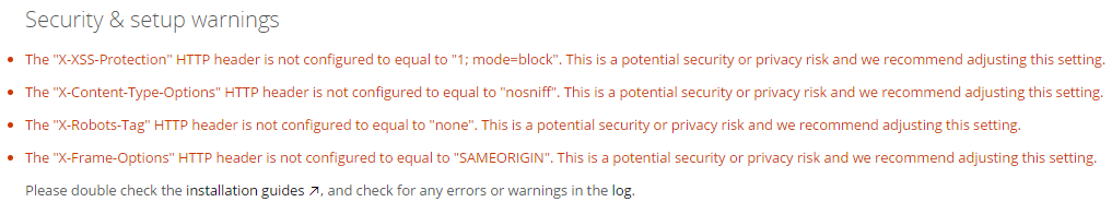

  4. Accessing the "Server settings" page externally (after a popup of trusted domain), getting security warnings:
  5. Following @johnsanc advice, found out I've got the following duplicate settings at "\appdata\Nextcloud\nginx\site-confs\default" and "\appdata\LetsEncrypt\nginx\nginx.conf":
    add_header X-Content-Type-Options nosniff;
    add_header X-Frame-Options "SAMEORIGIN";
    add_header X-XSS-Protection "1; mode=block";
    add_header X-Robots-Tag none;
So now that I've found the exact problem, what would be the better way to fix it?
Which file should I edit and will survive a container update?
I'm tending towards changing "\appdata\Nextcloud\nginx\site-confs\default", because I want the added security headers for all of my reverse proxied sites...
Thanks (especially if you've read it all ::))
