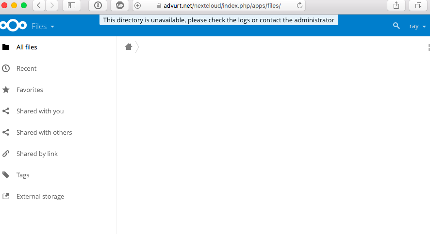

BUT now that I'm in Nextcloud, I have a new problem.
I get a "This directory is unavailable" error:
index.php?action=dlattach;topic=50090.0;attach=41306;image
