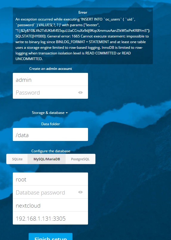

Should look like this..
Yes, I went past this prompt; however, the original password used during the setup of Mariadb was not accessible. I had to leave the password blank and hit enter to get to this prompt.
Sent from my SM-G935V using Tapatalk
I'm confused, you'd only see this screen if the password was correct when you entered it.
Well, I guess I'm just as confused. I could not pass it with the original password, and I tried it twice, wiping out the entire Mariadb and Nextcloud containers, including the leftover folders.

Only other thing I can think of is once you set the MariaDB root password in the template on the initial pull you can't change it afterwards by changing the template.  It ONLY works that initial time.
EDIT:  The other problem I've seen with this is people not including the semi-colons at the end of the mysql commands here.

I copied the entire prompt, including the ";". I saw that as an issue in one of the previous posts...
I just checked the MariaDB install and the password is there. I am using "root" as the Database user. Password created during the initial MariaDB install, nextcloud as the Database name. IP as shown on the MariaDB IP:port on the Docker page.
When you say you copied the entire prompt, you did edit it before using right?  Changing $MARIADB-ROOT-PASSWORD to your actual password?

Uh oh....[emoji10] I feel a little bit embarrassed... I left the string as is...
If it makes you feel better, you're not the first....  ;D

OK, so I removed both MariaDB and NC. Reinstalled MD with the correct parameters, and a new password. When running the
CREATE DATABASE IF NOT EXISTS nextcloud;
GRANT ALL PRIVILEGES ON nextcloud.* TO 'root'@'localhost' IDENTIFIED BY '$MARIADB-ROOT-PASSWORD';
I used the correct, matching password. Installed NC. Now, when I try to go to the WebUI, I get "This site can’t be reached 192.168.1.131 refused to connect." I see the correct NC logo on the tab, but the page does not load.
I am confused. I did not really change anything else.
I really do not know what else to suggest.  I just did a fresh install to check the instructions inside of five minutes.  Definitely working.  Have you checked the logs of both containers and cleared your browser cache?
I guess I just needed to wait a few minutes, because subsequently I was able to get to the create admin screen. Now, new error message
You haven't enabled binlogging in custom.cnf
Did you remove the # as well as change it to mixed?
I changed the binlog format to mixed, but did not remove the "#" in front of it. Did not notice that. Thank you. I'll redo all now.
Don't forget to remove the # in front of the other line as well.
