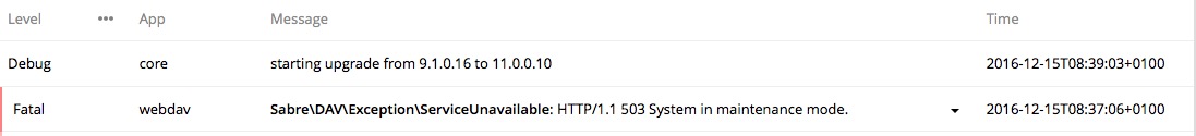

I just upgraded and having difficulties to activate calendar and contacts:
2016/12/15 08:37:31 [error] 309#0: *1 FastCGI sent in stderr: "Primary script unknown" while reading response header from upstream, client: 192.168.178.21, server: _, request: "PROPFIND /nextcloud/remote.php/webdav/ HTTP/1.1", upstream: "fastcgi://127.0.0.1:9000", host: "192.168.178.28:444"
2016/12/15 08:38:03 [error] 309#0: *12 FastCGI sent in stderr: "PHP message: {"reqId":"0z6FKw2hdXuM52WxHvye","remoteAddr":"192.168.178.21","app":"PHP","message":"touch(): Utime failed: Permission denied at \/config\/www\/nextcloud\/lib\/private\/Config.php#229","level":3,"time":"2016-12-15T07:38:03+00:00","method":"GET","url":"\/nextcloud\/status.php","user":"--","version":""}
PHP message: {"reqId":"0z6FKw2hdXuM52WxHvye","remoteAddr":"192.168.178.21","app":"PHP","message":"fopen(\/config\/www\/nextcloud\/config\/config.php): failed to open stream: Permission denied at \/config\/www\/nextcloud\/lib\/private\/Config.php#230","level":3,"time":"2016-12-15T07:38:03+00:00","method":"GET","url":"\/nextcloud\/status.php","user":"--","version":""}
PHP message: {"reqId":"0z6FKw2hdXuM52WxHvye","remoteAddr":"192.168.178.21","app":"PHP","message":"chmod(): Operation not permitted at \/config\/www\/nextcloud\/lib\/private\/Config.php#233","level":3,"time":"2016-12-15T07:38:03+00:00","method":"GET","url":"\/nextcloud\/status.php","user":"--","version":""}
PHP message: {"reqId":"0z6FKw2hdXuM52WxHvye","remoteAddr":"192.168.178.21","app":"remote","message":"Can't write into config directory!","level":4,"time":"2016-12-15T07:38:03+00:00","method":"GET","url":"\/nextcloud\/status.php","user":"--","version":""}
PHP message: {"reqId":"0z6FKw2hdXuM52WxHvye","remoteAddr":"192.168.178.21","app":"PHP","message":"chmod(): No such file or directory at \/config\/www\/nextcloud\/lib\/private\/Log\/File.php#119","level":3,"time":"2016-12-15T07:38:03+00:00","method":"GET","url":"\/nextcloud\/status.php","user":"--","version":""}" while reading response header from upstream, client: 192.168.178.21, server: _, request: "GET /nextcloud/status.php HTTP/1.1", upstream: "fastcgi://127.0.0.1:9000", host: "192.168.178.28:444"
2016/12/15 08:38:25 [error] 309#0: *1 open() "/config/www/nextcloud/images/thumbs/05.jpg" failed (2: No such file or directory), client: 172.17.0.1, server: _, request: "GET /nextcloud/images/thumbs/05.jpg HTTP/1.1", host: "192.168.178.28:443", referrer: "https://192.168.178.28/nextcloud/"
2016/12/15 08:38:25 [error] 309#0: *2 open() "/config/www/nextcloud/assets/js/jquery.min.js" failed (2: No such file or directory), client: 172.17.0.1, server: _, request: "GET /nextcloud/assets/js/jquery.min.js HTTP/1.1", host: "192.168.178.28:443", referrer: "https://192.168.178.28/nextcloud/"
2016/12/15 08:38:25 [error] 309#0: *4 open() "/config/www/nextcloud/assets/js/util.js" failed (2: No such file or directory), client: 172.17.0.1, server: _, request: "GET /nextcloud/assets/js/util.js HTTP/1.1", host: "192.168.178.28:443", referrer: "https://192.168.178.28/nextcloud/"
2016/12/15 08:38:25 [error] 309#0: *1 FastCGI sent in stderr: "Primary script unknown" while reading response header from upstream, client: 172.17.0.1, server: _, request: "GET /nextcloud/images/thumbs/05.jpg HTTP/1.1", upstream: "fastcgi://127.0.0.1:9000", host: "192.168.178.28:443", referrer: "https://192.168.178.28/nextcloud/"
2016/12/15 08:38:25 [error] 309#0: *3 open() "/config/www/nextcloud/assets/js/jquery.poptrox.min.js" failed (2: No such file or directory), client: 172.17.0.1, server: _, request: "GET /nextcloud/assets/js/jquery.poptrox.min.js HTTP/1.1", host: "192.168.178.28:443", referrer: "https://192.168.178.28/nextcloud/"
2016/12/15 08:38:25 [error] 309#0: *2 FastCGI sent in stderr: "Primary script unknown" while reading response header from upstream, client: 172.17.0.1, server: _, request: "GET /nextcloud/assets/js/jquery.min.js HTTP/1.1", upstream: "fastcgi://127.0.0.1:9000", host: "192.168.178.28:443", referrer: "https://192.168.178.28/nextcloud/"
2016/12/15 08:38:25 [error] 309#0: *4 FastCGI sent in stderr: "Primary script unknown" while reading response header from upstream, client: 172.17.0.1, server: _, request: "GET /nextcloud/assets/js/util.js HTTP/1.1", upstream: "fastcgi://127.0.0.1:9000", host: "192.168.178.28:443", referrer: "https://192.168.178.28/nextcloud/"
2016/12/15 08:38:25 [error] 309#0: *3 FastCGI sent in stderr: "Primary script unknown" while reading response header from upstream, client: 172.17.0.1, server: _, request: "GET /nextcloud/assets/js/jquery.poptrox.min.js HTTP/1.1", upstream: "fastcgi://127.0.0.1:9000", host: "192.168.178.28:443", referrer: "https://192.168.178.28/nextcloud/"
Any step that I missed? Thanks for any advise.
Looks like it's still in maintenance mode.
Well, I was trying to upgrade the apps via NextCloud menu. File Sync is working just fine so that is an indicator that it left Maintenance Mode (it reported that as well)
I'm out of ideas, maybe restore, remove the offending apps, repeat upgrade then reinstall the apps.
