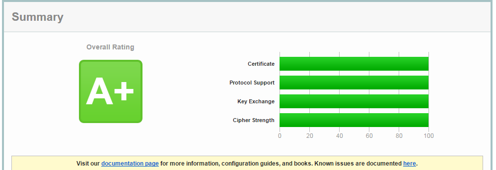

I have this score. nginx + Letsencrypt

@CHBMB: adding these lines into my "default" file were removing the security warnings:
        ### Add HTTP Strict Transport Security ###
add_header Strict-Transport-Security "max-age=63072000; includeSubdomains";
add_header Front-End-Https on;
I'm using Nextcloud 10.0 (stable) with the Nginx-letsencrypt container so that was really helpful.
What is the nginx directory within the Nextcloud container doing? My understanding is that it's not needed as Nginx-letsencrypt is doing the job? At least I can ignore the config files there?
Thanks a lot.
[EDIT] I am also getting the A+ on ssllabs. Good to know :-)
