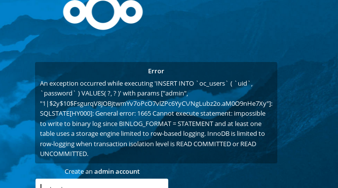

I need help cause i can't get this to work correctly. I had it working and then it messed up so i just didn't mess with it. Updated to 6.2 and tried to get this going and i am meet with this. (see attached)
I have remove, reinstalled, did not work, remove reinstall. over and over.
yes i have my binlog statement, i docker exec and fixed the custom.cnf files still get this error.
58aad81f93589_Screenshot_from_2016-10-01_232116.png.df463ca67180ce707232614a2bd62f80.png

had this issue myself until I added the custom.cnf file via telnet.
Don't know why it didn't work with notepad++ for me before.
Hope this helps for you aswell.

What are the file permissions on the custom.cnf file?
sorry this took a long while to reply to.
root@9ce0020c5a71:/config# ls -l
total 8
-rw-r--r-- 1 root root  3753 Oct  1 22:44 custom.bak.cnf
-rw-r--r-- 1 abc  users 3773 Oct  2 14:32 custom.cnf
drwxr-xr-x 1 abc  users  400 Oct  1 23:17 databases
drwxr-xr-x 1 abc  users   72 Oct  1 22:39 log
