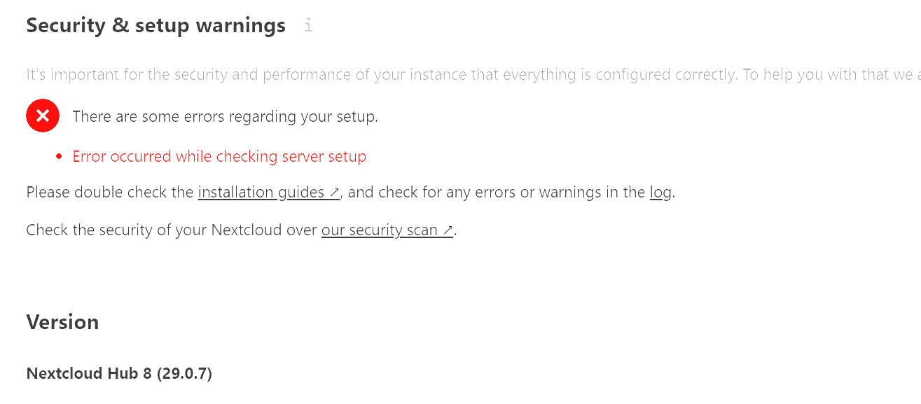

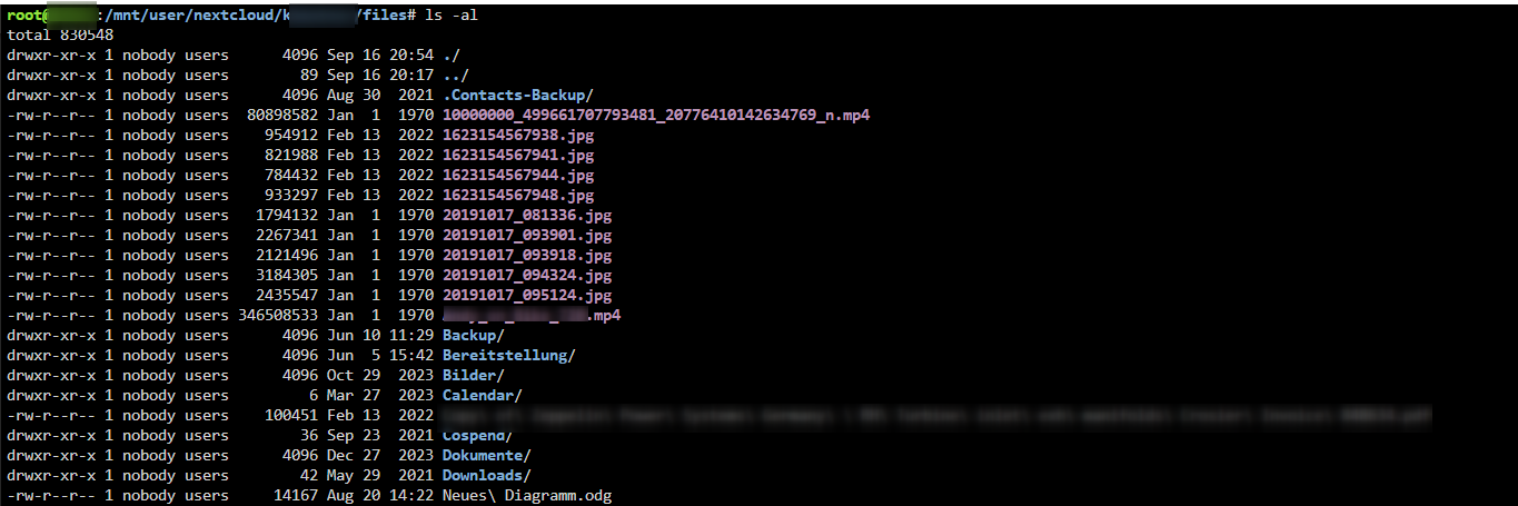

Dear all,
For some time now, no files have been displayed in the browser under “apps/files/files” (All files), only the current circle appears. Since today's update, however, this is also the case under “/personal” (personal files).
Under “/recent”, “/shareoverview”, “/tags” everything is still displayed correctly.
I have already carried out every conceivable file operation and maintenance operation. But this does not bring any changes.
Everything works perfectly in the app on the smartphone.
Do you have the same problem?
Have you done an occ files:scan --all?
Have you cleared your cookies and browser history?
You're not supplying sufficient information for people to respond, what do your logs state?

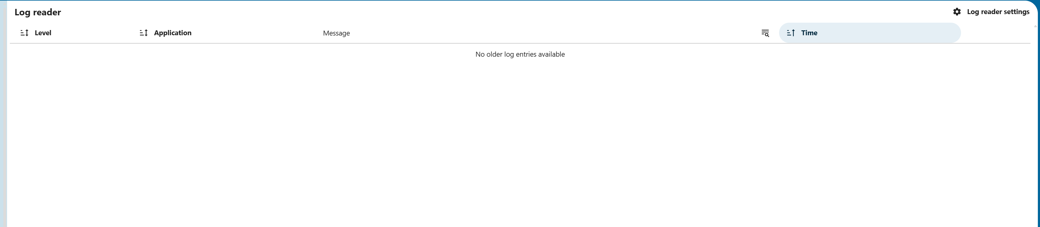

If I had a meaningful error message somewhere, then of course I would have dealt with it, but so far I haven't had one. Hence the general question.
As already written, I have already carried out all the occ operations associated with this several times:
occ files:celanup
occ files:repair-tree
occ files:scan-app-data
occ db:add-missing-indices
In each case without error message.
I have of course also deleted the cookies and tested them on devices that have never accessed the nextcloud.

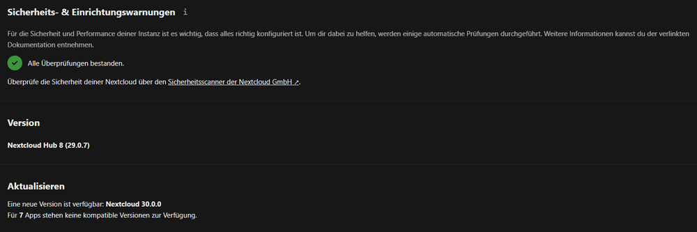

I will spare the output of “docker exec -it nextcloud occ setupchecks” here, as there are no anomalies there either.
I have Elasticsearch running in a separate Docker, but have already deactivated it for troubleshooting purposes.

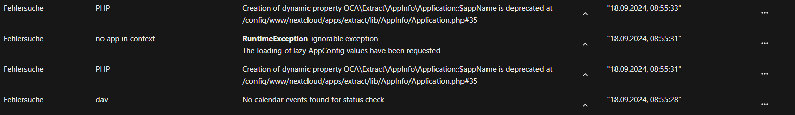

Something that appears again and again in the protocol, but was already there before:
I have now deactivated all apps again, but this has not brought any change.

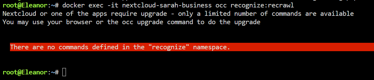

22 hours ago, Archonw said:
Maybe you can recreate this with:
occ recognize:recrawl

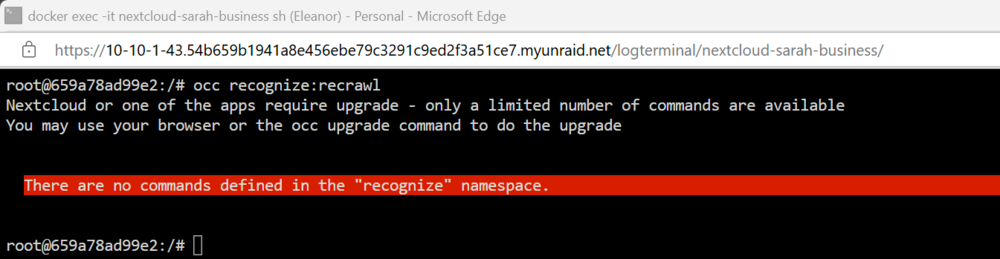

When I try that command it says "There are no commands defined in the "recognize" namespace. Would you happen to know what other command needs to be done with recognize?

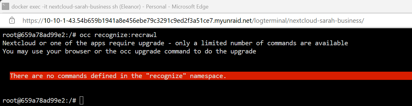

You appear to be trying to run the command from within the docker. You need to run it from Unraid CLI as a docker command.
Ie. docker exec -it [name of your nextcloud docker] occ
Try that, use the exact name of your Nextcloud docker.

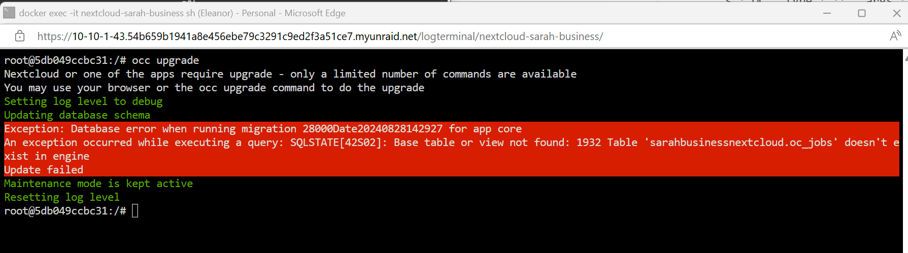

Ohh okay. I am runnign the repair in the console of the container and keeps giving me this.
I just did what you recommended and still got the same error.
I seem to recall you had a failed upgrade by trying to use the "latest label". I take it you can't restore previous versions of your database and nextcloud, which would be easier.
What happens when you type "occ upgrade"?
I would stop trying to use recognise:recrawl, that's not going to help you with your problem.

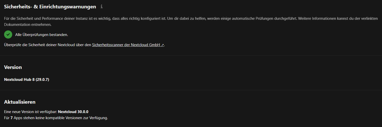

Unfortunately, this did not solve my problem, but I then realized that cron.php was not running correctly due to the backup app. I have now deactivated it so that cron runs correctly. And I have no more error entries in the log.
However, the problem with the files has still not been solved. And I suspect that it may have something to do with write permissions and owners. But why the problem is only occurring now is a mystery to me...

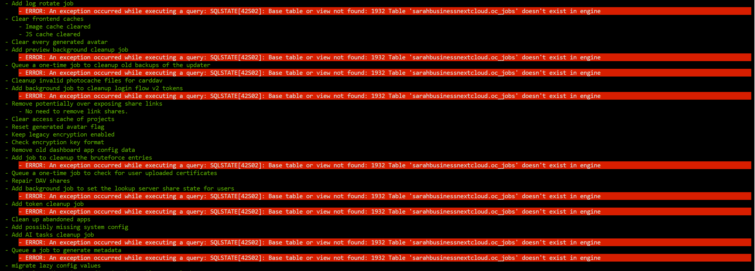

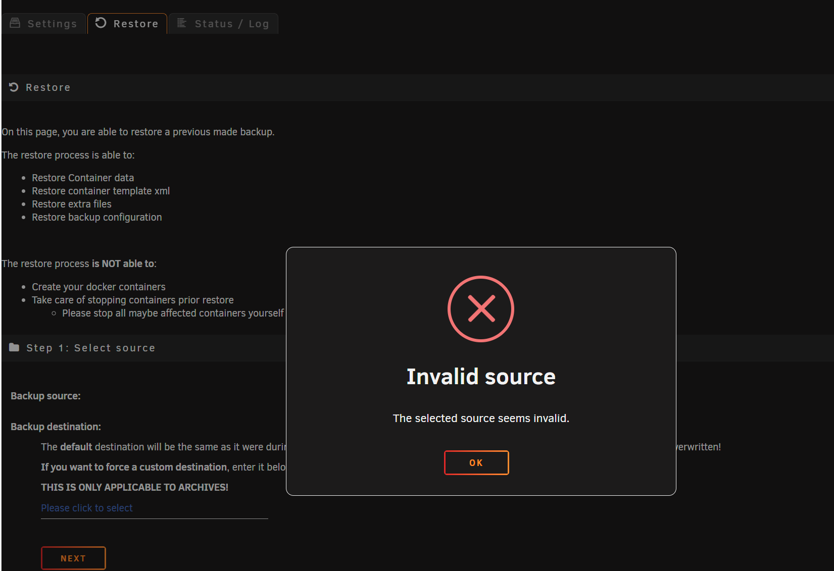

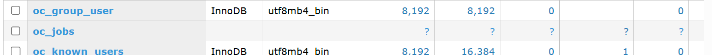

So, I have a backup and from the 9/8/2024 but for whatever reason Backup/Restore Appdata is giving me this error.
So, I was able to get the tar.zst file and get the OC_JOBS and place it on the current docker mariah database and the issue still persists. I change the permissions and the user for the file to be like if it was never changed, but didnt work.
The error says that the table does not exist in engine. Would that be the Nextcloud container instead mariadb database? I also did the OCC Upgrade like you said and get the same error.
Also, I tried to go to the same version 29.0.5.1 instead of latest and it does not work. I would think since I don't want to update it will work but it does not. I don't remember the error code though.
If you do a restore from backup, in this case I suggest you restore both the database and Nextcloud.
PLEASE MAKE SURE YOU HAVE BACKUPS OF ALL YOUR DATA. Its unlikely that you would lose anything doing the below, but better safe than sorry.
I'm also going to point out that I'm not an expert, but I've had similar issues in the beginning.
I think the issue you have, is that you've tried to upgrade Nextcloud from one major version to the next, which hasn't worked, but the database will have entries that have been partially upgraded. So you need to roll back both of them from a previous backup that was working.
Don't use the restore option for appdata unless you want to overwrite all of your appdata folder. You also may want to backup the current appdata, in case you mess up. Stop your Nextcloud and MariaDB dockers first. Plus Redis, Elasticsearch or any other dockers that are related.
So, if I have an issue with Nextcloud, I will do the following:
  1.  Manually extract the chosen backup's MariaDB (I'm assuming its MariaDB) and Nextcloud from the tar backup. Its easier to extract to a separate folder that you can delete later.
  2. Delete your appfolder's Nextcloud and MariaDB folders. If you don't, you're amalgamating files. (I normally delete the folders and extract the two folders directly into appdata, but I don't know what your experience level is, I'm keeping it simple).
  3. Move the extracted folders into appdata.
  4. Change your Nextcloud docker back to the tag that you were on before. If you don't know what I mean by this, then don't go any further and wait for it to install. If you use the wrong version, you're likely going to have a similar problem, as its going to be a mismatch. (could happen, not saying it will, depends on the version).
  5. I'm assuming that you didn't upgrade your MariaDB docker, so that can stay as it is.
  6. Start MariaDB first and any other containers that are related to Nextcloud. If you use Elasticsearch as a separate docker it should be up and running before Nextcloud. I've had Nextcloud fail to start with Elasticsearch down.
  7. Start Nextcloud and look at the docker log whilst its starting, for any errors.
  8. If its up and running, check the Admin overview page for any messages of errors and the main log file. Its likely that it will tell you to run an occ command in the overview page. If it does don't do anything yet.
  9. At the most, at this stage, run a database fingerprint command and a files:scan --all command. Both should be run after each upgrade, in my opinion. Otherwise you may not be able to see your files.
Once its up and running using the previous version, post back with more info. I would do those 9 steps without cutting corners. No. 8 is important to run the occ commands in the Admin overview page, but you may want to post first.

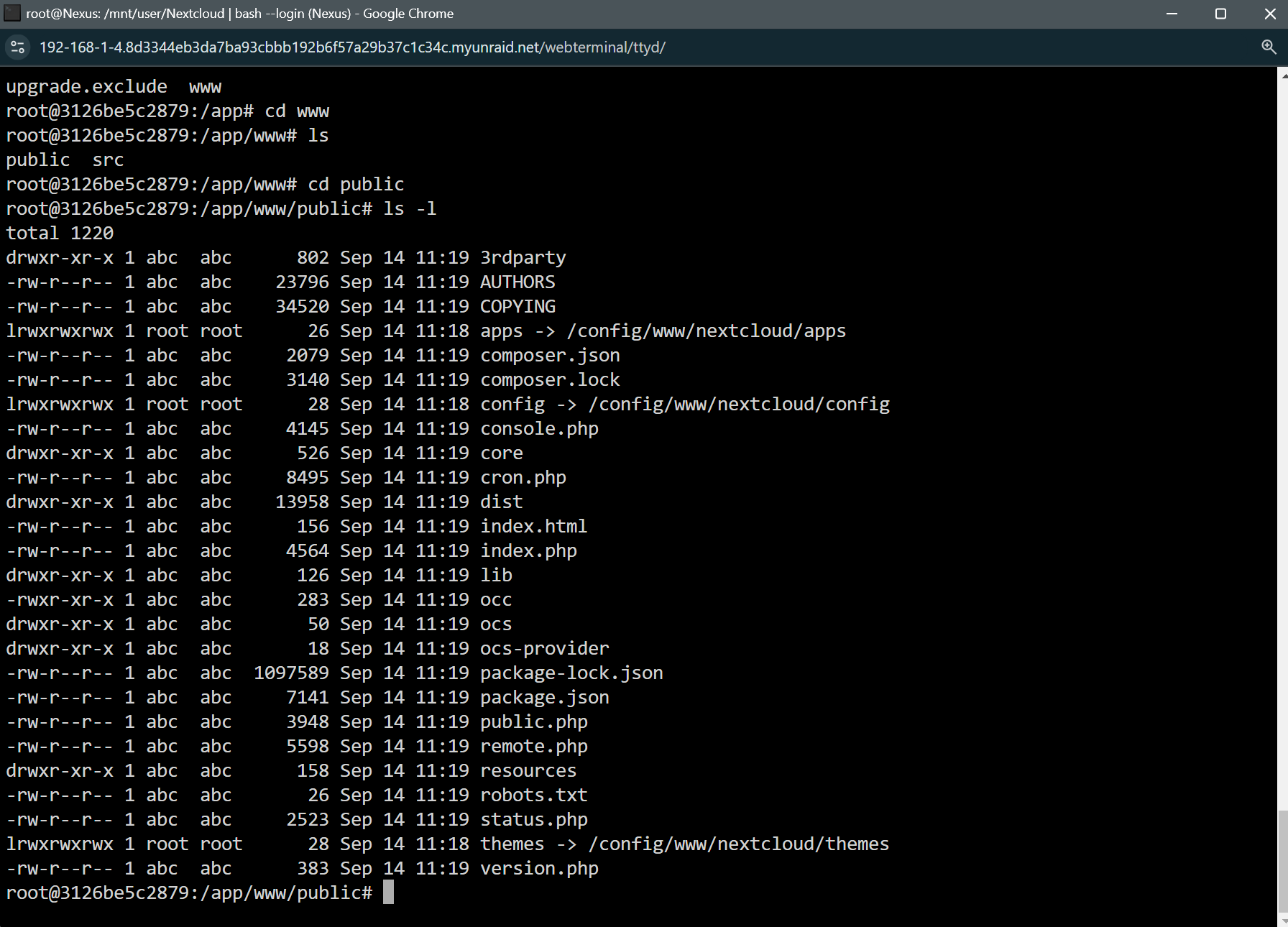

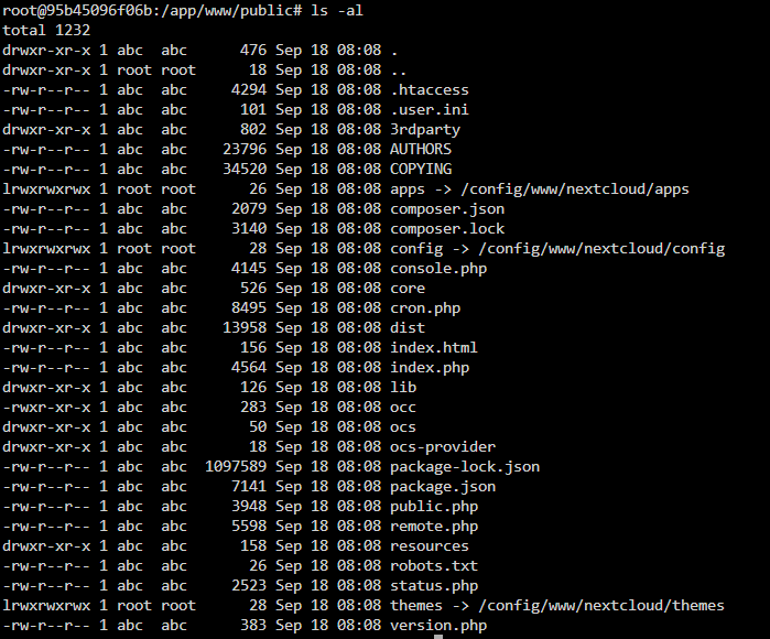

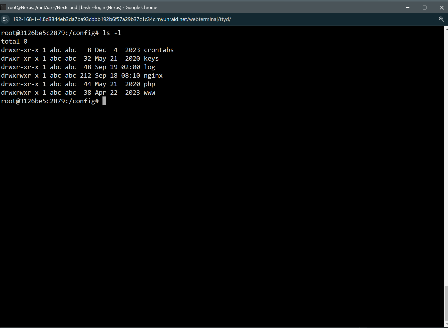

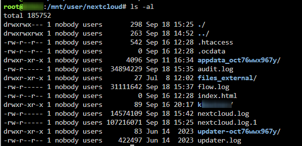

That's not the issue, here's mine. You generally don't have to play around in that folder anyway.
Here is the main folder in docker:
Personally, I would roll back to the previous stable version you've got and change the data folder permissions, then upgrade correctly. See my previous post to the other chap that is having issues, that should work for you as well. Assuming you have a decent backup of a working Nextcloud version that is recent and you follow all 9 steps.
You don't generally have to go into your docker, the important files are already under your appdata folder and in your Nextcloud data folder. Running docker exec -it "nextcloud" occ is generally all you need to do to manage the docker.

Thanks you for all your help. I dont see any errors. All I see is this on the setup warning page. I am currently running the occ files:scan --all.
Does't mean anything without logs or checking your setup. You need to get used to posting more relevant detail.
Use your new found powers to troubleshoot. Teach you to fish ;)
  1. Check your logs under admin to see what's being reported.
  2. Use the occ command to check your setup (look for the right command), it will tell you what's wrong.
Hint: Its one of the first commands in the help list.

I did check the logs and there are no errors or warning. Thats why I said they were no errors other than the one i posted.image.thumb.png.eba7834041727accdf2ac140e5c07620.png
Also, I have used both commands occ maintenance:data-fingerprint and occ files:scan --all. After running those commands, it looks good and how it used to be.
I am going to try these occ maintenance:mode and occ maintenance:repair tomorrow and see if I can get that error to go away. I really appreciate your help. Because of you i was able to get it back up and running. You rock man. Thanks.

I keep getting a 504 gateway when it goes to https://nextcloud.com/settings/ajax/checksetup. I have to look into it. Dude for real, thanks. I believe is my firewall blocking it. I have my network lockdown so most likely that.

I got some errors indicated when I checked inside Nextcloud like my trusted proxy setup would not be correct. It worked all the time but something seems to have changed with one of the updates recently. I tried to fix it and saw that a couple of config files seemed to be outdated and checked and saved the new ones. I didn't find any differences, though.
I get no errors after starting the dockers (mysql, nextcloud and swag) but when I try to access the webpage, it shows "500 internal Server error".
How can I find out what's wrong and how to fix it? I checked my config files but can't find anything wrong...

That's fairly generic as an error. Can you access your Nextcloud locally and are your clients still syncing, or are they showing as greyed out?
Can you post your log (not a screenshot), copy and paste it. You'll find it in your data folder. Post your config.php file as well (xxxx out personal / server info). Personally, I find these sorts of errors harder to resolve, as it could be serveral things.
I'm happy to have a look, although I'm pretty tied up and may not be able to respond immediately.

Thank you! Yes, it is. I can't access it from anywhere and my clients can't access the files neither.
Could you please specify which log you mean?
There are so many: Nextcloud.log (81 MB), nginx/error.log, nginx/access.log, ssl, etc.
