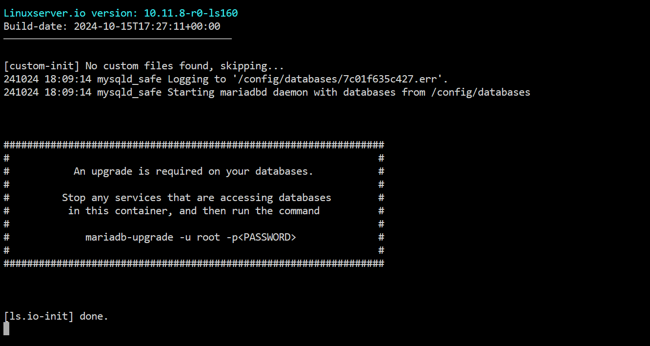

I'm guessing you upgraded MariaDB, but not the database itself. Can you restart your MariaDB and open the container log, it may state something like this:
Additionally, this is the latest that you need linuxserver/mariadb:10.11.8-r0-ls160.
I've literally upgraded my NC and MariaDB over the weekend and I only upgraded MariaDB because NC recommended it.
Try this and post the results if it looks like this is the problem. Otherwise continue below this line.

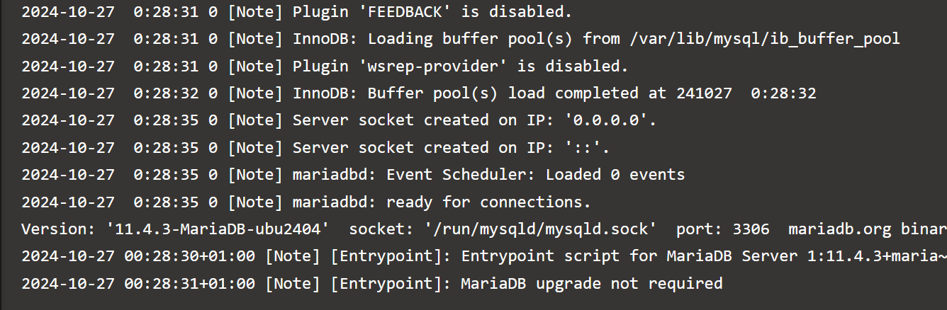

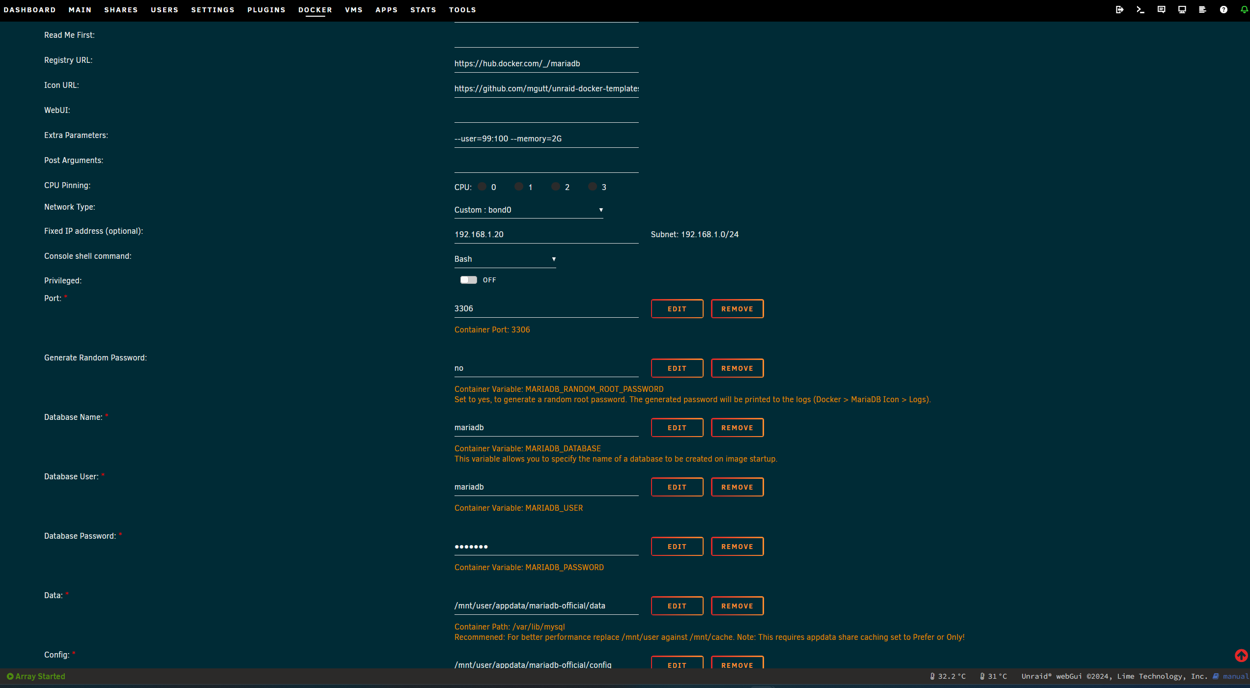

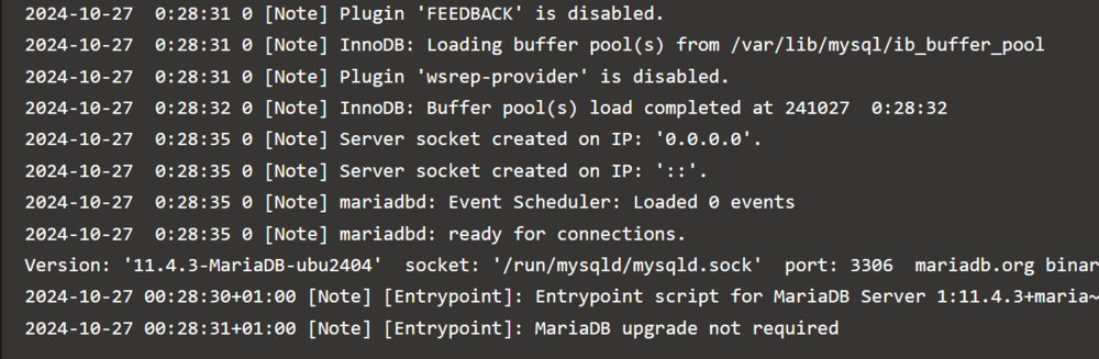

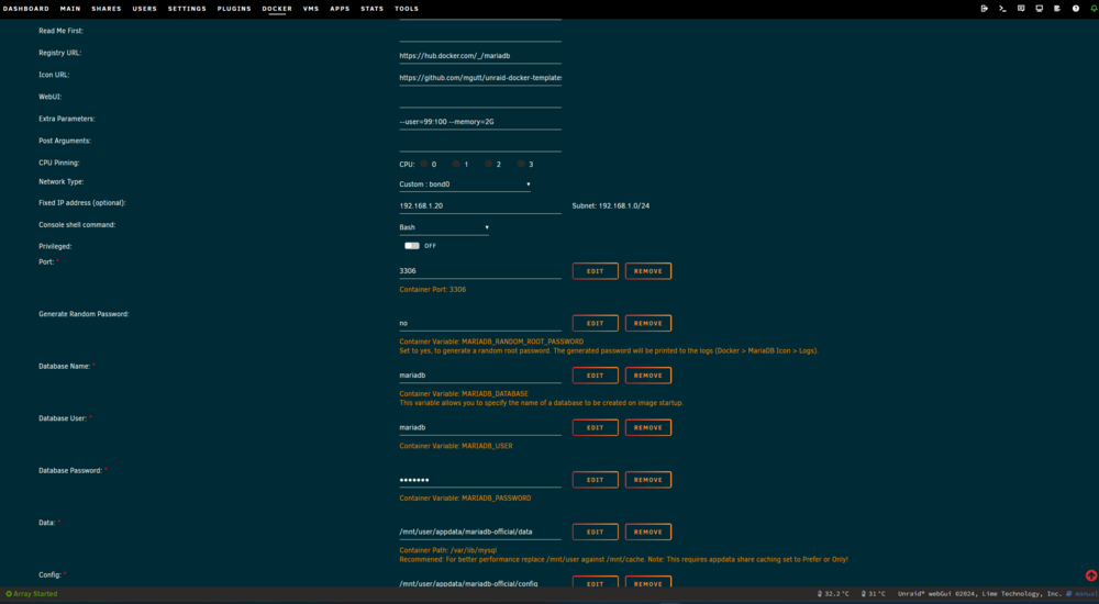

There was no upgrade message on mariadb.
Here are the logs of Mariadb:
2024-10-27  0:28:31 0 [Note] Starting MariaDB 11.4.3-MariaDB-ubu2404 source revision 5ab81ffe0097a22a774957df28c5223cf0201de3 server_uid owS8T8cVn3lSalbvembgIJMPZL0= as process 1
2024-10-27  0:28:31 0 [Note] InnoDB: Compressed tables use zlib 1.3
2024-10-27  0:28:31 0 [Note] InnoDB: Number of transaction pools: 1
2024-10-27  0:28:31 0 [Note] InnoDB: Using crc32 + pclmulqdq instructions
2024-10-27  0:28:31 0 [Note] InnoDB: Using liburing
2024-10-27  0:28:31 0 [Note] InnoDB: Initializing buffer pool, total size = 256.000MiB, chunk size = 4.000MiB
2024-10-27  0:28:31 0 [Note] InnoDB: Completed initialization of buffer pool
2024-10-27  0:28:31 0 [Note] InnoDB: Buffered log writes (block size=512 bytes)
2024-10-27  0:28:31 0 [Note] InnoDB: End of log at LSN=19514785312
2024-10-27  0:28:31 0 [Note] InnoDB: Opened 3 undo tablespaces
2024-10-27  0:28:31 0 [Note] InnoDB: 128 rollback segments in 3 undo tablespaces are active.
2024-10-27  0:28:31 0 [Note] InnoDB: Setting file './ibtmp1' size to 12.000MiB. Physically writing the file full; Please wait ...
2024-10-27  0:28:31 0 [Note] InnoDB: File './ibtmp1' size is now 12.000MiB.
2024-10-27  0:28:31 0 [Note] InnoDB: log sequence number 19514785312; transaction id 7625654
2024-10-27  0:28:31 0 [Note] Plugin 'FEEDBACK' is disabled.
2024-10-27  0:28:31 0 [Note] InnoDB: Loading buffer pool(s) from /var/lib/mysql/ib_buffer_pool
2024-10-27  0:28:31 0 [Note] Plugin 'wsrep-provider' is disabled.
2024-10-27  0:28:32 0 [Note] InnoDB: Buffer pool(s) load completed at 241027  0:28:32
2024-10-27  0:28:35 0 [Note] Server socket created on IP: '0.0.0.0'.
2024-10-27  0:28:35 0 [Note] Server socket created on IP: '::'.
2024-10-27  0:28:35 0 [Note] mariadbd: Event Scheduler: Loaded 0 events
2024-10-27  0:28:35 0 [Note] mariadbd: ready for connections.
Version: '11.4.3-MariaDB-ubu2404'  socket: '/run/mysqld/mysqld.sock'  port: 3306  mariadb.org binary distribution
2024-10-27 00:28:30+01:00 [Note] [Entrypoint]: Entrypoint script for MariaDB Server 1:11.4.3+maria~ubu2404 started.
2024-10-27 00:28:31+01:00 [Note] [Entrypoint]: MariaDB upgrade not required

Just noticed this. There is an issue with your MariaDB config.
I dont see where the error is in that? Which line?

 and attached is mariadb container page

Its 12am here, I'm clocking out but I've had a quick look.
Your config looks okay to me. Your MariaDb didn't look right in your last post. Server socket created on ip 0.0.0.0 is the line I was referring to. Sorry, wasn't able to circle it and was rushing to the door.
It doesn't look like its receiving its IP.
I may be wrong, but that may be worth looking at. If this has happened before without reason, perhaps there is an ip conflict on your network.

nope thats normal its listening to all interfaces in the container. other apps I use like darr services all run on 0.0.0.0 internally and then unraid exposes on the bridge interface. If it was not listening then all apps would break. I use the same DB for 3 other apps and only NC has problems since NC was updated few weeks ago.
Yeah, you're right. I'm out, let us know hie you get on.

21 hours ago, nekromantik said:
 my error is connection refused not exception
has anyone come up with a solution? i've tried everything suggested and even tried restoring an old nextcloud instance from a backup. Even with the restore it still somehow shows it has to upgrade :
Initializing nextcloud 30.0.1.2 (this can take a while) ...
Upgrading nextcloud from 29.0.3.4 ..
then fails to connect to maria, which is confirmed working and the other apps i have that use it are fine.  I can't believe that mariadb would be too new? then why push an update if thats the case?
Latest 29 is 29.0.8, while upgrading from an older 29 to 30.0.1 should work if you haven't kept up with uprates and try to do jumps it's always going to be a less tested/more error prone situation.
Don't know/think that's the problem, but in any case whatever mariadb container you'd be using is completely independent from NC.
You cannot roll back NC, without rolling back the database as well. The database tables have been updated for the latest version of NC. I've written about steps to take when you roll back within the last couple of pages.
To me, what appears to be common amongst you guys with the same issue is using the lastest version of MariaDB, which is above what NC states is supported (if I recall correctly, I don't have time to review it). I'm using the latest version of v10, with absolutely no issues and I've only recently upgraded it.
