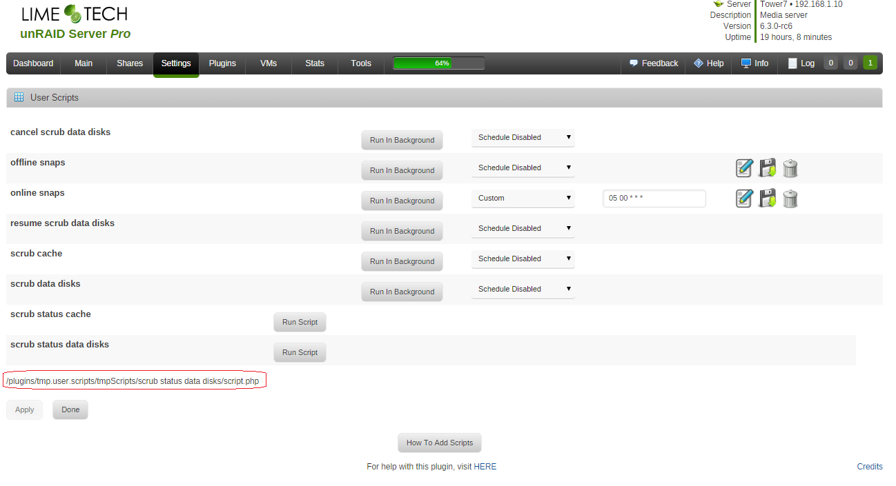

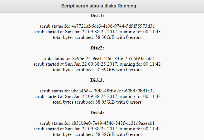

Quick question, I have a very simple script to display the cache scrub status so I don't need to keep refreshing it or go to the console:
while true; do
    sleep 20
    btrfs scrub status /mnt/cache
    echo
done
Any way to clear the log so that it only displays the last status, instead of one after other:
scrub status for b675e964-7944-4715-9bb9-0425685b4e13
scrub started at Sun Jan 15 14:48:31 2017, running for 00:20:11
total bytes scrubbed: 1.37TiB with 0 errors
scrub started at Sun Jan 15 14:48:31 2017, running for 00:20:31
total bytes scrubbed: 1.39TiB with 0 errors
OK.  Here's a demonstration script (but it'll do what you want).  It requires user.scripts 2017.01.21a+ to work and shows a demo of directly utilizing javascript within a script to manipulate html DOMs, etc
A new variable called directPHP has been added to signal to the UI to run the script in this override mode.  I do not recommend any one using this variable in their own scripts without PM'ing me first.
Assuming a base folder of /boot/config/plugins/user.scripts/scripts/test you will need the following files:
/boot/config/plugins/user.scripts/scripts/test/script
#directPHP=true
#description=Demonstration of directly running javascript within the output.
$updateTime = 1000;                                                              # time between updates in milliseconds
$supportExec = "/boot/config/plugins/user.scripts/scripts/test/scriptExec.php";  # Change This To Suit.
$unRaidvars = parse_ini_file("/var/local/emhttp/var.ini");
$csrf = $unRaidvars['csrf_token'];
exec("cp $supportExec /usr/local/emhttp/plugins/user.scripts/scriptSupportFile.php");
exec("chmod +x /usr/local/emhttp/plugins/user.scripts/scriptSupportFile.php");
echo "
  <script src='/webGui/javascript/dynamix.js'></script>
  <span id='output'></span>
  <script>
  $(document).ajaxSend(function(elm, xhr, s){
    if (s.type == 'POST') {
      s.data += s.data?'&':'';
      s.data += 'csrf_token=$csrf';
  var URL = '/plugins/user.scripts/scriptSupportFile.php';
  var Interval = setTimeout(updateDisplay,$updateTime);
  function updateDisplay() {
    $.post(URL,{hasTo:'beHere'},function(data) {
      if (data) {
        $('#output').html(data);
  </script>
and
/boot/config/plugins/user.scripts/scripts/test/scriptExec.php (Note that this file must be formatted with linux style line endings.  Windows style line endings will not work here)
<?PHP
  $command = "btrfs scrub status /mnt/cache";  # Bash Command/script To Run... Change To Suit
  $output = shell_exec($command);
  $output = str_replace("\n","<br>",$output);
  echo $output;
EDIT: Adjusted script to maintain compatibility with future versions of unRaid
