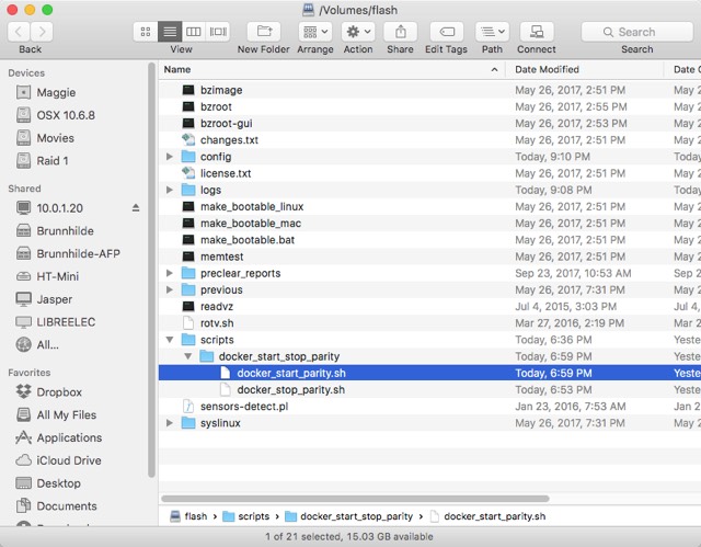

Can't get it to work when I set the schedule to "array start". It locks up the webUI completely if I stop and then start the array. Also triggers an unclean shutdown warning from FCP.

file path to scripts-
I checked the start/stop scripts from CLI and they work as expected. If I use the "background" button the User Scripts Plugin shows the script as "Running". Not sure what I'm missing here? I've attached a diagnostics as well.
brunnhilde-diagnostics-20170929-2108.zip
Been trying different options, but none seem to work. If this script is set to run at array start the array fails to start. It just hangs. Tried adding the background only option but no luck. The only way I can get the script to run is to manually launch it in the background.
ok.  Can't test everything when I did the script itself.
Save that script on the flash drive in your scripts folder as parity_test.php (make sure that it's CR not CRLF)
Add a script to user scripts that is:
#!/bin/bash
/boot/scripts/docker_start_stop_parity/parity_test.php &
Setting it to run at array_start should now work

Thanks squid. I think that worked. At least the launcher ran at array start. Guess I'll find out about the background docker start/stop script when my next parity check starts in a couple of days. Coming from you, I'm sure there won't be any issues with it either.  8)  :D
