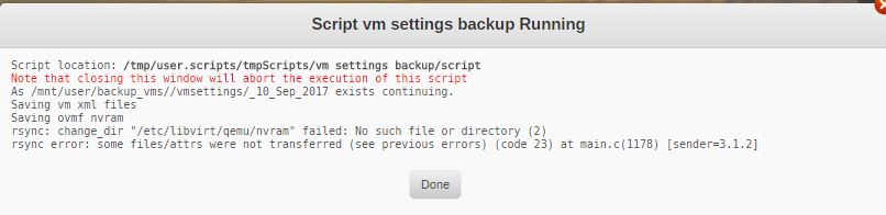

Hi guys,
I'm trying to make a backup of my VM's but I don' know for sure if it's working or not. I used the script backup VM and I get a error.
How can I resolve his one?
Looks like it worked, but there was no nvram to be saved.
