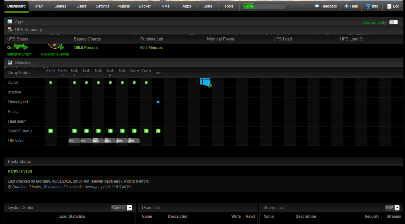

Upgraded to 6.2 RC3 and I get the follwing error on my VM screen. I only have one VM (Windows 10) and it start and runs fine but I am not able to edit or do any modification to the VM. I can see a new path was added with the update and the error looks to be referencing the new path but not sure what I need to do to correct the problem.
Warning: libvirt_domain_xml_xpath(): namespace warning : xmlns: URI unraid is not absolute in /usr/local/emhttp/plugins/dynamix.vm.manager/classes/libvirt.php on line 936 Warning: libvirt_domain_xml_xpath():
Also noticed that everything on my dashboard is arranged crazy and I cannot click on anything. See attached photo.
