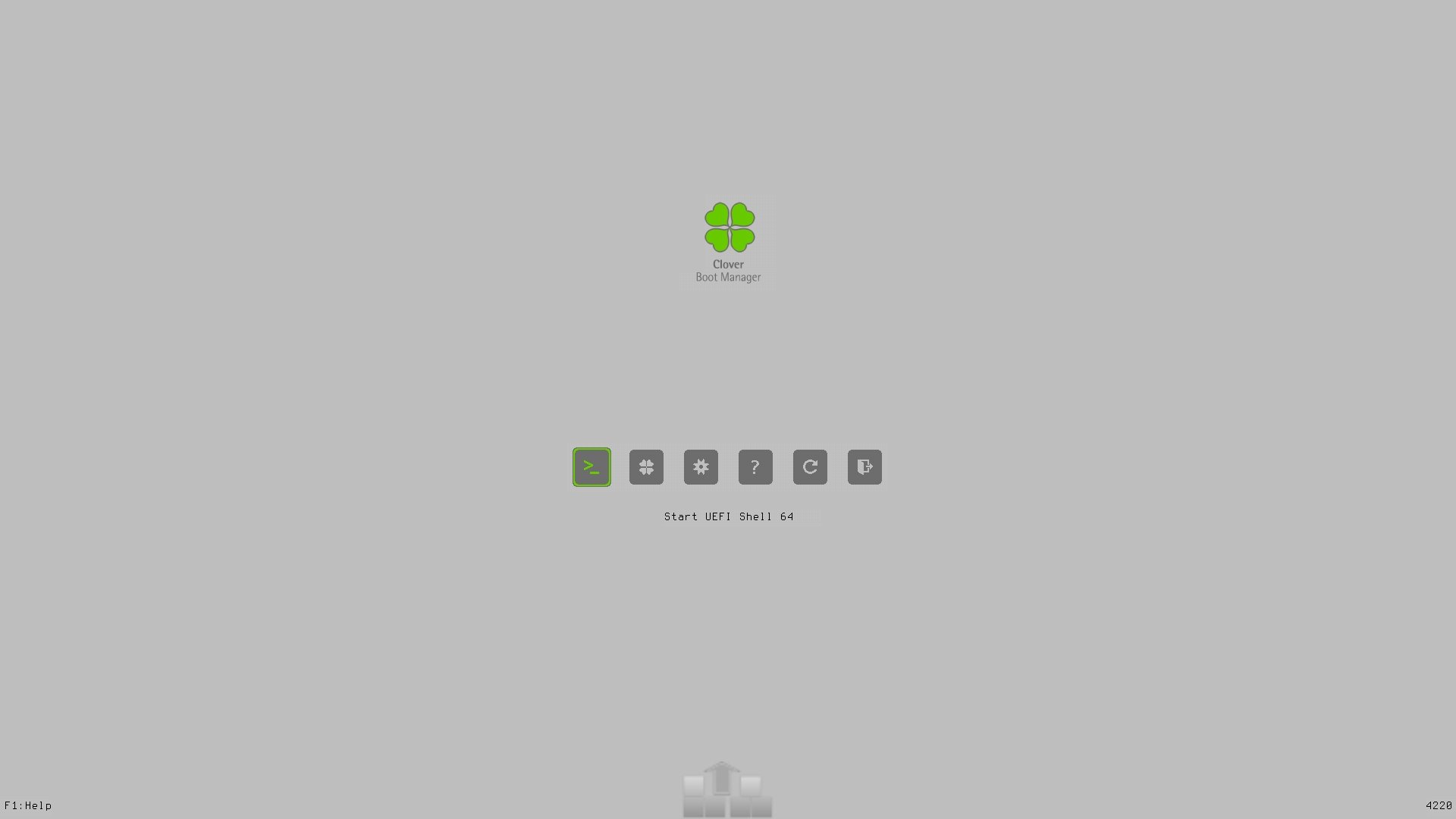

@gridrunner sorry about the osk key i totally forgot about it.
thank you for your help i really appreciate it.
so i've made all of the changes as suggested other than -
    <boot dev='hd'/>
if i add that line i get the following -
but without that line it's still not completing the boot

Hello all,
I've been trying to install it for a few days. After trying different versions of clover (including the latest 4522, the one used by our beloved @gridrunner 4200 and some in between), the volume just won't show up in clover. Any idea why? I think I followed the guide of making a installer down to a t, except for the Fakesmc.kext as I am using the osk key.
(Two things I am not sure, first, I don't seem to see APFS and HFSPLUS in the customize install session clover 4522, is that normal? Second, there is a osxaptiofix3drv-64, should I use it instead of osxaptiofix2drv-64?)
Edited by windlok1010
Yea  APFS and HFSPLUS will not be on there you will have to add it in manually.
Thanks. I was afraid that clover will install it by default and conflict with these manually installed files. For the record, I did manually add them.
