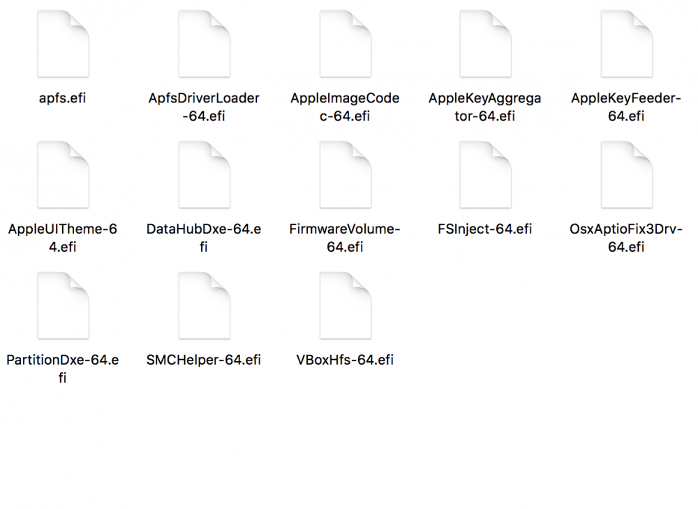

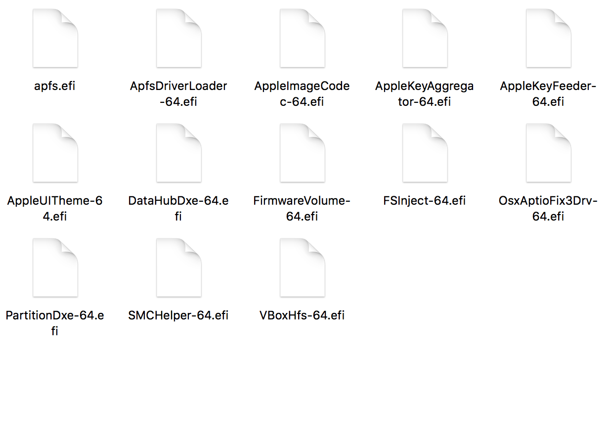

Just finished a new install of Mojave using latest clover and modified version of @SpaceInvaderOne‘s original vid. The vm survives reboot multiple times so probably correctly setup. I’ll post how I managed it shortly.
Needless to say, I’m skipping out on 10.13.6!
There may be some unneeded drivers/steps, but I'll leave that for the pros to figure out.
You need:
Mojave installer
SpaceInvader's OS High Sierra Support files (from high Sierra installer vid/usb creator vid)
Clover 2.4k_r4674
USB of at least 8GB
Following the usb creator video (and using utils included with download), make usb with Mojave in replacement of High Sierra
Clover install:
Using Clover 2.4k_r4674
Follow video on specifying where to install.
Customize:
Check the following:
UEFI only
Install Clover in the ESP
-Under UEFI Drivers
AppleImagecodec
AppleKeyAggregator
AppleKeyFeeder
AppleUITheme
DataHub
FirmwareVolume
FSInject
SMCHelper
VBoxHfs
ApfsDriverLoader (I’m not 100% sure you need this, as it says its for 10.13, but I checked it and mine installed, so it doesn't seem to hurt)
OsxAptioFix3Drv
PartionDxe
Screenshot shows all contents of drivers64UEFI folder from working Mojave vm, confirming what was checked/installed. apfs.efi copied over later.
378938774_ScreenShot2018-09-24at5_21_41PM.thumb.png.e0f83af5cd35976f458ebb63575c891d.png
Install clover on Mojave install disk/drive
Follow video to mount efi (if not auto mounted)
Copy apfs.efi (may not be needed, but as noted, my install works and survives rebooting.)
Copy fakesmc (I put it in the 10.14 folder as well as “other” just for good measure)
Copy q35.acpi
Copy config.plist as described in video
Follow high Sierra install video.
I installed with 8GB ram and 4 threads.
I used qemu 3.0 (on unraid 6.6.0)
When it comes to clover install portion, follow video but using newer clover instead, then copy the clover folder from installer disk to vm.
That's about it. I couldn't have wandered into getting this running without the previous work of @SpaceInvaderOne who will undoubtedly make a much cleaner install video in the near future!
Edited by 1812
