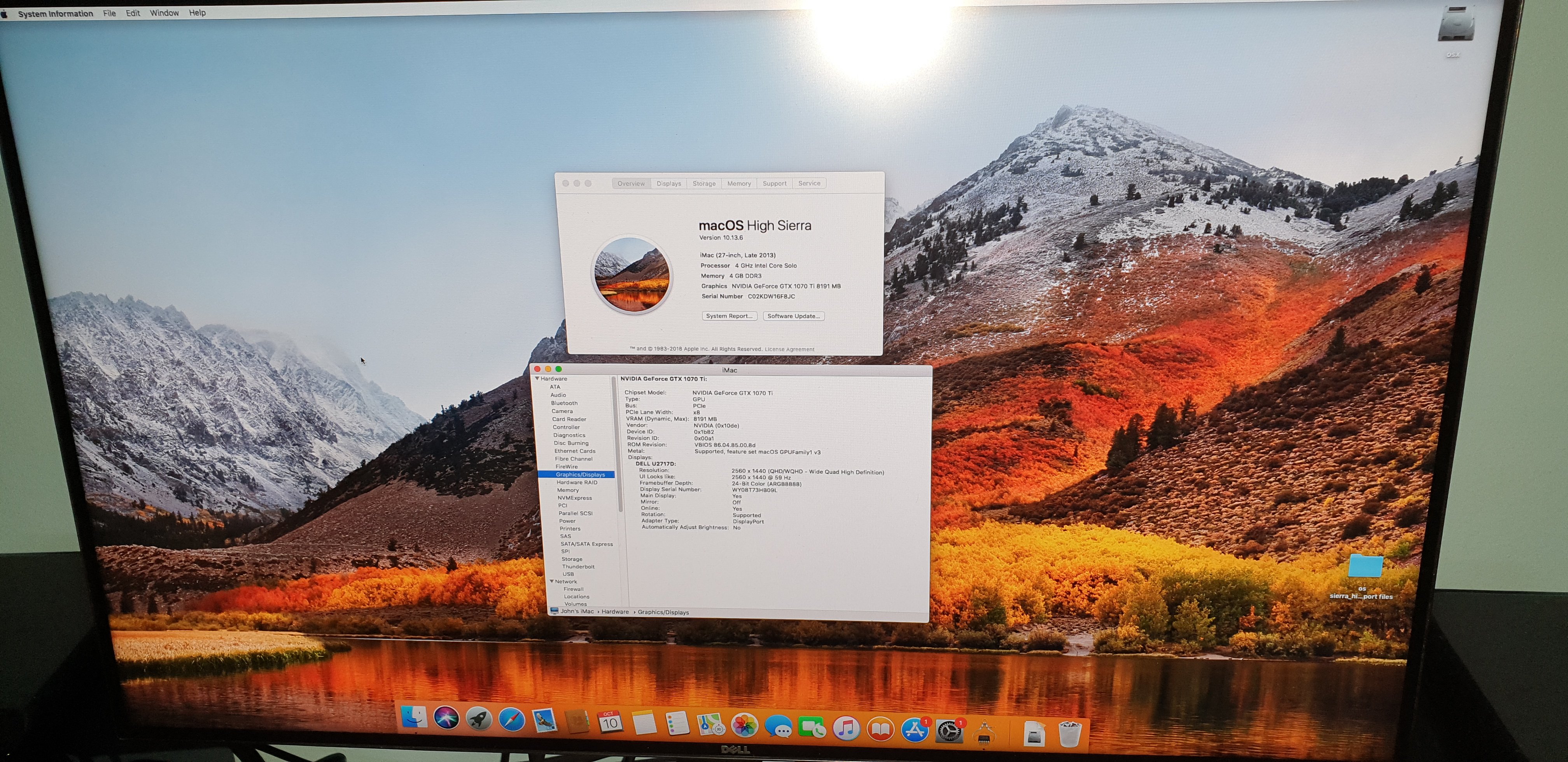

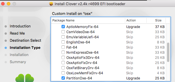

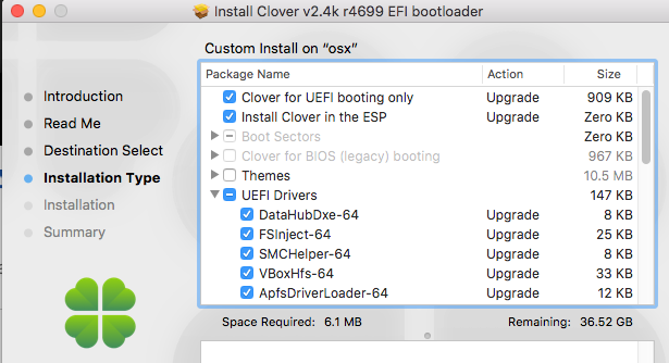

So basically I used clover r4699. Mac OS High Sierra 10.13.6 downloaded from the App Store, but using a third party tool as I can't search High Sierra anymore, I guess due to Apple pushing people to use Mojave now.
Below is how my clover looks like before installing to the EFI partition while the thumb drive is being prepared. I did not use the two kext file spaceinvader used in his video.
Im also using APFS file system, and ensured GUID partition table was used for the thumb drive and also the partition I created on my SSD for the OS vdisk.
After its up just I followed spaceinvader's guide to use clover configurator to prepare the config.plist before installing the latest Nvidia web driver for my specific build (based on my About Mac)
As for audio, I just got  VoodooHDA installed as I just couldn't get the AppleALC to work with it. VoodooHDA works well though with the built in related on the x399, although it can crackle at times.
My only issues currently are it can get to a suspend state if I leave the VM idle for too long, and have to use unraid VM menu to resume it. Apart from that Geekbench does not seem to complete, it gets stuck at memory copy for over 15 minutes, before I decided to cancel it. It was causing all my  VM assigned cores to get maxed out at 100%
My XML is attached too for what its worth, you may notice I removed the topology line, with that line not removed you have to use a "proper" amount of cores assigned like 4 cores or else it will continuously reboot and not get to the installation screen. Got that info from a few pages back.
