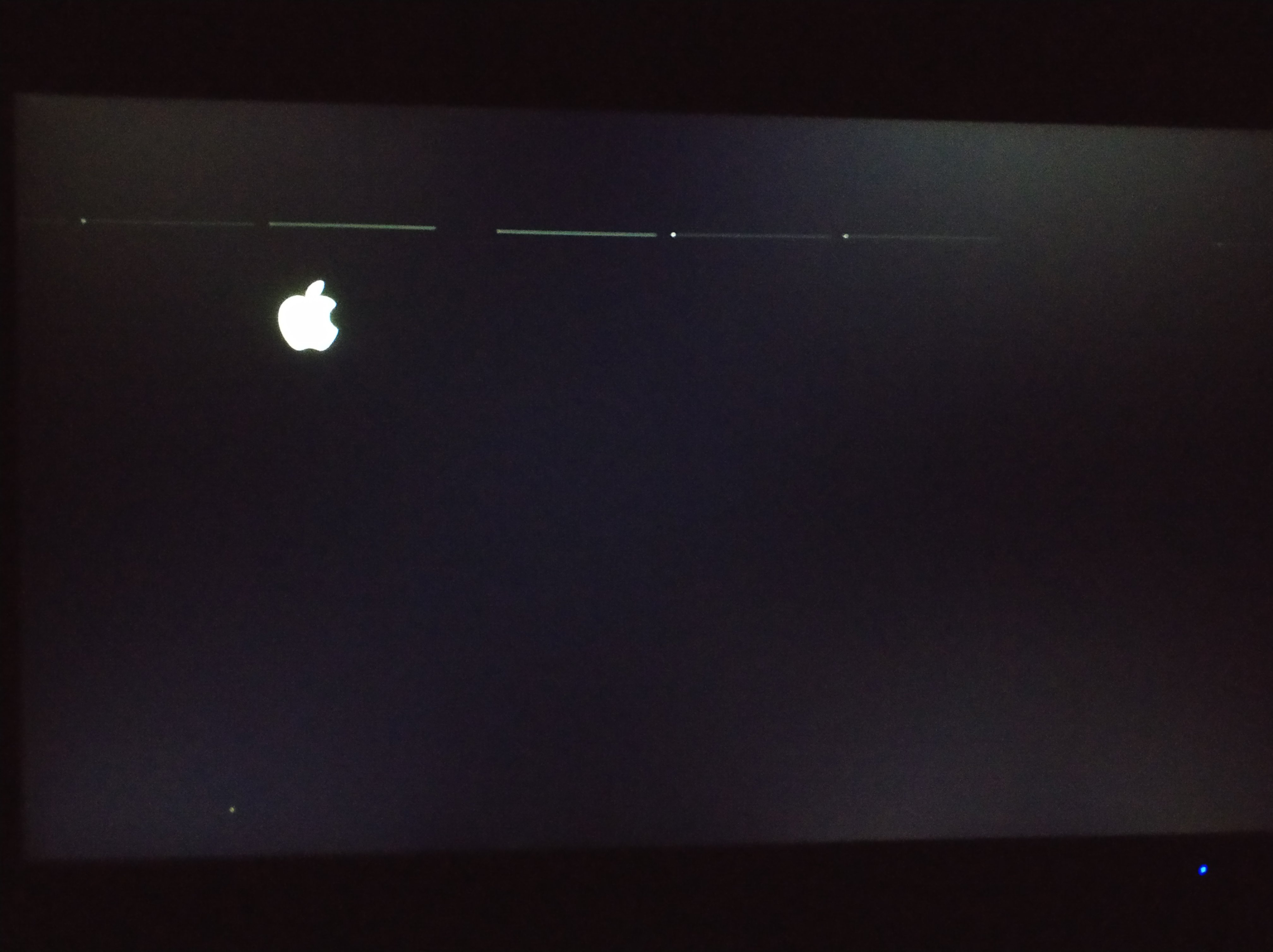

Tried mac 10.15.1 with the custom amd patches today and this is as for as i can get. Remove the cpu qemu arg line and added a topology. Updated to 0.5.2.
1937900281_Screenshotfrom2019-10-3012-07-31.thumb.png.082b4137b588956bb05ca7c139ec341b.png
Well i fixed that and now all i get is a apple with no progress bar. Anything i should add to the qemu args. I removed the -cpu line and its args.
You can't remove qemu custom cpu args.'kvm=on' and 'invtsch must be passed in this way, it is a QEMU bug. without this MacOS and opencore won't get TSC frequency correctly.
Ok i got it to boot using this.
<qemu:arg value='-cpu'/>
    <qemu:arg value='EPYC-IBPB,kvm=on,+invtsc,+avx,+avx2,+aes,+xsave,+xsaveopt,+ssse3,+sse4_2,+popcnt,vmware-cpuid-freq=on,'
I know i can remove the vmware line. Anything else i can get rid of on this line? Just to make it cleaner.
