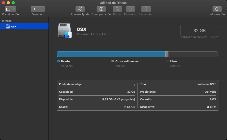

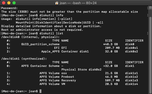

After downloading catalina I'm unable to install because I have not free space on hd.
I have increased vdisk with this command:
"qemu-img resize /path_to_vdisk/vdisk1.img +15G"
and I can see on unraid vdisk has increased from 30 to 45GB.
Inside my mac vm I can only see
But how do I increase the hd inside mac os?
Thankyou
Gus

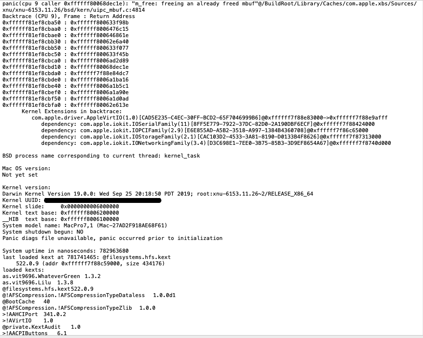

To use smbios macpro7,1 I must keep the MCEReportDisabler.kext into my /Library/Extensions otherwise I have kernel panic.
virtio not working for me (I'm not investigating why), have to use vmxnet3.
This the kernel panic for virtio:
I also have a notification from the os: "Memory Modules Misconfigured: More than the maximum supported memory is installed in your Mac"
Is there a way to map the ram slots as for example for what we do with the topology line for the cpu? I have 16GB ram in this vm.
Edited by ghost82
