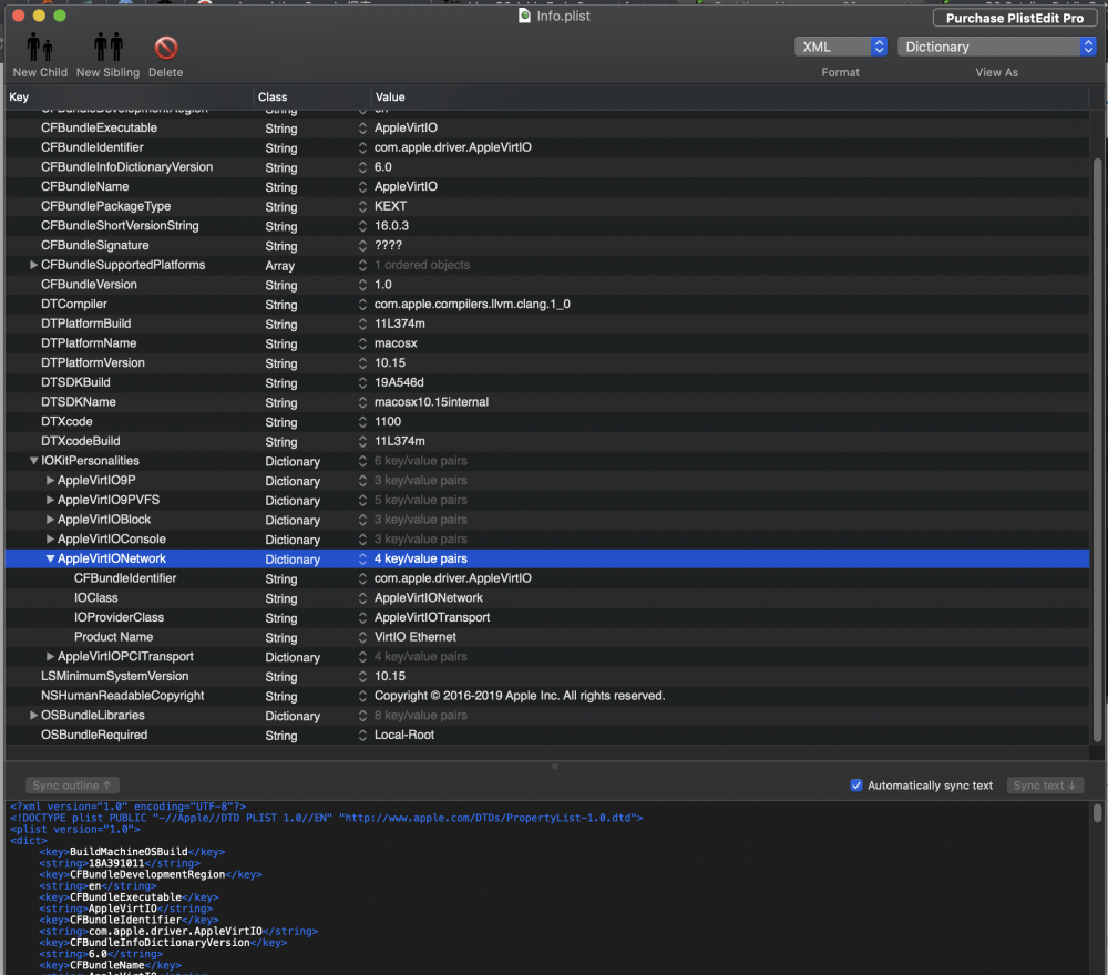

I also find virt-net is support in catalina, but when I add a virtio-pci-net in unraid webui xml the vm crashed.
So I hope it will support properly in later version then we can get 10G even 100G network support for our VM.

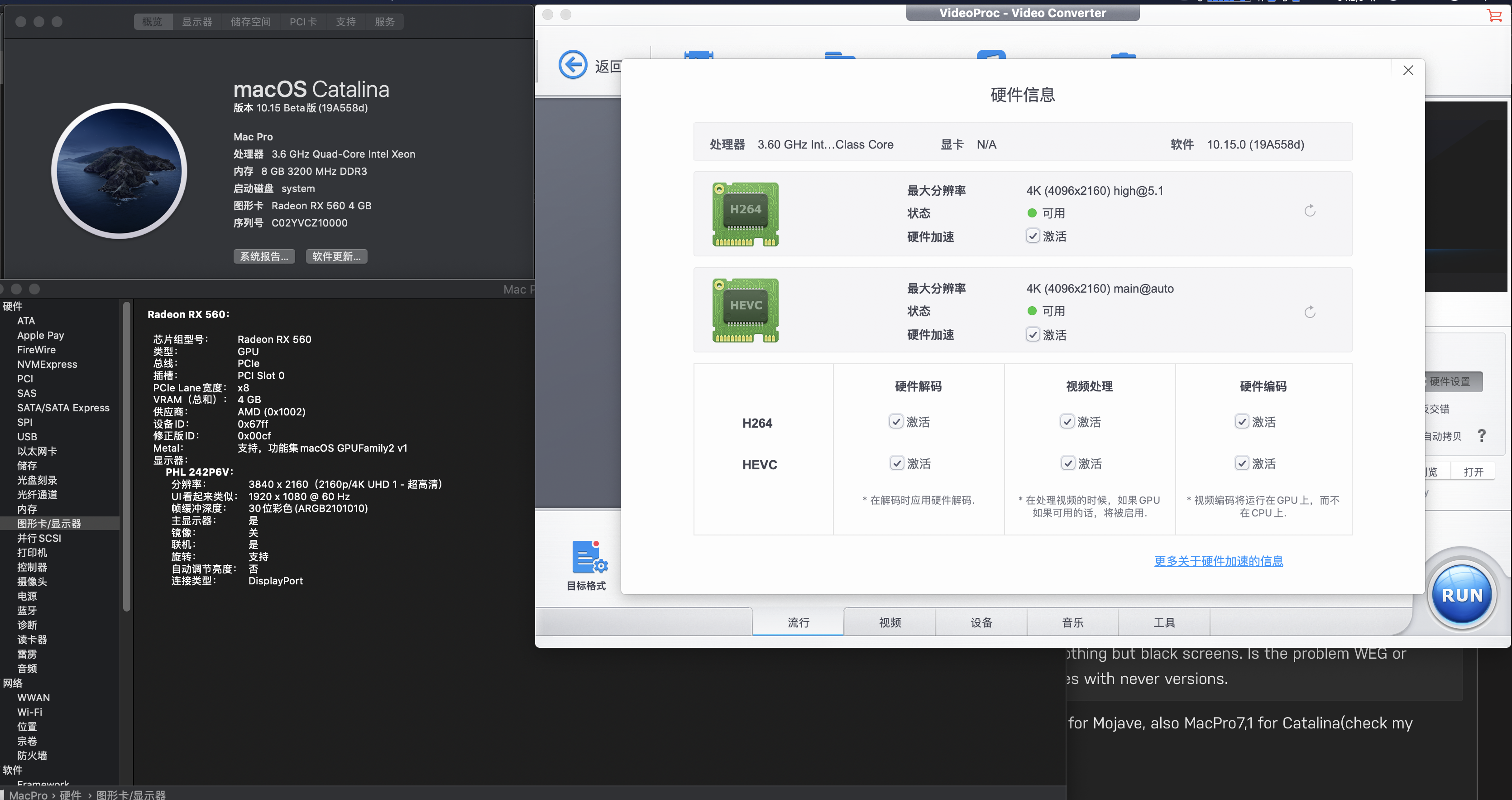

some steps to make rx560/570/580 works natively in mojave and catalina to support hevc/h264 hardware acceraltion without IGPU:
  1. change your SMBios to iMacPro1,1(mojave) or MacPro7,1(Catalina)
  2. select ACPI --> Add DTGP in clover:add some method in acpi for later use.
  3. select ACPI --> FixDisplay:  in order to change your grahpic to gfx0
  4. select KernalAndDriverPathes --> Black Screen Patch Vega 56/64, RX580 etc. (c)Pike R. Alpha: fix blackscreen issues
  5. (Optional)If not work, then add LILU/WEG to you kexts directory.
Here are some screen shots about my VM:

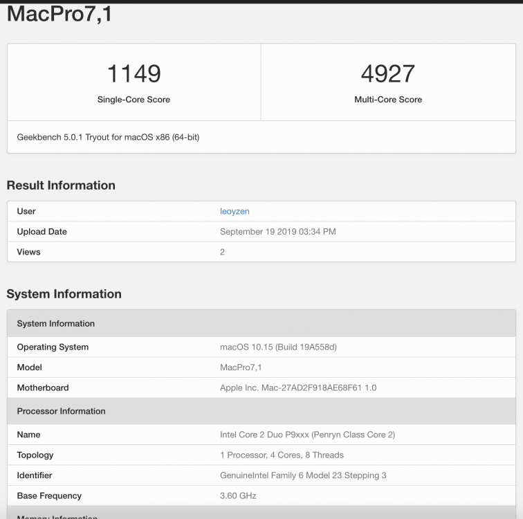

Geekbench 5 with 4 cores/ 8 threads of my 3700x:

It is strange, I'm using 3700x and passthrough 4 core 4 thread into the VM, and I've got 1100+ single core and 9000+ multicore score.
Does "Meta support" enables for you ? You should find the information in "about my mac ---> System Infomation ---> Grahpics" .
It may cause the performance problem.
