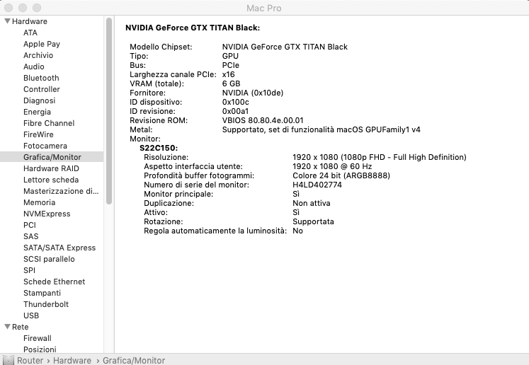

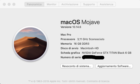

Just an update about MacPro7,1 smbios and gpu passthrough.
I have gtx titan black which work out of the box (without the need to install additional drivers), but maybe it is necessary to patch AppleGraphicsControl.kext (if you experience a "no-signal" to the monitor after the apple logo).
I used AGDPFix 1.3 to patch AppleGraphicsControl.kext but this was not enough since /System/Library/Extensions/AppleGraphicsControl.kext/Contents/PlugIns/AppleGraphicsDevicePolicy.kext/Contents/Info.plist doesn't contain any specification for the MacPro7,1 (Board-ID: Mac-27AD2F918AE68F61)
So add this line to the Info.plist in the ConfigMap section:

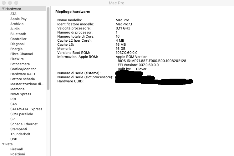

Do you have metal acceralation support?MacPro 7,1 added in catalina so there is not config in mojave.
BTW, why your process shows 'Sconosciuto'?
Acceleration: yes, it seems to be ok
Yes, I know, mac pro 7,1 has not been officially released and it will run with catalina, so this explains why mojave lacks infos.
"Sconosciuto" means unknown, the processor is not recognized (I have 2x e5-2687w in my main board): it's only cosmetic, I patched in the past, then reinstalled the os, but since it's only cosmetic I don't mind to read Sconosciuto.
Edited by ghost82

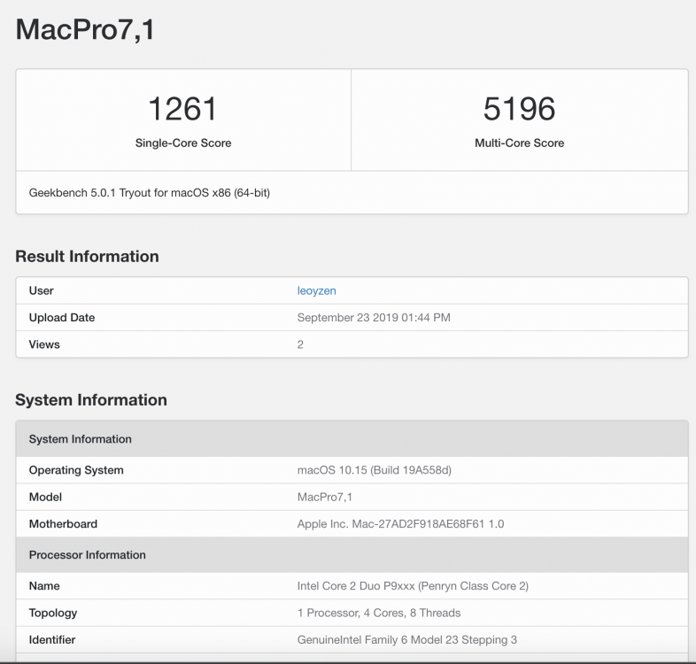

  3. gpu benchmark compared to bare metal computer?

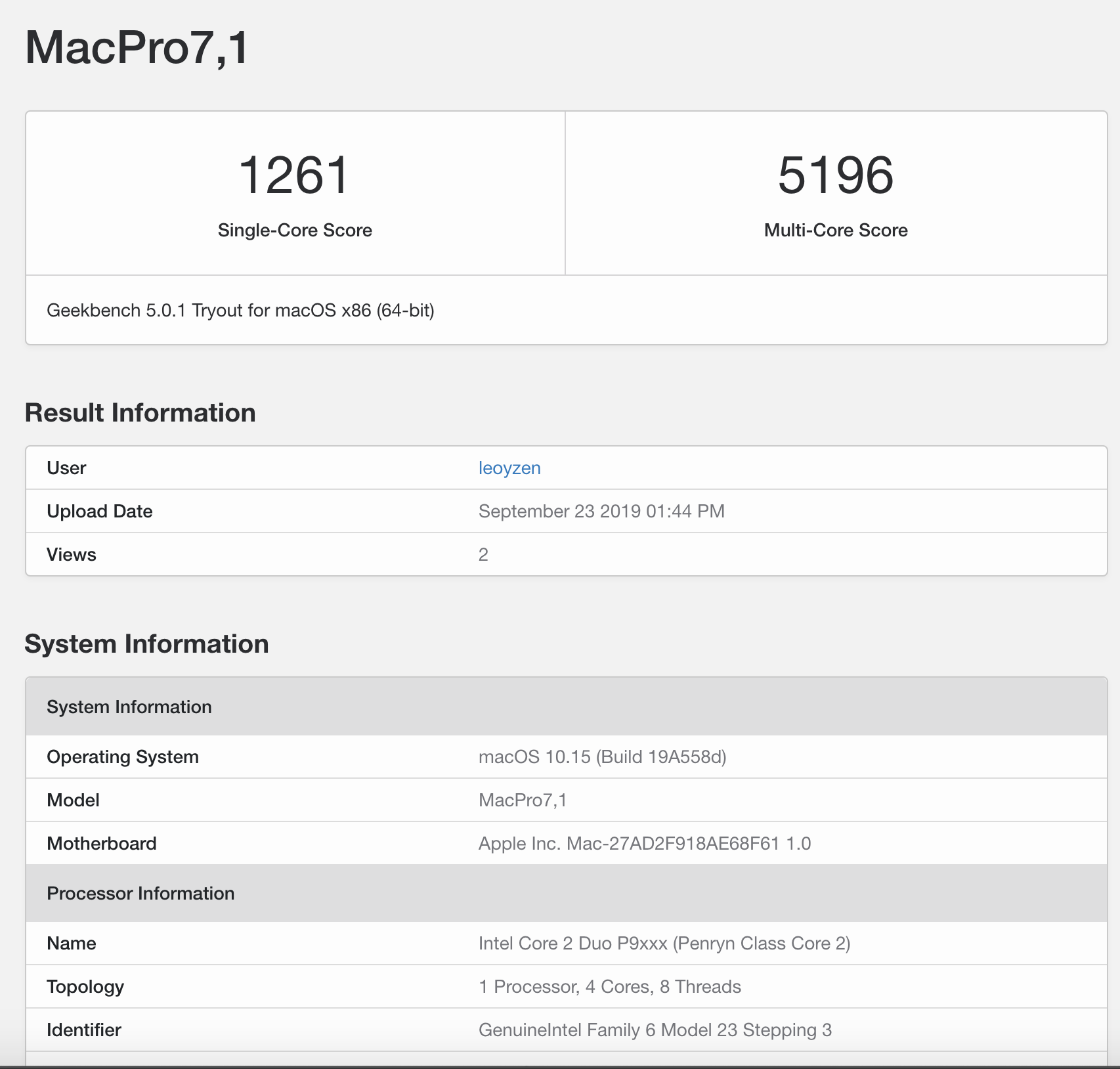

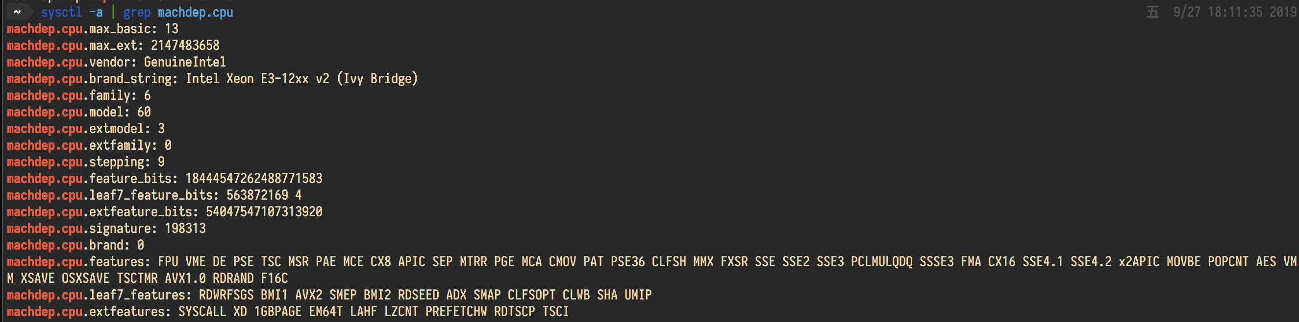

BTW, I add cpu features as much as possible, finally I get nearly same score (1200+ singlescore) from my windows. I don't know which feature is more important so I add them all.
Penryn,vendor=GenuineIntel,+hypervisor,-erms,+invtsc,kvm=on,+topoext,+svm,+invtsc,+fma,+mmxext,+avx,+avx2,+aes,+xsave,+xsaveopt,+ssse3,+sse4_2,+popcnt,+sse4a,+bmi1,+bmi2,+arat,+abm,+3dnowprefetch,+adx,+clflushopt,+cr8legacy,+fsgsbase,+fxsr_opt,+misalignsse,+movbe,+osvw,+pclmuldq,+pdpe1gb,+rdrand,+rdseed,+rdtscp,+sha-ni,+smap,+smep,+svm,+vme,+xgetbv1,+xsave,+xsavec,+ht,+clwb,+umip,+xsaves,+extapic,+ibs,+skinit,+tce,+wdt,+topoext,+perfctr-core,+perfctr-nb,+amd-ssbd,+wbnoinvd,check
Edit 2019.09.26:

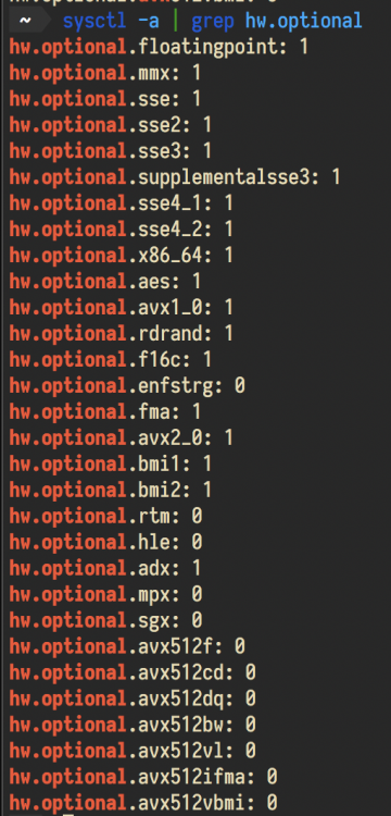

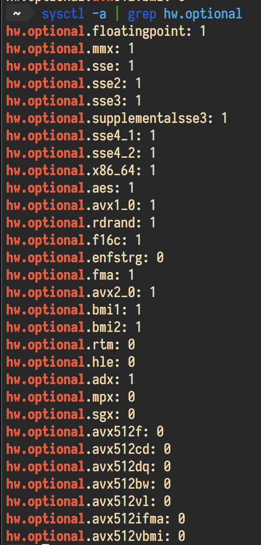

It is also IMPORTANT to set fakecpuid to get avx2/bmi1/bmi2 etc recognized by MacOS(mention from here).
You can just set cpu model from Penryn to IvyBridge and remove topology from xml, this works too.
You can check with "sysctl -a|grep hw" or "sysctl -a|grep cpu" or "sysctl -a|grep avx" to see if the feature correctly recognized.
It will get better performance (for me, the system boots faster than before).
Edited by Leoyzen

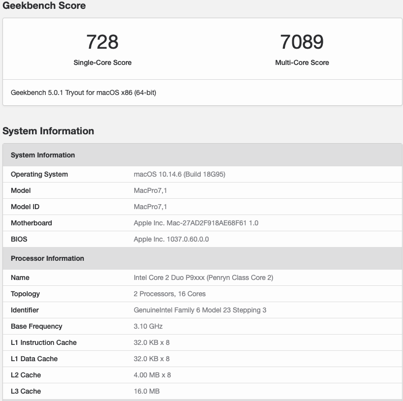

Here are my results:
CPU benchmark
OSX Mojave VM (Unraid): Single core score: 728 - Multicore score: 7089
Windows 10 native: Single core score: 743 - Multicore score: 7973
Comments: quite happy with the results
GPU Benchmark
OSX Mojave VM (Unraid): Score (metal): 25246 - Score (opencl): 8866
Windows 10 native: Score (opencl) : 23575 - Score (CUDA): 19605 - Score (Vulkan): 21994
Comments: Metal is ok, but I have a big difference for opencl...mmmm
Unfortunately my cpus (E5-2687w) cannot manage these features.

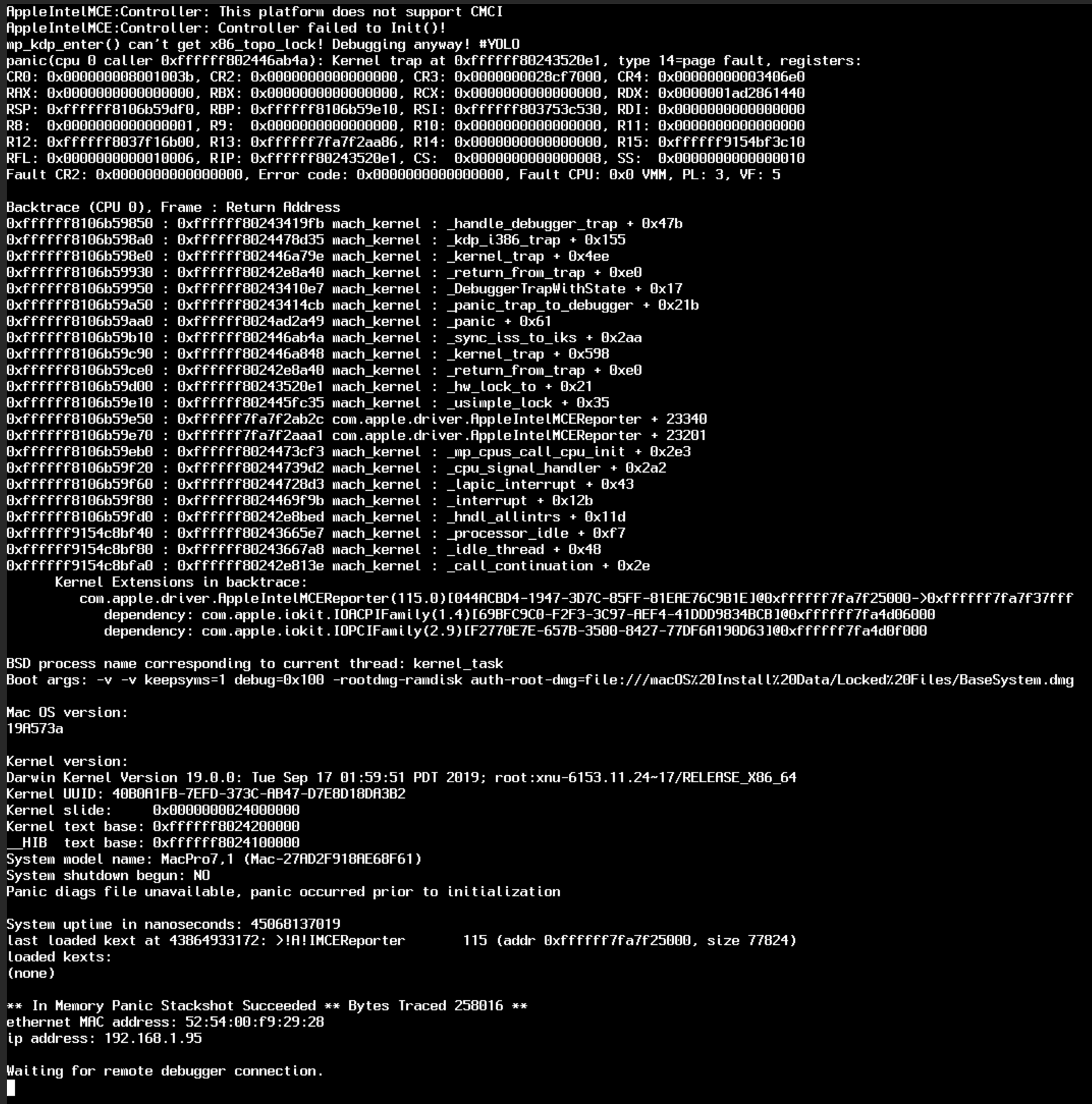

Heads up about the new Catalina beta today. I got nothing but hard reboots during the install when trying to install using the 7,1 or ImacPro smbios. Thats using clover 5090. Had to go to 18,3 smbios for the update to go thru.
Edited by david279

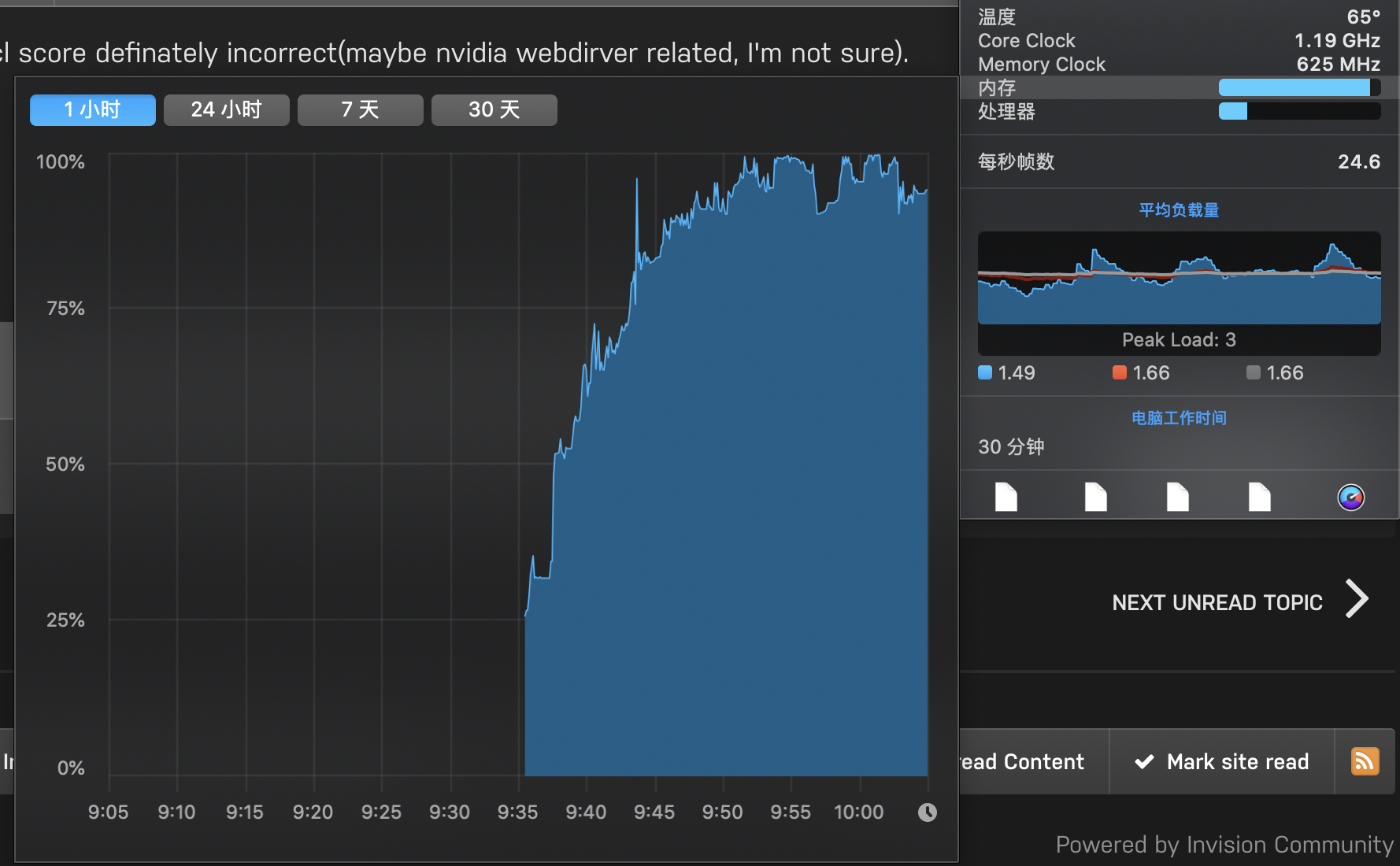

@ghost82 I use iStats Menu to monitor graphic die/mem frequency and mem usage, and manually monitor the fan by my eyes =0=
@david279 I face the same problem before when installing catalina using iMacPro1,1 then I switched to MacPro7,1 and it works. It is sucks if as you said the newest update got the same problem. I have no idea what the error is, seems some cpu feature check?May need some patch to make it work.
The full error log, seems mce support broken?
2019.09.24 20:41
I found the similar issues from here, so maybe use latest Lilu and CPUFriend can avoid this panic. I will try later and report back. @david279
2019.09.24 22:33
Lilu and CPUFriend not work as expected, I dont familar with Lilu/CPUFriend, so maybe someone test again and give some feedback.
iMacPro1,1 and MacPro7,1 are important for those who use hackintosh in VM and want to get native GPU HW acceralation.
2019.09.24 23:38
I've found a solution to disable AppleIntelMCEReporter when using iMacPro1,1 or MacPro7,1 by using the kext from here.
You can download the kext from attachment then unzip the kext into clover/kext/other folder then reboot
MCEReporterDisabler.kext.zip
Edited by Leoyzen

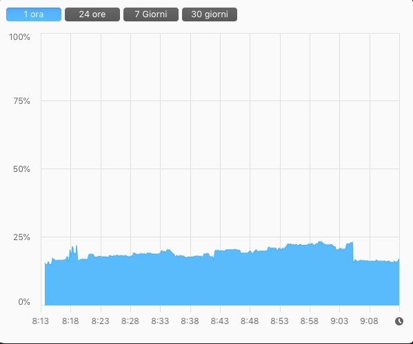

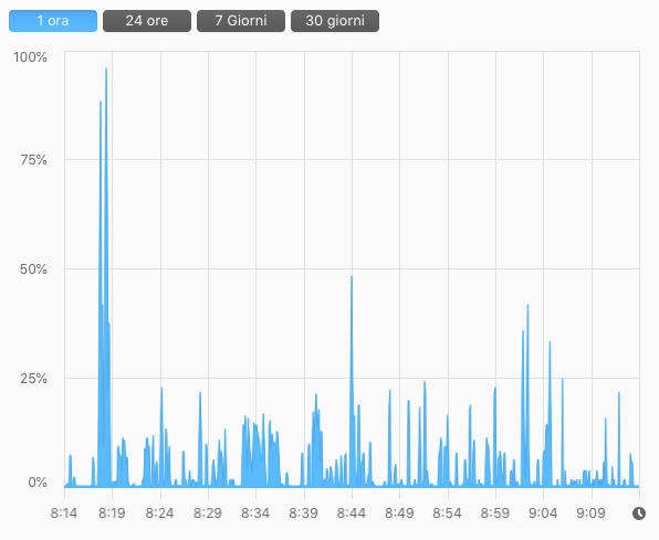

Ok, I did some more tests:
- GPU memory seems ok, it ranges between 15% and 20% for "regular activity" (total memory 6Gb) and it frees without problems
- GPU fan seems ok too, it spins (not at full speed) from the start of the os
- GPU frequency seems ok too
GPU memory:
GPU frequency (peaks refer to geekbenchmark tests and some blender usage)

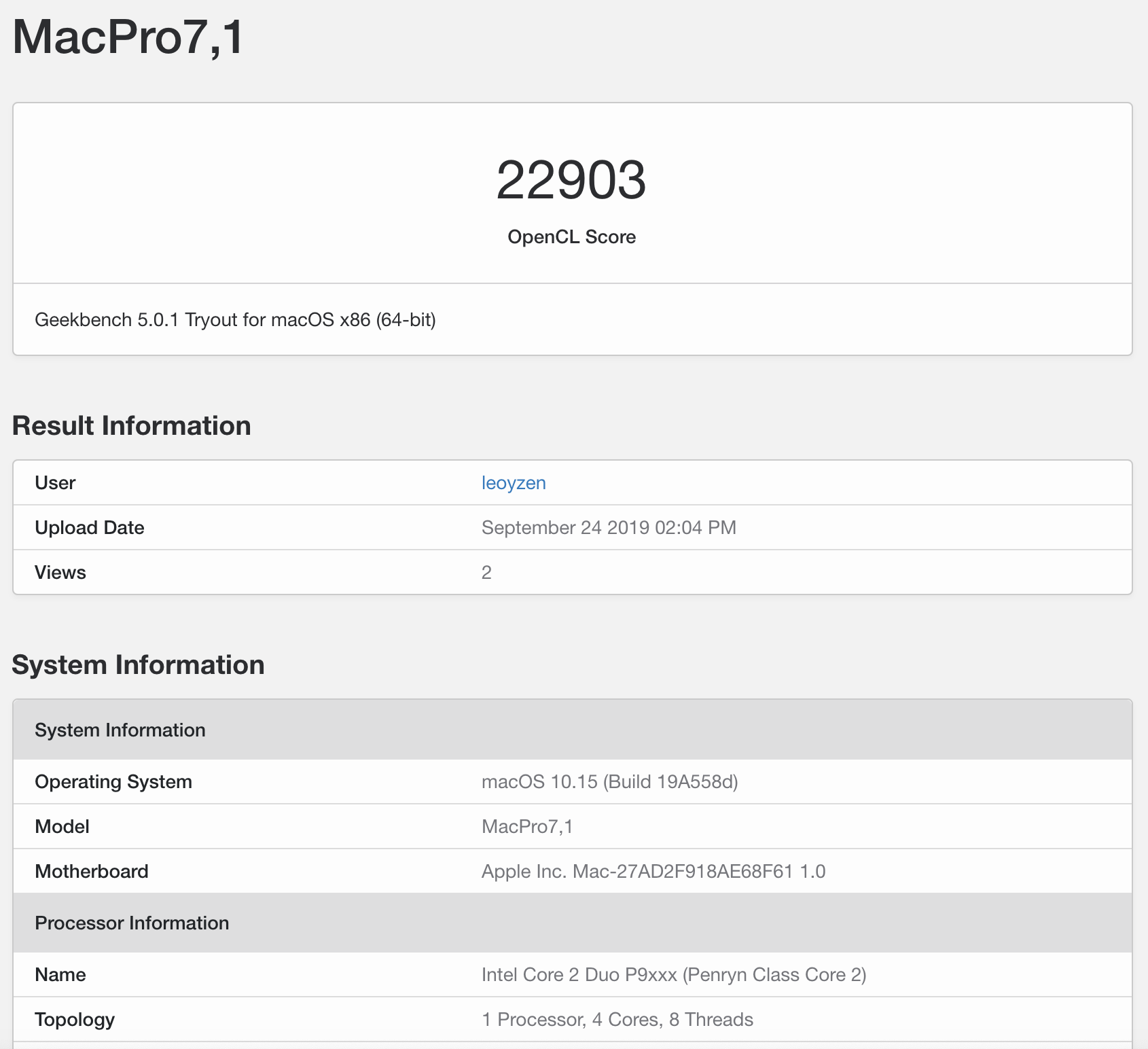

What about your opencl benchmark? Did you get consistent results with metal benchmark? I read somewhere this is regular, somewhere else it's not ok.
Edited by ghost82
@ghost82 My RX580 get 22k+ score so your opencl score definately incorrect(maybe nvidia webdirver related, I'm not sure).
My GPU memory always get full and fan not spin up untils get 70+ degrees, I don't know if it pm related issues or bios related even AMD related....

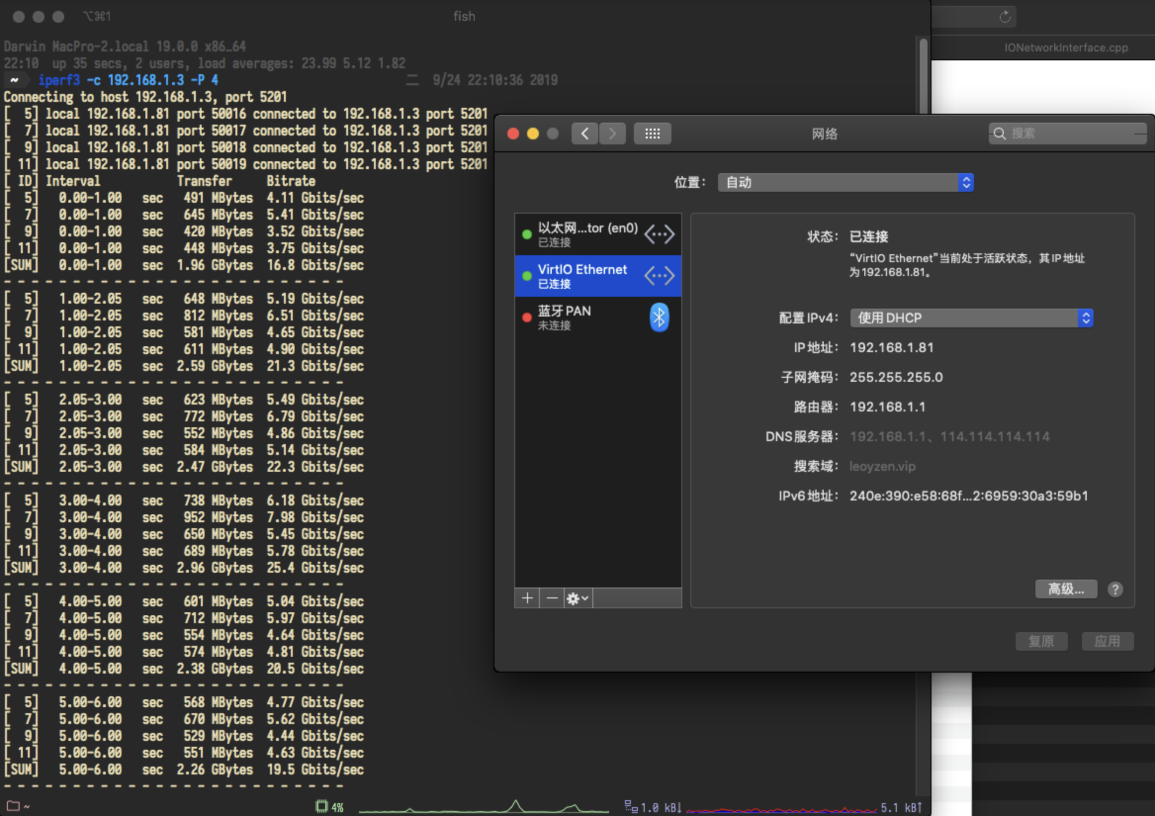

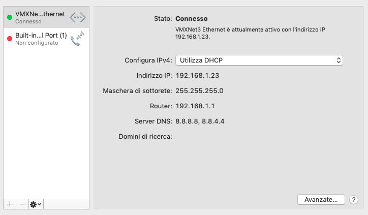

I've got VirtIO network work in Catalina and finally get 20Gb+/s network in Hackintosh VM, awesome!
Edit: but still unstable for daily use, it become buggy when reboot .... I should find a way to make it work.
Edited by Leoyzen

Sorry, but I'm reading 20k not 200k for the opencl (it should be 130-140k)! mmmm.....(Edit: seen now you changed to 22k, however it should be near 60k for the rx460)
Good to know for the virtIO network! Thank you, I will try to investigate more about these "issues".

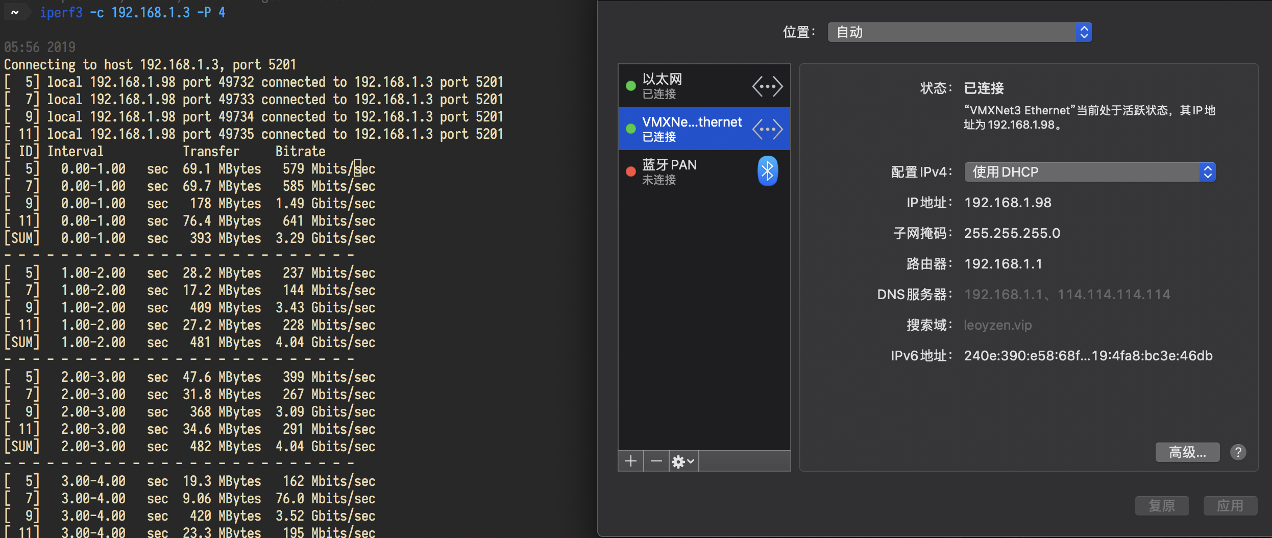

I found that it is clover which breaks vmxnet3 and virtio-net, maybe during clover devices initializing.
After hotplug the ethernet devices after clover initialization, I've got a much better throughput performance:
1. virtio-net works(works properly) and get 20Gb/s+ performance(before won't work, osx can't get correct mac address after clover handled the devices)
2. vmxnet3 works properly and get 4Gb/s+ performance (before only 100Mb/s+ and quiet buggy)
I will try to find the specific issues where the clover break. Maybe we are closed to get a much more efficient ethernet option which works property
Steps to make virtio-net work:
1. do not add virtio-net in vm xnl
2. boot vm, when in clover boot selection section, go to 3
3. [IMPORTANT] virsh attach-device --live Catalina /boot/config/ethernet-virtio.xml
4. [IMPORTANT] add clover boot args: keepsyms=1 debug=0x100
the ethernet-virtio.xml looks like this:
<interface type='bridge'>
  <mac address='52:54:00:d6:ac:37'/>
  <source bridge='br0.100'/>
  <model type='virtio'/>
</interface>

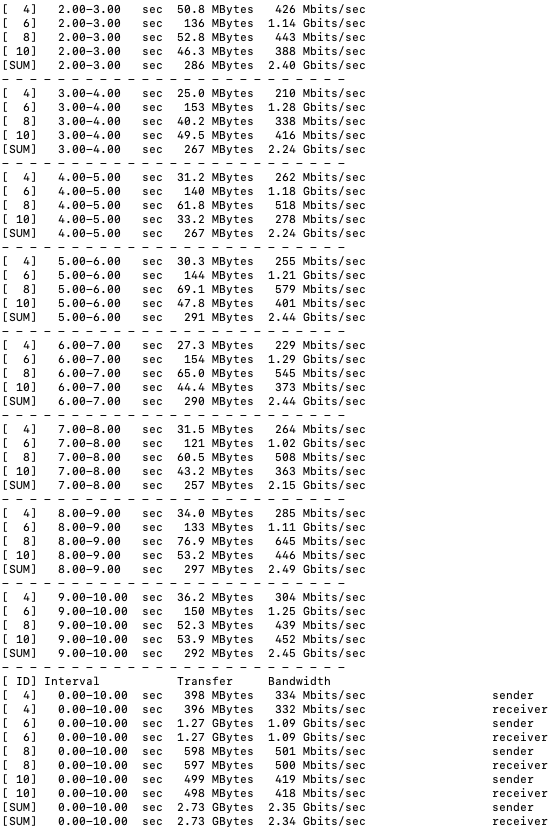

Not able to replicate with vmxnet3, I'm not getting 4Gb/s+ but 2Gb/s+ (for sure not 100Mb/s) (Clover 5091)
Do you have vmxnet3 as primary ethernet interface?
When I use vmxnet3 as primary ethernet interface then the iperf3 is much slower.....But with another interface then it turns to be correct.
Yes, vmxnet3 only
@ghost82
 That's strange....I will test more.
Edited by Leoyzen

* Catalina: MacPro7,1(which iMacPro1,1 not works for me it get reboot cyclely with "x86_topo_lock error")
* Mojave: iMacPro1,1
** It do not need any kext to make function work **

Here are some screen shots about my VM:
Geekbench 5 with 4 cores/ 8 threads of my 3700x:
