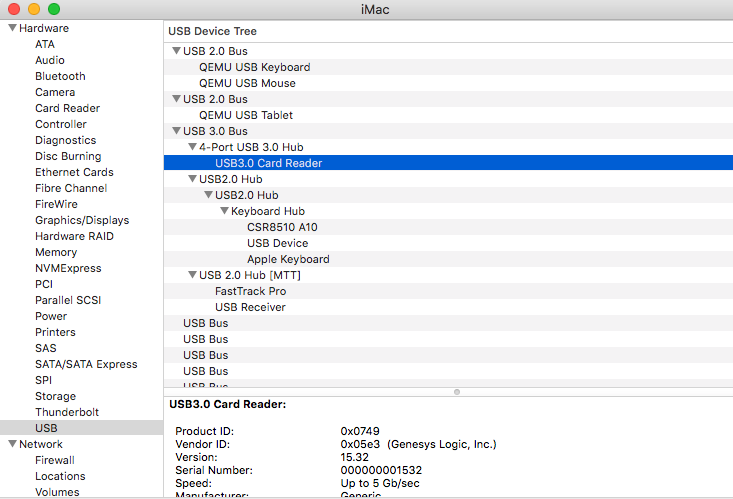

13 minutes ago, hygoggx said:
its showing 1 'USB2.0' Bus and 3 'USB' Bus, all of them listed using 'AppleUSBEHCIPCI' controller, if i attach any usb3 drives in the 'USB' ones, in the 'storage' section the drive is just listed using usb protocol, and have usb2 speed when im using it
need more info, where does it appear under the usb tree? can you post a screenshot similar to this:
do you have any other usb 3 devices you can try and see how they are listed? What are you using as your usb 3 device? what hubs are present if any? some hubs have 2.0 and 3.0 ports.
Sorry for my intrusion: are you passing through the usb controller or is it emulated? I tried several times to passthrough the usb controller and make it work on osx with some degree of success, but not satisfactory.
My mainboard is an asus z9pe-d8 ws with 2 ASMedia Technology Inc. ASM1042 SuperSpeed USB Host Controller: best result I was able to obtain was by installing the GenericUSBXHCI.kext, however it never showed up as a usb 3.0 controller and usb devices did not show at first time, I had to attach, detach and reattach again to make them show.
Edited by ghost82
USB card isolated from Unraid at boot which is passed to the vm. I fiddled with trying to isolate and use ports on different motherboards,  but they always seemed finicky and didn't always work reliably (though others have had great success I believe), or required more than what I wanted to deal with. And it was 10x easier to buy a 20 dollar card and pass it through.

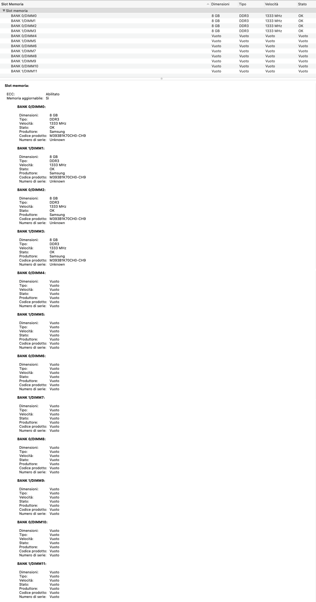

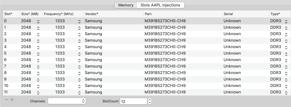

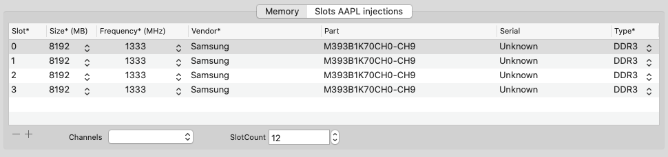

On 10/10/2019 at 8:20 AM, Leoyzen said:
No, we do not have much options to map memory slots.
I found out that it is possible to map the ram slots in clover: simply modify the Memory section under SMBIOS. For my system I chose 12 slots, according to the macPro7,1 mainboard. However catalina still reporting memory misconfiguration.
MacPro7,1 ram slots:
Clover configurator:
System information:
Edited by ghost82

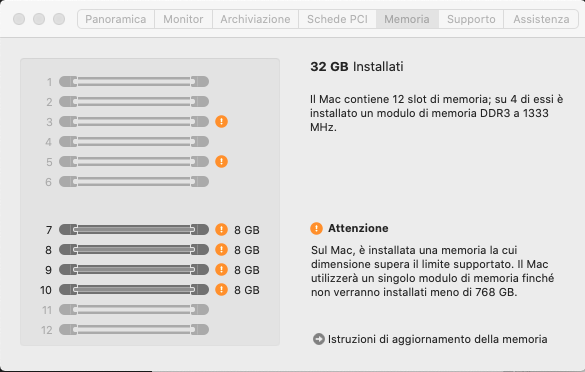

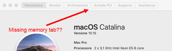

Just a quick question to people running Catalina with macpro7,1: I noticed that in "About this mac" I don't have the memory tab. Do you have it?
EDIT: I found that it depends on SMBIOS setting "Platform Feature": default setting 0x22 for MacPro7,1 prevents the memory tab from showing; changing it to 0x18 lets the memory tab appear (memory tab should appear since MacPro7,1 will not have inaccessible/soldered RAM..):
I cannot understand the warning, that keeps the "memory misconfiguration" popup appear at every start of the VM.
This is the translation: Mac contains 12 memory slots; 4 memory slots are populated by a DDR3 1333 MHz memory module.
Warning: On this Mac the installed memory exceeds the maximum supported limit. The Mac will use only a single module until less than 768 Gb of RAM will be installed.
However, the MAC is using all the 32 Gb installed (tested with diglloyd tools) --> A nonsense for me....
Edited by ghost82

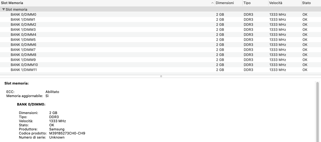

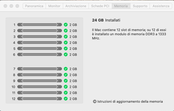

Memory misconfiguration problem solved!
Finally I mapped al the 12 slots and populated all of them with 2 Gb module each.
No more warnings and memory tab is ok.
PS: remember to assign the same amount of ram both in clover and unraid vm (xml) (the sum of modules set in Clover should reflect the amount of ram assigned to the vm).
Memory tab:
System profiler:
Clover memory configuration:
Edited by ghost82
