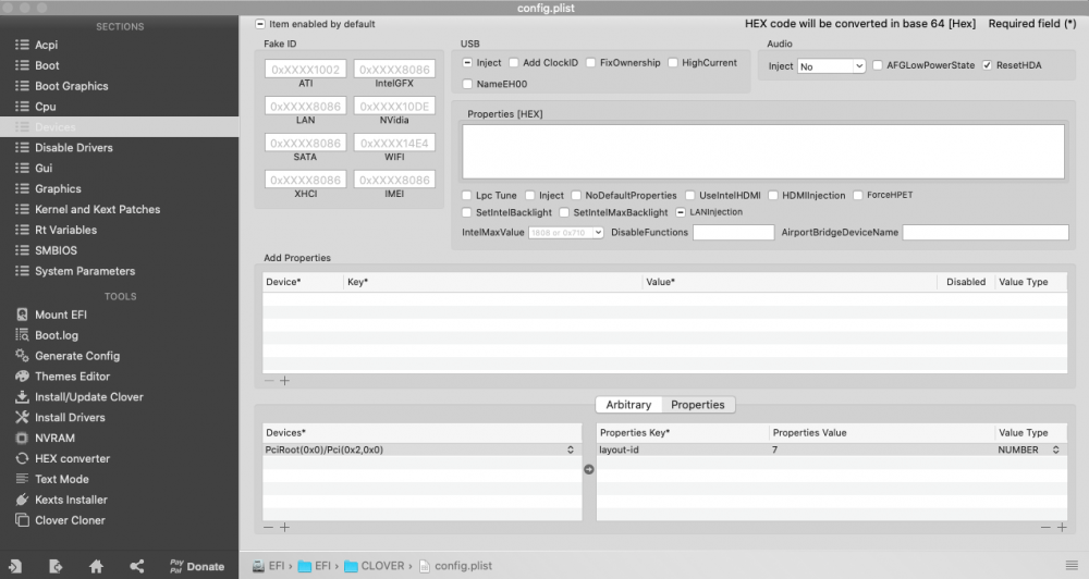

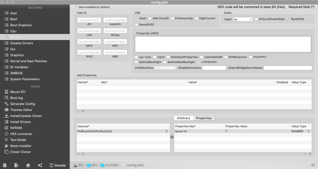

Try move the onboard audio from bus=x to bus=0 but slot=y.This will try to make the audio builtin.
People, we have a genius here, seriously.
It works! Moving the built-in audio to bus 0x00 and slot 0x02 finally makes AppleALC work.
So, resuming:
- AppleALC+Lilu kexts in CLOVER kexts Other folder
- built-in audio bus 0x00 and slot 0x0y (where y is a number different from 0)
- In clover config.plist: Devices --> Audio: Inject=No
- In clover config.plist: Devices --> Audio: check ResetHDA
- In clover config.plist: Devices --> Properties --> Devices: fill in with the proper address (use gfxutil with command gfxutil-1.79b-RELEASE/gfxutil -f HDEF)
- In clover config.plist: Devices --> Properties --> Add property key: layout-id, Property value: x (where x is a number reflecting the audio layout, see here for layouts for supported codecs: https://github.com/acidanthera/applealc/wiki/supported-codecs ) (my working layout is 7), Value type: NUMBER
- (Optional) In clover config.plist: Boot --> add boot arguments -liludbg and -alcdbg: this will work if you use the DEBUG kexts; when your system boots you can give this command in terminal to check for Lilu/AppleALC:
log show --predicate 'process == "kernel" AND (eventMessage CONTAINS "AppleALC" OR eventMessage CONTAINS "Lilu")' --style syslog --source
Unfortunately I cannot check for HDMI audio of my GPU as I don't have a hdmi cable, but from the attached log it seems ok (HDAU).

As pointed out by Leoyzen, gpu and gpu audio must be in same bus (in this case 0x03) and different function (0x0 for gpu, 0x1 for gpu audio).
Built-in audio (passed through):
      <driver name='vfio'/>
      <source>
        <address domain='0x0000' bus='0x00' slot='0x1b' function='0x0'/>
      </source>
      <alias name='hostdev2'/>
    </hostdev>
Built-in audio in bus 0x00.
Siri is working ok.
Clover settings for built-in audio
I'm saving the VoodooHDA as a second option for the audio and use AppleALC.
DP is with audio,it should work too.
@Leoyzen May I ask you, what was the input to make me change the bus of the built-in audio?
According to the code, Lilu will try to find audio device.There are two type of audio:
1.audio with grahpic(indentified by v.video)
2.audio builtin onboard(assigned to variable audioBuiltinAnalog)
And Lilu set audio as onboard builtin (audioBuiltinAnalog) only when meet two condition:
  1. the audio is in pci-root (not pci-bridge), this is why I sugguest to set audio to bux=0 and slot=y
  2. the audio is in pci-bridge, but there is no video under the same bus. This is why I said u make the graphic audio incorrectlly because it will be marked onboard audio
If you set graphics audio incorrect, Lilu will not find the video with the audio, then it assigned it to audioBuiltinAnalog; when it meet the true builtin audio, the audioBuiltinAnalog is already occupied by grahpics audio, so it will not recognize the correct onboard audio device.
Yes, just to point out that my xml config was wrong. I checked some weeks ago and it seemed to me that it was ok, maybe I was tired, because it wasn't set at all according to your instructions.

If you don't have xcode or you are not able to compile them you can download the attached kexts I compiled.
These are compiled right now at the time of writing (29 October 2019 - 15:12 GMT)
When lilu works with kvm (v. 1.3.9) you should not need anymore any patch in clover for your video card.
WhateverGreen-unoff-1.3.4.kext.zip Lilu.kext-unoff-1.3.9.zip
