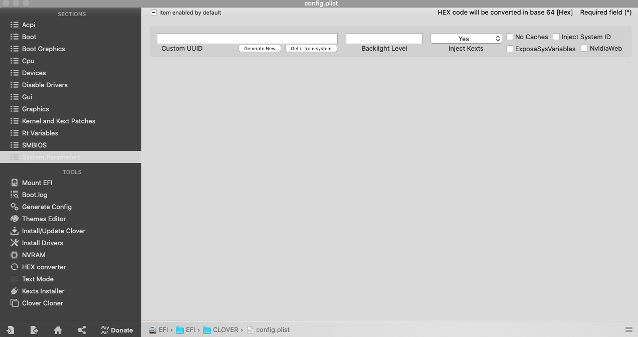

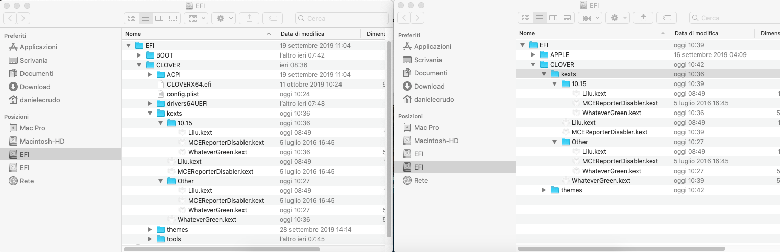

My clover version is the latest (5096), my vm load first clover.qcow2, then disk3.img, where there is the mac os: so clover is not on the same partition of the mac os (Edit: also tried on the same partition, vm with only disk3.img, same unsuccesful result).
What I tried, without success:
- I copied also the kexts in EFI/CLOVER/kexts (clover.qcow2 disk)
- I copied also the kexts in EFI/CLOVER/kexts/10.15 (clover.qcow2 disk)
- I copied also the kexts in EFI/CLOVER/kexts (EFI partition of disk3.img disk)
- I copied also the kexts in EFI/CLOVER/kexts/Other (EFI partition of disk3.img disk)
- I copied also the kexts in EFI/CLOVER/kexts/10.15 (EFI partition of disk3.img disk)
Here is the structure of the EFI folders:
Here is the clover configurator (Inject kexts=yes)
Obviously, Lilu/WEG and MCEReporterDisabler work in /Library/Extensions.
Now that I can use Lilu/WEG and since Lilu/WEG should work also for recovery/installation I'd want to be able to inject these kexts through clover.
What am I missing and what can I try?
Edited by ghost82

@ghost82According to the log everything works fine.
You should know that kext inject to the "cache" not the origin "kext", so when you made some change it is safe to "rebuild kernel/kext cache" before reboot.
Yes, I always rebuild the cache with kext utility before a restart.

I found the solution!
Apparently the problem was with the MCEReporterDisabler.kext found also in this thread: I don't know why but it doesn't work anymore, at least with my catalina 19A602.
Solution is to replace MCEReporterDisabler.kext with AppleMCEReporterDisabler.kext (attached to this post).
This kext is very similar to MCEReporterDisabler.kext and it was released 8 days ago by naveenkrdy on github: see here for reference: https://github.com/acidanthera/bugtracker/issues/424
I can now inject all kexts with clover, boot into recovery with primary display ok

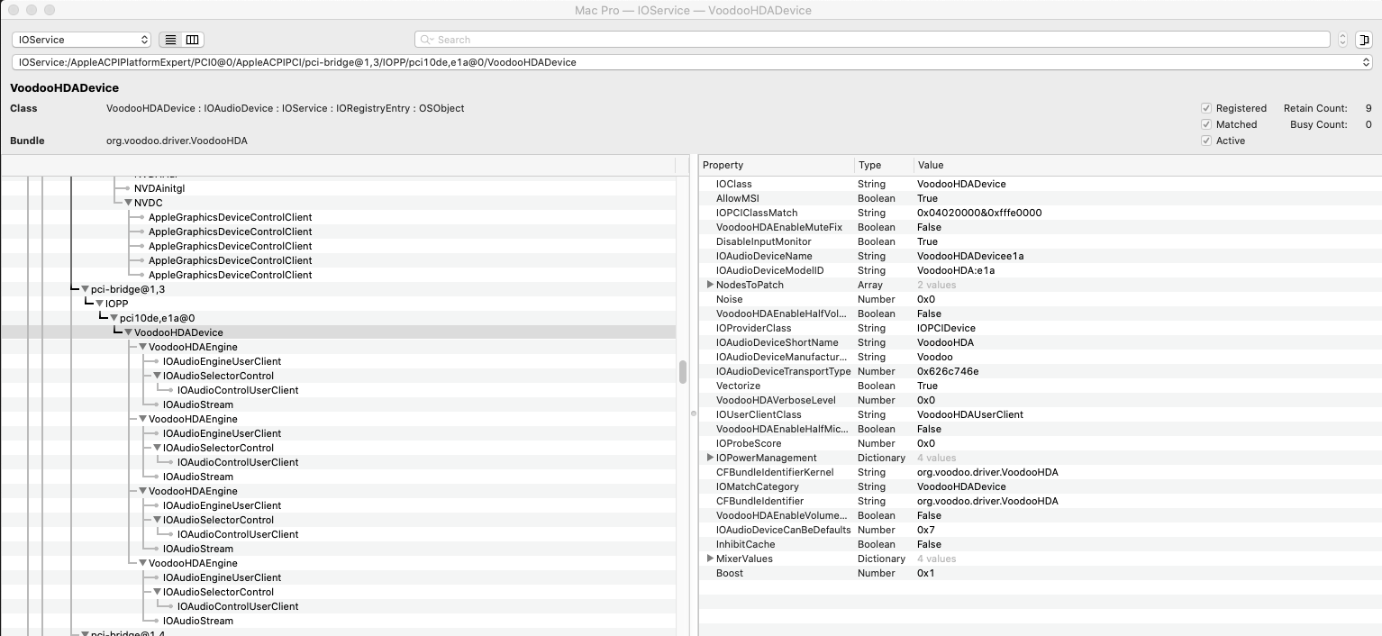

Anyone had success with AppleALC? I'm currently using VoodooHDA for the audio: it works quite ok, I have sound from the speakers, external microphone and webcam microphone recognized, however Siri is not working (it keeps repeating sorry, can you repeat?).
Microphone is working with other apps, such as quicktime and skype.
With Mojave I was able to make Siri to work with VoodooHDA, then after uninstalling it to try AppleALC Siri doesn't work anymore; I don't know how VoodooHDA worked with Siri, I just noticed that the list on the preference panel -> audio was changed a bit (listing the same audio ports but with different names if I remember well) and Siri worked; then, the names in the list changed again, but it continued to work with Siri.

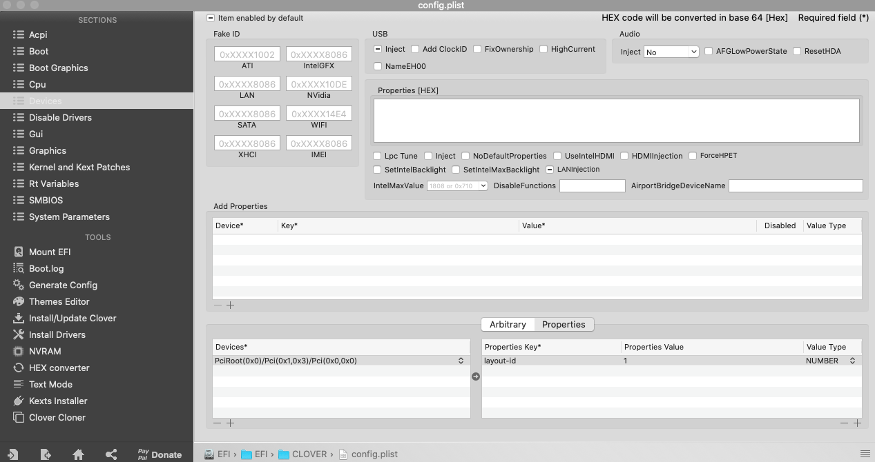

I'd want to try with AppleALC but I'm stuck: I have the audio passthrough (0x80861D20):
I tried AppleALC injection with clover with different layout id injected from devices -> properties or with boot argument alcid=numberOfTheLayout without success.

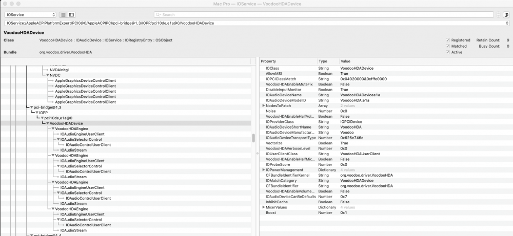

One thing I noticed is that in ioreg the VoodooHDA is not listed under HDEF: maybe a problem similar to Lilu before adding the proper vendor id to the code, or is it ok?
Edit: from insanelymac:
"These are what they appear to be the currently Intel pci-ids supported by AppleHDAController:
8086:1D20   Name: C600/X79 series chipset High Definition Audio Controller (Patsburg)"
Shouldn't just work out of the box?
Edited by ghost82

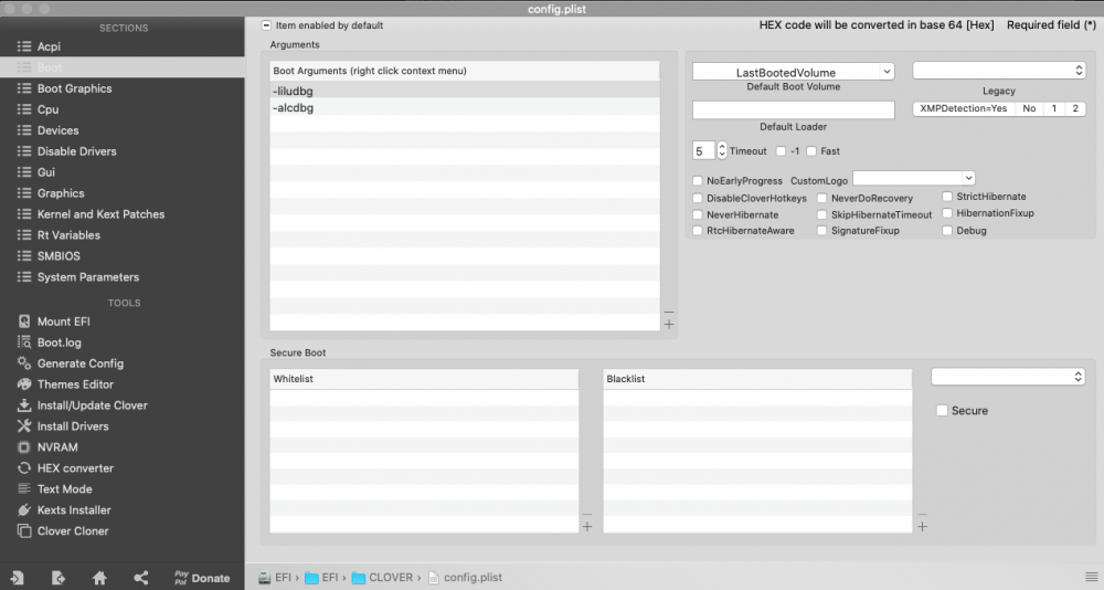

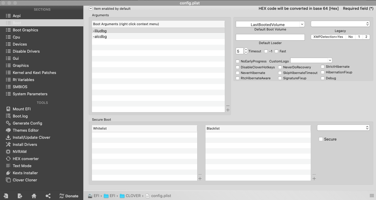

@ghost82 That quite likely.
Post you log witb -liludbg and -alcdbg.

@ghost82 AppleALC correctly found the audio device according to your log.
You should set Audio layoutid and select "ResetHDA" and test again.
@ghost82 Yes, you can find your vendor or others who have the same board to find the specific layoutid first.
Edited by Leoyzen

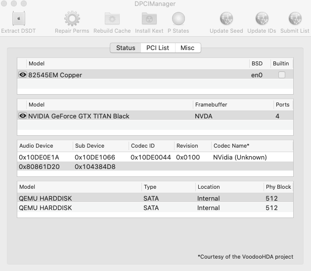

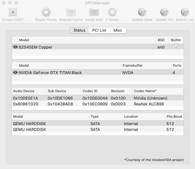

I tried all the layouts for ALC898: 1, 2, 3, 5, 7, 11, 13, 28, 65, 66, 78, 99, 101: no luck.. :(
When you say that AppleALC correctly found a device are you refering to this?

Because this is the Nvidia audio, which I'm not interested in at this time.
Lilu is able to find the other audio device:
2019-10-17 18:02:38.411240+0200  localhost kernel[0]: (Lilu) Lilu:     dev @ (DBG) found pci8086,1d20 on pci bridge
2019-10-17 18:02:38.411243+0200  localhost kernel[0]: (Lilu) Lilu:   iokit @ (DBG) getOSData vendor-id has 8086 value
2019-10-17 18:02:38.411247+0200  localhost kernel[0]: (Lilu) Lilu:   iokit @ (DBG) getOSData class-code has 40300 value
2019-10-17 18:02:38.411250+0200  localhost kernel[0]: (Lilu) Lilu:     dev @ (DBG) found audio device pci8086,1d20 at pci-bridge by 8086
But no traces of AppleALC doing something with it.
Also strange that DPCIManager doesn't list any codec name for 0x80861D20..?
And more strange, after all these tests I put again my VoodooHDA.kext and Siri now works...mmmm
Codec name now ok with VoodooHDA:
Edited by ghost82

Trying to understand why the onboard audio is not marked...
Edited by ghost82
